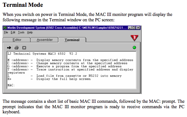

If you can dump the EPROM I'd be dead keen to try it in the board I have. I have powered it up and got a red light but nothing else.
I have got some documentation from the original supplier including manuals, and so far as I can find out it should come up and say 'Ready' on the display. I've got it mounted on the wall as an ornament / conversation piece, but the plan would be to have a battery pack in the frame so it would actually work in situ.

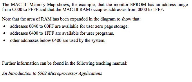

The most useful bit is probably the user manual, you have got in effect the complete system with the applications module too which is very nice. The monitor includes some routines which run on the applications module, and the details for that are in the manual.
James
Posts: 11467
Re: Digiac 2000 MAC-III 6502 trainer
Very nice - we get a memory map! (And, surprisingly, a 2005 date)
