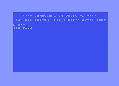

A challenge was recently organised on facebook.
The aim was to create a short BASIC program displaying an ASCII code progressively on the screen, following the shape of a spiral which starts at the centre of the screen. The challenge was opened to all computers.
I wrote a code in assembly for the Commodore 64. Whilst writing it, I figured out that it could be used actually on any computer based on the 6502 processor. It just needed some ajustments for the screen memory adresses and # of rows. The final shape of the spiral on the screen is a perfect square (25 x 25 on the Commodore 64, 25 being the # of rows).
It takes around 20,000 cycles. It's based on 4 subroutines (each computing the positions on the left, right, up and bottom) with ADC and SBC running in a loop, and self-modifying code. Nothing exceptional nor fantastic.
While writing it, I thought that a similar challenge could be organised just for the fun of sharing knowlege and practices. Anyone interested?

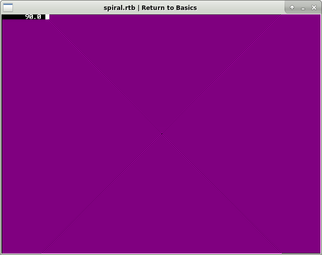

But how can a spiral turn into a square?
Or do you mean like a turtle graphics spiral, turning 90° and increasing the side length by 1 every turn?
Like this, but with ASCII "graphics":

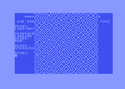

Re: Displaying an ASCII spiral in 6502
The FINAL shape of the spiral is a square when the drawing has finished.
But each ASCII output during the drawing on the screen is performed as a rotation (left or right)
Here's how the final shape looks like with 205/206 PETSCII codes.
OK, so it's a spiral fill pattern, printing whatever (but the usual diagonal "maze" happens to look good)
By spiral fill I mean something like
