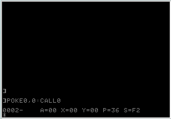

Almost all extant 6502 machine code monitors refer to the status register as SR in the register dump display—also, the stack pointer is referred to as SP. Take a look at the first attachment, which is the January/February 1980 issue of Transactor magazine. In it is an article about Supermon for the Commodore PET. On page 17, the .R (register display) command is described, complete with an example of what a register dump looks like. You’ll have to rotate the page view clockwise.
The second attachment is an excerpt from the January 1983 issue of Compute, in which there was an article about Supermon 64. If you scroll down, you will see how the register dump appears.
Supermon had a number of contributors to its design, Steve Wozniak indirectly being one of them. Jim Butterfield was the one who took the bits and pieces and created the actual Supermon package that was used by innumerable Commodore M/L programmers. He then ported it to the C-64. Commodore, in turn, ported it to the C-128. I got a lot of use from the C-128’s monitor (and the C-128's reset button) when I wrote the truck leasing and billing system. :D

Indeed, Supermon is an example of one particular notation. And the mnemonics we all use constitute another example. Including the REP and SEP which motivate this thread. (Oh, also the datasheet, and Zaks, and Leventhal...)

It would be nice if all the terminology were consistent; but alas, we even have BBR (branch on bit reset), RMB (reset memory bit), REP (reset processor status bit), but BCC (branch on carry clear, not branch on carry reset), BVC (branch on overflow clear, not reset), CLD (clear, not reset, decimal flag), etc.. I tend to prefer the one-letter designators so the length is consistent, like A, X, Y, S, and P (without leading dots which make left-justify look messy), but then 816's K and B are extra confusing, and then there's ADH (address high byte), ADL, and probably more I'm forgetting. I/O ICs may add confusion too, like SR being the VIA's shift register. I've never used a monitor program. I wonder if they differ as much from one to another as assemblers do in their directives. Fortunately it doesn't take much work to modify code written for one assembler to work on another. I'm sure I could find better things to get myself worked up about.

FWIW, I recently changed the monitor in my JRC-1 board to use single-letter designations for all the registers that the monitor lets you modify before jumping into code, so "A", "X", "Y", "P", "S", "D", and "B". Previously "P" was "SR'", "S" was "SP", and "B" was "DB". I found I liked it better making everything one letter. It makes my command line parsing a bit easier, and as has been mentioned above, these letters match the ones used in the opcodes (except for those few opcodes that use "C" to refer unambiguously to the 16-bit accumulator, of course).
