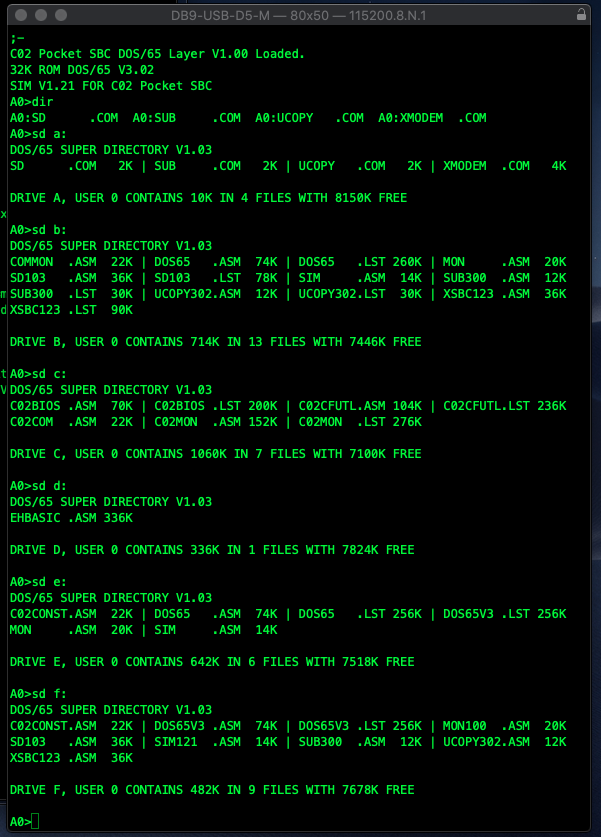

I decided to start a new post for this. In short, I've been swapping some emails with Richard Leary (DOS/65 author) since end of last year. As I recently finished the BIOS for a RTC/CF-Card adapter (which plugs into my C02 Pocket SBC), I connected again with Richard about a week ago. He sent me his current ROM version of DOS/65, which can be assembled and linked with WDC Tools. The version he has been working on recently, supports a SD Card (based on Andre' Fachat's design) and connected via a 6522 to either WDC's W65C02SXB or Daryl's SBC2.
I needed to write an interface layer as a bridge to my BIOS and Monitor, so I had done that earlier this year. I quickly ported the core routines over to the included Monitor source file and replaced the routines for the console and disk access (from SD to CF) and had DOS/65 working in less than 2 hours. I've since rewritten the interface layer and made a few changes to Richard's default configuration. I've also modified the SIM code a small amount. I've reduced the ROM image by over 3KB and was able to free up enough RAM usage to add two more drives, for a total of 6 (drives A - F, all 8MB in size). The top 4KB of RAM ($7000 - $7FFF) is used for pointers and variables for the ROM based CCM, PEM and SIM modules. The allocation maps for each drive and the host buffer are also located in this range. Each allocation map plus the host buffer is 512 bytes, so the entire 4KB is used. With the TEA configured at $0800, the leaves 26KB of free memory. ROM usage is 8KB allocated for my BIOS, Monitor and I/O page. The full DOS/65 ROM code plus the RAM image is 7KB. This leaves 17KB of free ROM space.
So far, I've got this running on 3- C02 Pocket SBC systems (base SBC and the RTC/CF-Card adapter). I'll continue to do some additional testing, but have already assembled, linked and downloaded the core utilities, which include: SD (super directory), SUBMIT, XMODEM and UCOPY. So far, everything is working very well. Here's a couple screen-shots... granted, nothing that hasn't been seen before, as it's basically CP/M on the 6502 :D

There's an older release on the web, but Richard has newer versions running which are bootable from media as well... diskette, IDE (CF) and perhaps some older gear. He does give his code to anyone for personal use, complete with source (GPL license). I might have the non-ROM version as well. I'll email you with some additional info.
I'm pretty happy with the code... I re-wrote my Monitor interface Layer, so it's about 440 bytes. On a larger RAM system, I think you could easily have ~52KB available, depending on how many drives attached and your hardware routines that interface to SIM. This does use CP/M formatted drives... so as long as you can access them, DOS/65 will read/write them. Of course, it won't execute those binaries.
