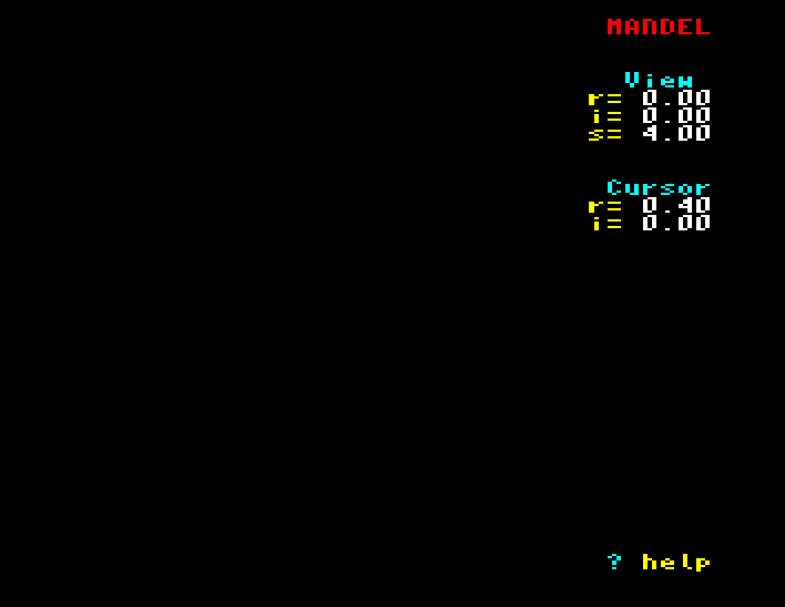

There's a very interesting conversation going on over on Stardot as ever more performance is squeezed out of a Mandelbrot explorer. Initially with 8-bit fixed point and eventually with 13-bit fixed point, eventually the program ends up just as fast but with no artefacts and more zoom capability. A Mandelbrot in 12 seconds is a lot better than we're used to on a 6502 platform from the 1980s!

Here's an animated image of the 12 second Mandelbrot (ahem, an 18 second version):
