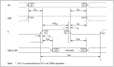

Ok guys. I am able to write to a 44780 LCD module using a 65C22S VIA without issues. One thing that bothers me is that I'm having to write a delay routine which simply spams NOP commands between each write as LCD is not fast enough unless I run my PHI2 at 2MHz or below.
To address this I was going to use a timer, but as Garth has pointed out elsewhere I should be using the LCD's busy flag.
As such, I've tried writing some code to do this, but so far not got very far.
Here's my efforts so far:
NOTES:
- I know I should be using ORA and AND to flip selective bits rather than writing whole values, but it's easier to see what's going on when writing entire values. Will correct when I get the code right
- VIA_DDRA refers to the data direction register for port A of the VIA. This has been tested and works
- VIA_outA refers to the IRA/ORA register for the VIA. Again, it has been tested and works.
- The LCD is in 4 bit mode when this code is called
- Writing to the LCD works fine using the delay routine (delay40) which uses NOPs to delay the 65C02
- If the delay40 calls in the write character to LCD routine are replaced by calls to this code then the CPU never exits the busy flag checking loop in this code
# PA0-3 = LCD DB4 to DB7
# PA4 = E
# PA5 = R/W  0=ok for next op, 1=LCD is busy
# PA6 = RS 0=command, 1=data
# PA7 = not connected

Re: LCD busy flag
Post by Hobbit1972 »
banedon wrote:
	# set LCD DB7 (port A pin 3) to input on the VIA port A pin 5 = 0 (1=output, 0=input)
	LDA #%11010000
	STA VIA_DDRA
By this you fix R/W as it was previously probably 0=Write?

OK I'm thinking that not only do I have to send two sets of four bits for the command, I then have to read the two sets of 4 bits back with the first set containing DB7 as it is the MSB. Also (and as I originally thought) each section of the command is executed by a falling edge of E. I.e. E must be high and then go low. I'd misremembered which way around this was in the year since I last looked at this stuff.
[edit] I missed what Hobbit1972 was getting at. I had set the pin direction for the r/w pin on the VIA to input when it should be output. I've corrected that.
Posts: 8774
Re: LCD busy flag
If you read it, there's no command necessary except that the RS bit tells it what to read back to you, and the R/W bit tells it that you do want to read.

New code. Seems to be working with PHI2 at 8MHz:
[edit] But not working at 10MHz :(. Code is running as my Bus Monitor shows code executing at the end of the test code segment, but althought the LCD screen looks like it has initialised (all 4 lines available instead of two ok and two not) no characters appear.
Maybe I do need those delays. As such, it sort of makes using the bust flag in 4 bit mode a bit useless lol. More testing ahead.

I do not think it is valid to read data after the enable pulse has ended. The data hold time of a HD44780 is specified as 5 ns. Whatever you read 4 cycles later is hi-z and it will be coincidence wether the busy flag still shows correctly (static).
You need to set enable, wait for 160 ns (for which the LDA abs cycles until the input is gated may be enough already), then read the busy flag, then drop enable.

Hmm so I *do* need a timer if PHI2 various/is not set.
[update] Got it working at 10MHz. The issue was caused by the routine that sends commands/data to the LCD still using the old delay40 routine. I replaced the call to delay40 routine with one calling my new BF check.
I still need to test this at 16MHz (max clock my 65C02 GPD design runs at), but don't currently have a 32MHz oscllator can (the 32 is divided by 2 using a D type flipflop to give better rise & fall times). Got an AEL one on order from ebay. If things are still ok at that speed then I'll declare victory on that and start looking trying to implement I2C. To that end, I'll have a reread of Garth's primer.

Be sure to leave E down after every read or write, and only change the RS and R/W bits when E is down, and never at the same time with raising or lowering E.

Didn't you want PHA and PLA instead of PHP and PLP here? I think you want the high nybble which is read first; but as shown, the next LDA permanently overwrites it. You've saved and restored the status, but then the BIT instruction below overwrites that status before it can get used. I think you wanted to save the accumulator, not the status.
