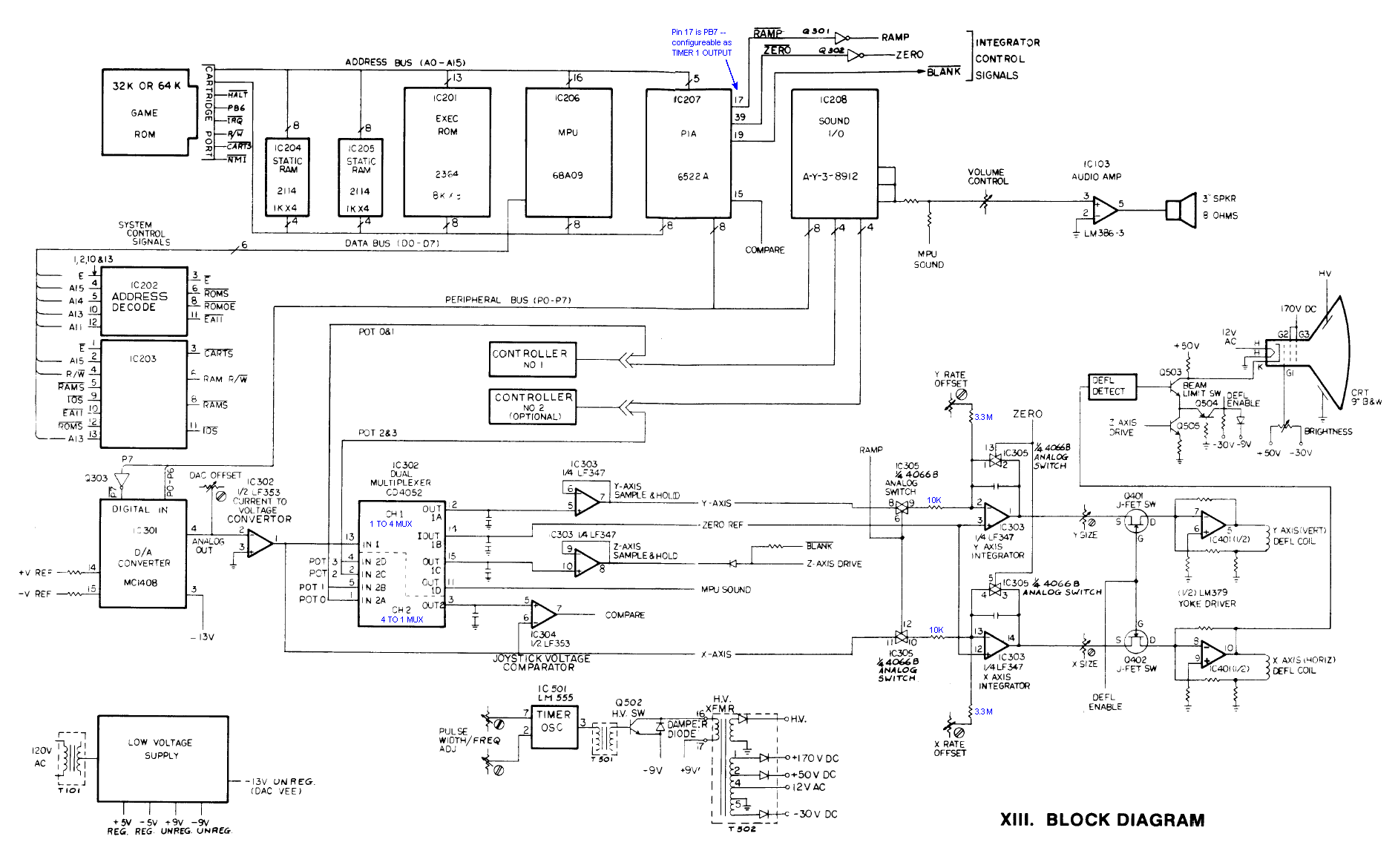

Thanks to the link Ed provided, I've been able to examine the Vectrex ramp-generation circuits, which I find to be delightfully sparse and elegant. Here is the Block Diagram (stitched together and annotated from pages of the pdf file):
This brings me back to my original supposition that, at the lowest level, the interface to the Vectrex accepts an X and a Y speed command from the CPU for each move of the dot (ie, the CRT's electron beam). In my previous post I assumed the Vectrex used coordinate-based commands, as apparently used by Cinematronics; I've since edited that post.
Referring to the Block Diagram, the signal ZERO can be used to discharge the integrator capacitors, returning the dot to 0,0 (screen center) and thus providing an initial reference. Except for this "calibration," the dot travels point-to-point in a series of relative motions. For each individual motion, a Y value from the DAC is latched into the Y Sample & Hold, after which the (unlatched) X value is written to the DAC. Then the CPU triggers timer 1 of the 6522 VIA, thus asserting the RAMP signal. For a controlled time interval, the integrators slew positive or negative at a rate proportional to the respective signed values of X and Y. At the end of the interval the dot freezes indefinitely; the integrator cap's "remember" the dot position until the next motion commences. (However, the calibration step would need to be repeated occasionally.)
Finn wrote:
the slower you move the beam the brighter or thicker the line, because it dwells longer on the screen.
Yes, exactly. But also: it is the X and Y speeds which, relative to one another, determine the direction (slope) for the line that's drawn. The line length is determined by speed and by the time interval. (At least that's how I see it; comments & corrections on any of this are welcome.)
I dont know the exact hardware details because i am using BIOS functions to move the beam.
That totally makes sense -- for what you're doing you need to direct your attention to the BIOS calls. Others (like me) can't rest until they've grokked the hardware interface. :D
cheers

Thanks for putting that diagram together! There are some official and unofficial docs here:
http://www.playvectrex.com/designit_f.htm

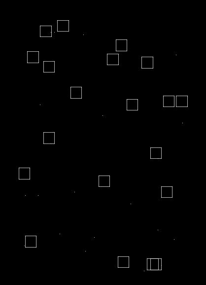

Thanks to everyone who helped me in this thread. I have finally written my first Vectrex Program now. It bounces 20 squares and 20 dots around the screen. Since I am new to all this it took me a while to actually understand what I was doing, and i had to overcome quite a lot of problems, but I got there in the end
Here is a screen shot (running in an emulator)
and you can see it running in an emulator here
http://www.youtube.com/watch?v=5fyrwUIIZqU
I tried to record the best quality video i could but my video-recording software didn't really like the line graphics (it looks like the screen shot normally - not all shimmery like it does in the video) or the flashing text at the start . Also normally it runs totally smoothly but having the video-recording software running slowed it down a bit.
I havent optimised or looked for duplication in the program yet (I'm sure there is some appalling programming in here, also Xman,Yman,Xv,Yv are no longer used) I was more concerned with actually getting it to run but here is the source code in case anyone else wants an easy way in to making Vectrex programs. The print routine was used for debugging, but not in the actual program
(this program is laid-out fine in notepad and here, but some lines move out of aligment when i actually publish the post. sorry)

PostPosted: Wed Jan 16, 2013 6:29 pm
Posts: 10938
Great! Always good to see a "Hello World" program, although in this case it's all boxes...
PostPosted: Thu Jan 17, 2013 8:52 pm
Joined: Mon Nov 05, 2012 4:40 pm
Posts: 11
thank you BigEd :) Don't forget the dots, those boxes get all the attention...
