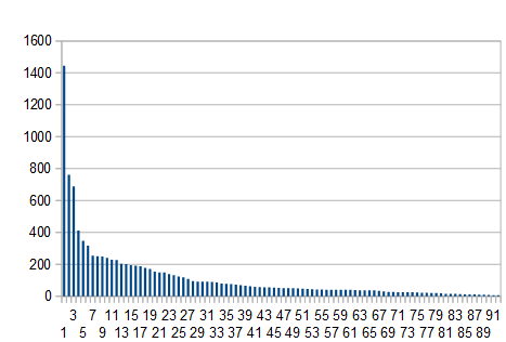

For an interesting record, here is the visualisation of the routine's size (the largest one, at the left, is the main program).
We observe that by reducing the size of only a few parts (the main program and other routines close to it "high level in the call stack") we could reduce code size dratiscally. This is also, for the most, part the less time critical routines.
Because they do a lot of boring stuff like initializing variables and call functions (sometimes with more than 3 arguments so they have to be copied to zero-page), they tend to eat a lot of space.
Uh huh. Lots of repeated operations, hmm? Same code, different data? Perhaps it might be worthwhile to step back a bit and ask yourself if there's a way to generalize what you're doing to the point of "one code for all data".
F'rinstance, why does every routine with more than three arguments have to copy data to zero page? How about making the callee, not the caller, do the copying? Speed's not an issue at this point, I understand.
