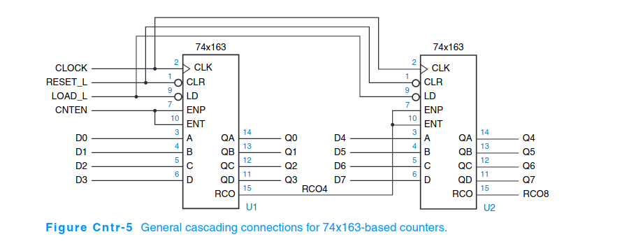

Re: VGA and Dual Port RAM
Alright, I got a question. Not sure if I should put this on a separate topic or not, though it is a small question:
https://assets.nexperia.com/documents/d ... HCT163.pdf
I'm looking to chain/ripple multiple 74HC163's together. If figured just connect chip #1 TC to chip #2 CP, while keeping CET high. Is this wrong?
This datasheet (and all others I've found) is saying that TC goes high when we are at a count of 15. That is, TC upticks on 15.

Am I correct in what's going on here? The bigger question: How do I chain these '163 chips together? Do I have to use CET in a way I'm misunderstanding?
Arg, I should have went with the '193 counters, I've used those before. Anyways, thanks everyone.
Chad
EDIT:
I think I found something useful while searching the internet for '163 examples. Attached is a picture. Weird setup in my opinion. I guess I'm just used to '193.
