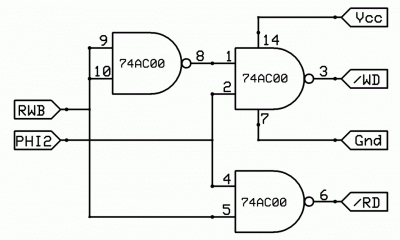

wDavies wrote:
I've Begun Working on A Project with the 6502 and hope to create a working computer...
Could you please post the schematic in monochrome.
As for a read/write circuit, here is what I use. It works for any asynchronous hardware that has separate /RD and /WD inputs. Note that this circuit is not to be used with any 65xx peripheral hardware.
File comment: Read/Write Qualified with Ø2
