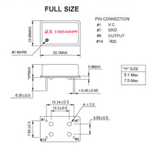

I have an old Rockwell chip with label "R6502-13" that i'd like to do the "Free Run" test. I'm guessing it's an NMOS chip?
I've read the 6502 Primer: Clock Generation but I do not have the parts yet as mentioned for the NMOS chip. What I have is this 4pin crystal. Will this work?

Yes. Not only will that work, it's the preferred method.
And yes, I believe that is an old NMOS chip which has a minimum frequency to run (IIRC, something like 100KHz).
A modern WDC 65C02 would be better but the NMOS version can certainly be used (assuming it works).

Ok thanks. So the output of the crystal goes directly to the 6502's pin 37, correct?

As cbmeeks said, the oscillator can you have is the preferred method. That's not just a crystal. I just now edited that page of the 6502 primer to clarify that. A crystal by itself will not oscillate, any more than a bell just sitting there will ring if it's not being struck. It has to have the other circuit components around it to produce a signal. The oscillator can has the entire circuit to do that.

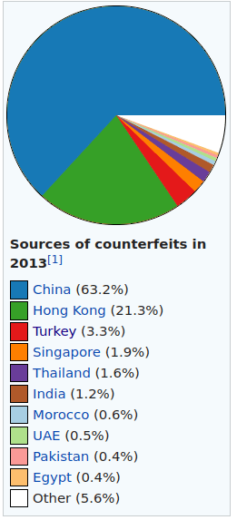

Like barrym95838, I doubt Rockwell was making any 65xx parts in 2011 (which the date code on yours says). I'm all the more sure they weren't making any NMOS 6502's anymore by then, so you definitely have a counterfeit there. There's quite a counterfeiting industry in China, with such parts showing up on eBay all the time. They pull parts out of old circuit boards, clean them up, sand the tops, and re-mark them. See https://www.youtube.com/watch?v=5vN_7NJ4qYA . I don't know why they don't just put the same markings back on, or just leave the markings alone. According to this pie chart from Wikipedia, China produces nearly twice as many counterfeit products as all other countries combined:
Anyway, it's best to just buy from authorized distributors. We try to keep our sticky topic "65xx parts sources" up to date.
