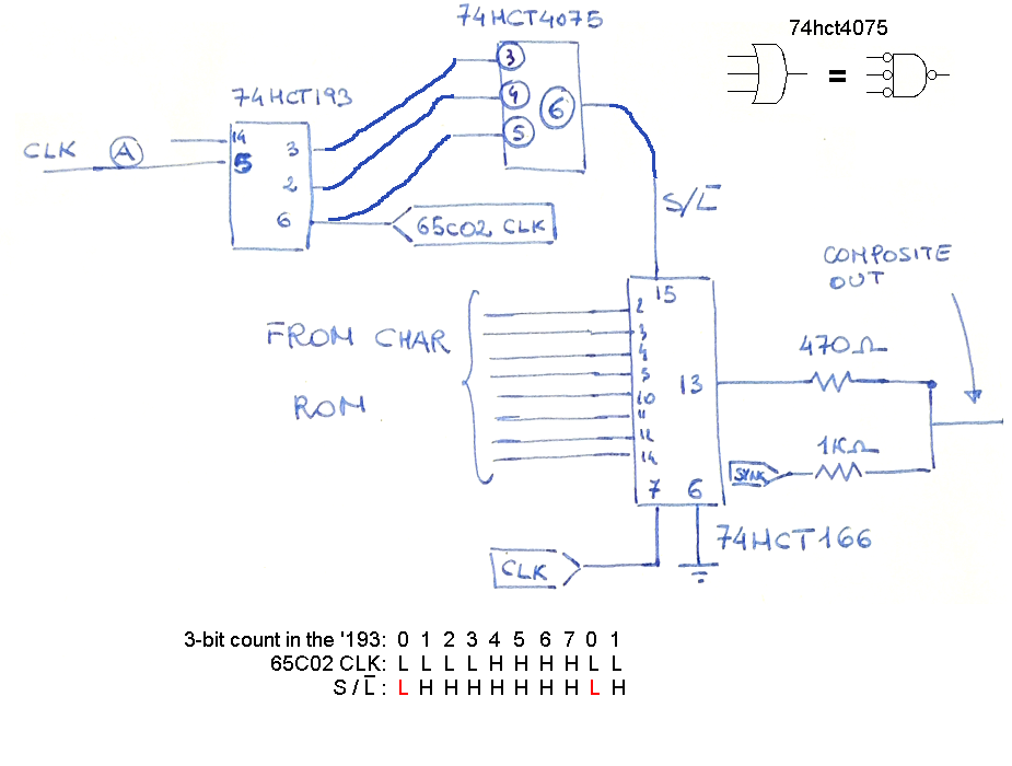

Hello everyone!
I really need some help to understand if I'm on the right path.
I would like to add a text only, monochrome composite video out to my simple 6502 computer. I would like to achieve it using only logic and memory and no dedicated microcontrollers, because I would like to learn and understand the hardware design required to achieve it.

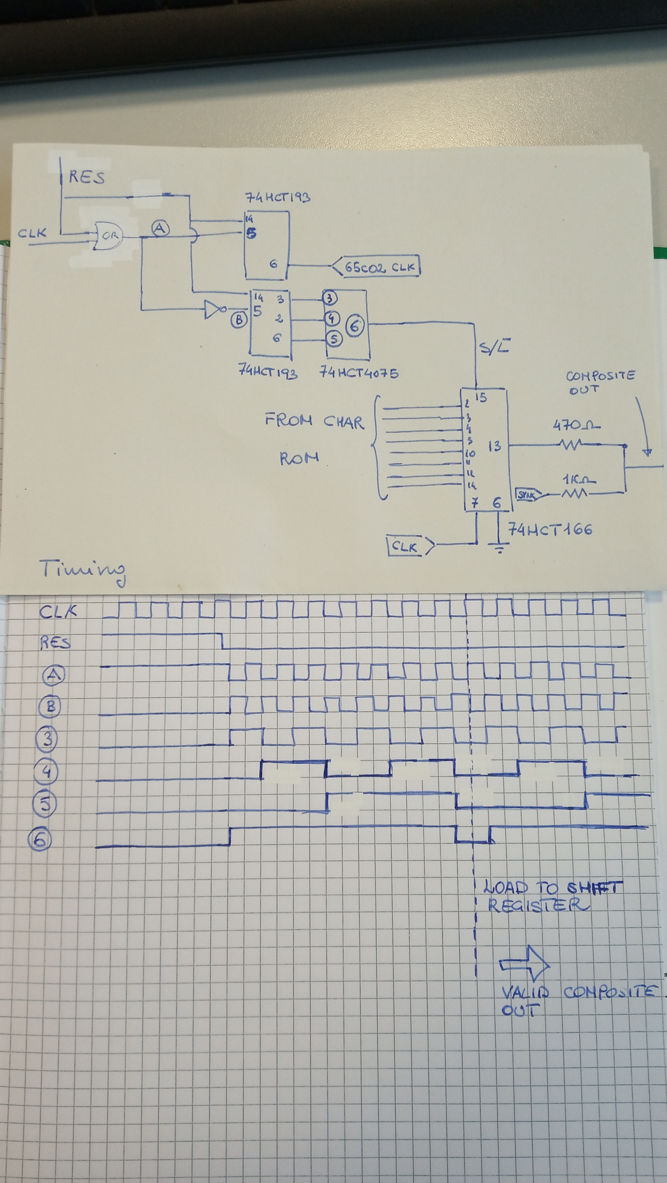

Currently, my idea is shown in the scheme below. The composite signal would be generated by a 74HC(T)166 PISO shift register using a 8MHz clock signal. The clock would be divided by 8 by a binary counter to provide a 1MHz clock for the 65c02. The video data would be fed by a char ROM.
It is my understanding that to provide a constant feed of serialized data from the shift register I must provide an active low LOAD signal to the 74166 during the first low-to-high edge of the 8 clock cycles used to send out every byte of video data coming from the char ROM.
To generate such LOAD signal, I thought about this system:
An inverted clock signal is fed to a second counter. The three least significant bits of the counter are ORed to provide the LOAD signal shown in the timing diagram (signal 6). The active high RES(ET) signal is ORed with the input clock, so that the second counter, using the B clock input, starts first ensuring that the LOAD signal is low during the first low-to-high edge of the clock, and not the second.
Naturally, the video output of the shift register would be mixed with a SYNC signal to provide the necessary composite syncronization.
Does my idea make any sense? Is there any simpler way to achieve this?
Pardon me if I wrote some horrible mistake, I'm completely selft taught in the field of electronics apart for some rudimentary electrical engineering classes during college! :oops:
Thank you!
Davide

I think it should work the way you have figured. Looking at the specs of the shift register, there is no hold time requirement for /PE to ^CLK. So it should be sufficient to use the 4075 to detect state 7 from the first counter (the one that drives the clock to the 65C02 and drive /PE with that. It takes a few ns to detect state 7 so /PE is not yet valid when bit 7 is shifted out, but when the transition to state 0 happens, the /PE is still low.
I think it is not required to stop the clocks during RESET - but the clock for the 65C02 should not gated by RESET ! :)

PostPosted: Fri Feb 01, 2019 4:36 pm
Hello, Davide, and welcome!
Forgive me, but I haven't fully analyzed your diagram. I'm a little short of time, and you've labeled many of the IC pins with the pin number, rather than the pin name (which of course identifies its function). Although the chips themselves are familiar, most of us don't know the pin numbers by memory.
Nevertheless, I think I get the general idea, and I can suggest an alternative which you may prefer (as it involves fewer IC's). I suggest you use the 8 MHz signal to clock a 74xx163 4-bit synchronous counter. This can be used as a divide-by-eight, as follows: There's an output (usually called TC) which goes high only when Terminal Count is reached -- ie, when wraparound is about to occur; ie, when the 4 outputs equal binary 1111 (hex F). TC can be inverted and fed back into the /PE input, which means the next clock edge will cause the chip to load rather than count. Assuming you apply binary 1000 to the parallel inputs then the value loaded will be 8. The result is actually quite simple -- the pattern of counting (in hex) ends up being 8, 9, A, B, C, D, E, F, 8 etc (because F is always followed by 8 ).
In other words, you have a divide-by-eight, with 1 Mhz appearing on the Q2 output. And you can probably use TC to tell your video shift register that it's time to load (rather than shift). If that's not clear I can create a diagram for you (but not this morning).
Ah! That would have been quite the mistake, making the reset of the 6502 impossible, thank you for spotting it!
I believe I understand your suggestion, I initially considered something similar but I am not very confident about timings and I was afraid I might do something wrong! There is one thing I do not understand: the 4075 is a OR gate, shouldn't I be using a NAND gate to detect state 7 with a low pulse?
Thank you very much for your suggestion! So, if I understand correctly, this circuit would provide the same result as GaBuZoMeu's solution?

PostPosted: Fri Feb 01, 2019 8:57 pm
Broadly speaking, yes. In both cases we use the 8 MHz pixel-clock signal to generate a pair of 1 Mhz signals, one with 50 % duty cycle (for the 65C02) and one with 87.5 % duty cycle (for the /Load input of the '166). Possibly I've misunderstood, but GaBuZoMeu's proposal might look like this (below). And he's right -- you don't need two 193's. One will do. But, as you say, a NAND gate would be better. An OR would send its output low when the 3-bit count is zero, and that doesn't seem right (to me).

DPax92 wrote:
... shouldn't I be using a NAND gate to detect state 7 with a low pulse?
Yes, of course, I didn't look for the 4075, sorry. But Jeff's idea using the HC163 instead of the HC193 is even simpler and preferable! As counting and loading happens only during ^CLK you can use the inverted TC to do both: (p)resetting the counter and prepare the parallel load of your shift register. This is how synchronous action works, everything has to be valid some ns before ^CLK. Changes afterwards doesn't matter.
During PHI2 = low you can access the data bus in case of a 65C02. (The 65C816 uses this period to provide the bank address.)
But addressing the text RAM (I assume text as you are going to use a character ROM) requires another set of bus drivers that can be turned on and off or a multiplexor. With today's fast RAMs and ((E)EP)ROMs this should be no problem up to 4 or 5 MHz bus frequency (PHI2). More expensive would be using a Dual Port RAM, where accesses can be done freely from both sides. But then you can run your CPU at any clock rate and you would not need any sort of bus multiplexing.
