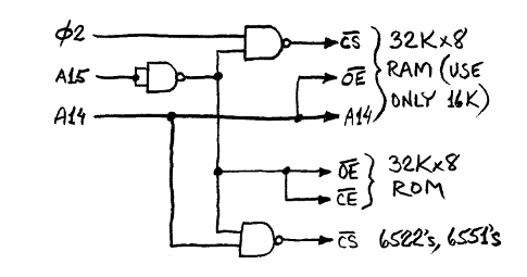

That's a nice simple minimal design. I think, though, you're going to need at least one logic gate in there too: at present everything is designed on the basis that a clock cycle is an indivisible thing - is either read or write, and selects just one device. But in reality, for ten or twenty nanoseconds after phi2 falls, there is some pushing and shoving as the different signals change from one state to the other. To avoid misbehaviour, the usual thing to do is to use the clock signal itself to distinguish the stable periods towards the end of a cycle from the everything-in-motion periods towards the beginning.
For example, if you explore Garth's primer, which is well worth some of your time, you'll see this very minimal but safe and working glue design:
(As it happens, we've recently had a couple of related discussions - see here for example.)
You might well find Jeff's animated diagrams helpful, or you might want to bookmark them for later.
Edit to add: it's possible the '138 is flexible enough that you can use it to qualify signals with the clock - I haven't thought about that.

Yes, the 74HC138 has three enable inputs, two inverted (/E1, /E2) and one active-high (E3). So you could feed Phi2 into E3, and the various /CE signals would then be qualified by it.
The propagation time from E3 is the same as from the address inputs, max 35ns at 5V, which is plenty fast enough for 1MHz operation. I would however be cautious of modern 6502s' tendency to change outputs very promptly after the fall of Phi2 (address and data holds are only guaranteed to be 10ns), and this will still be faster than your '138.
So I would at least also qualify your /WE signal separately with a plain logic gate, which will react much faster than the relatively complex '138. The logic term you need is (R/W | ~Phi2); you may be able to obtain ~Phi2 from the Phi1 output of the CPU, so you'll just need an OR gate. And if you're taking Phi1 anyway, you may as well also lead it to the /OE pins of your RAM and ROM.

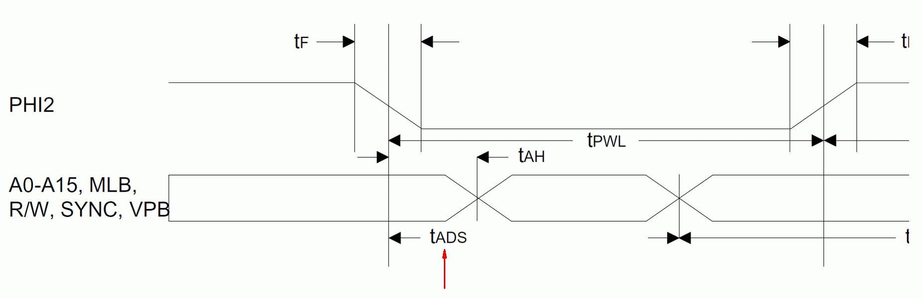

The 6502 only puts a valid address on the address bus when Phi2 is high.
Not so. For best performance, device selection in a 65C02 system should not be qualified by the clock.
File comment: 65C02 Address Setup Timing
If you examine the 65C02 timing diagram and AC characteristics, you'd see that the address bus will become valid tADS nanoseconds after the fall of Ø2. tADS varies to some extent with operating voltage and the Ø2 clock rate, decreasing to a guaranteed value of 30ns at 14 MHz—that is, A0-A15 will be valid no less than 5ns before the rise of Ø2 in a 14 MHz system on five volts.
What should be qualified by Ø2 is read/write access to any non-65xx peripheral hardware, achievable with a circuit similar to the following.
File comment: Qualified Read/Write Generation
In the above circuit, /RD (read) and /WD (write) will not be asserted unless Ø2 is high, which is when the contents of D0-D7 are guaranteed to be valid.
65xx peripheral hardware, such as the 65C22 and 65C51, "knows" about the 65C02 bus cycle and thus accesses to such hardware should not be qualified by anything. All setup for such devices must be completed by the rise of Ø2. Otherwise as Garth noted, it will not work.
