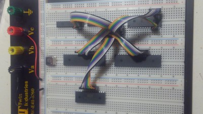

On the good advice of others here, I will now be posting my progress on one thread. I also decided to name the thing, and I suspect anyone around here will get the reference. (Heck, it's probably been used already!)
OK, in the spirit of one stop shopping to find info on what I'm up to, here's the current plan:
Simple 65c02 build, initially on a breadboard. 1 MHz.
6522 VIA
6551 ACIA. I currently have the buggy WDC part, but the improved Rockwell part is in the mail.
32k SRAM
32k ROM
Garth's simple single 7400 based address logic. (I prefer the simplicity over the slightly wasted memory for now)
FTDI chip to get the UART talking to my PC.
My future "stuff I wanna do when I am smart enough"
On board video processing with composite out
On board keyboard processing, hopefully period accurate, but that's not a necessity.
Here's the buggy that will really stretch me. I want to write some sort of compiler/assembler/interpreter (one of the three) for the thing. I love the idea of using an assembler I wrote on hardware I built. I think it would require a pretty well rounded knowledge, and thus would direct my learning in all the right places.
Here's what I have so far. Just the data bus is hooked up. The ribbon cables are all custom made by me so I can have the lengths I want.

Someone mentioned that my star scheme with the data bus could cause problems. Care to elaborate?

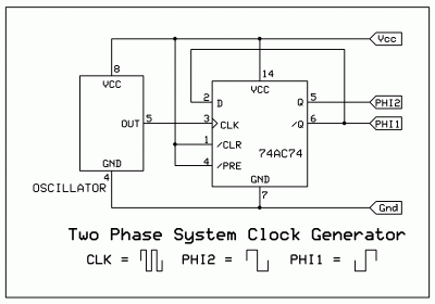

Dan Moos wrote:
Also, I do get a pulse on the Ph2 pin. It is identical, and perfectly in phase (as per the scope's phase measurement function) with my clock pulse. It is actually prettier (almost no ringing).
I also get a nice signal on the Ph1 pin. It appears identical, and 180° out of phase with the clock.
Just for your future reference, the two clock outputs of the 65C02 are meant to allow the 'C02 function in a circuit that originally had an NMOS 6502. WDC does not test these outputs, doesn't quote any timing values for them and does not recommend their use in new designs (see pages 10 and 26 in the data sheet).
You can achieve the same pair of clock outputs with the below circuit:
File comment: Two-Phase Clock Generator
This circuit offers several benefits:
  1. The output is symmetric. Use of a symmetric clock becomes important as the Ø2 frequency closes in on the MPU's maximum ratings. Jeff Laughton (Dr. Jefyll) has discussion on his website on timing margins and what may happen with an asymmetric clock. There is also discussion on the forum on this topic.
  2. The flop drives harder than a typical can oscillator. Stronger drive assures that you have a clock whose amplitude swings essentially from rail to rail.
  3. The flop's outputs have very sharp rise and fall times, well within the limits required by the WDC processors. Note, however, that fast transitions can trigger significant ringing. Dubious construction methods will exacerbate this problem.
  4. Ø1 and Ø2 are exactly 180 degrees out of phase. Although it isn't likely that you will need Ø1 in a 65C02 circuit, it is a useful signal in a 65C816 circuit that uses discrete hardware for latching the A16-A23 bits.
