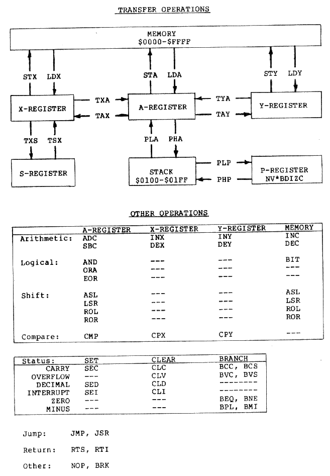

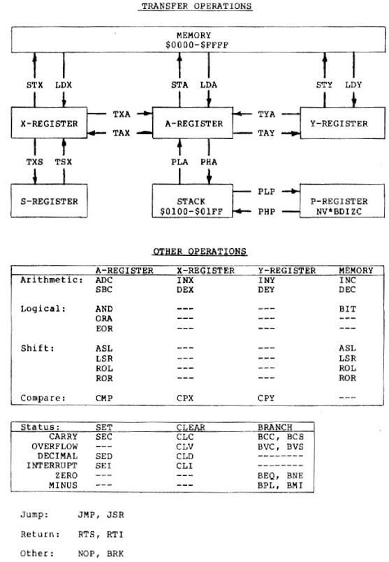

(We'll always get a big detour when we indulge in pedantry... resist the temptation!)
Back to 6502 programming - there's a great diagram of the programmer's model for the 6502 by Bob Sander-Cederlof. Here it is as an image (from here) and as text (got to love ascii diagrams):

File comment: 6502 Programmer's model by Bob Sander-Cederlof.

That was a good way to visualize it. Ed, would you like to post an updated version, perhaps under "Tutorials, References, and Primers" at http://6502.org/tutorials/, to reflect the added CMOS instructions and addressing modes. It would be a good addition. Glaring are the lack of PHX, PLX, PHY, and PLY. Also lacking are TSB, TRB, INA, DEA, STZ, and BRA, and to a lesser extent, BBS, BBR, SMB, and RMB.

BTW I posted that diagram previously, in Best way to start learning 6502 Assembler which might perhaps be a good sticky thread in Newbies? If not, it might contain some material for such a post.
(I'm pretty sure I also straightened up the image but I can't find that anywhere.)
(Edit: found it, and updated the post upthread.)
