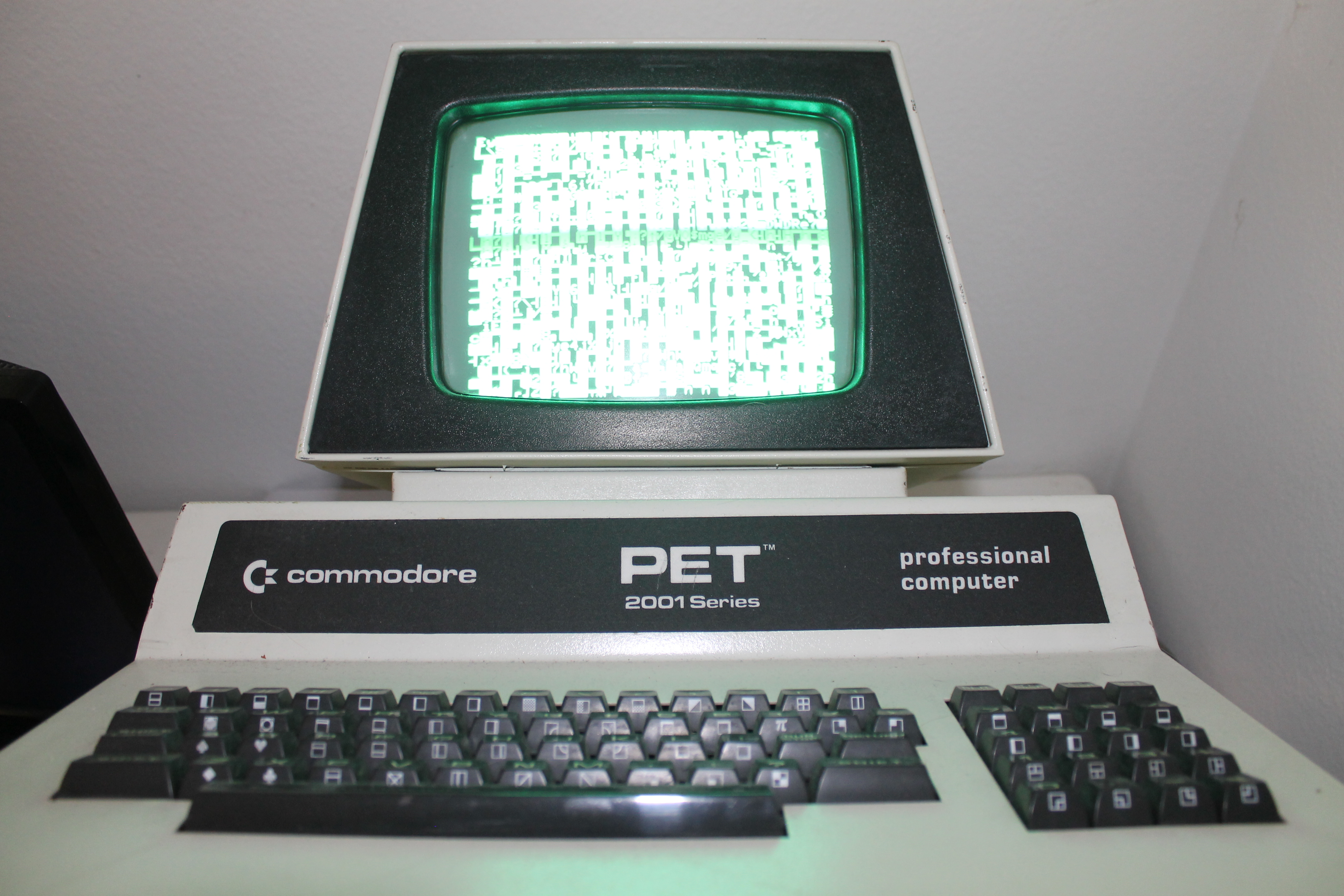

Hello Guys, The saga continues!
My logic probe has arrived. After watching a few youtube videos on how to use it, i set out to check if the system has a clock.
i go check the clock on the affected socket UC7, B-Phi2 on pin 25. it should be "oscillating". I get both LED's lighting up, indicating a pulse higher than 50Hz.
I have checked B-Phi 2 all 65XX chips and get the same results.
one interesting thing, when i remove the 6502 chip and start the machine with fully empty slots, it now shows a screen full of random characters. It has never done this before and its doing it consistently now. So i investigated a bit further. Removing the chip in UC7 and UC4 will result in the screen being on with random characters. Placing the 6502 back into UC4 and starting the machine creates a blank screen but leaves IRQ high on the 6502 high. We knew that but i thought i repeat it now with this new screen phenomenon. So there is still something about the UC7 socket that creates a low IRQ once the chip is in the socket.
I have seen a couple of posts about this random character issue so this gives me further reading material.
Emmanuel
(picture of the screen)

The reason you’re seeing garbled characters on startup without the CPU is most likely because nothing (a.k.a the CPU) have been able to clear screen RAM yet, so the memory just holds trash. But you can cross the fly back transformer off the list now :)
You mentioned hot ROM. If you got a programmer available, try to dump the contents to check if the chip is still good. That’s an easy test if it’s socketed.
