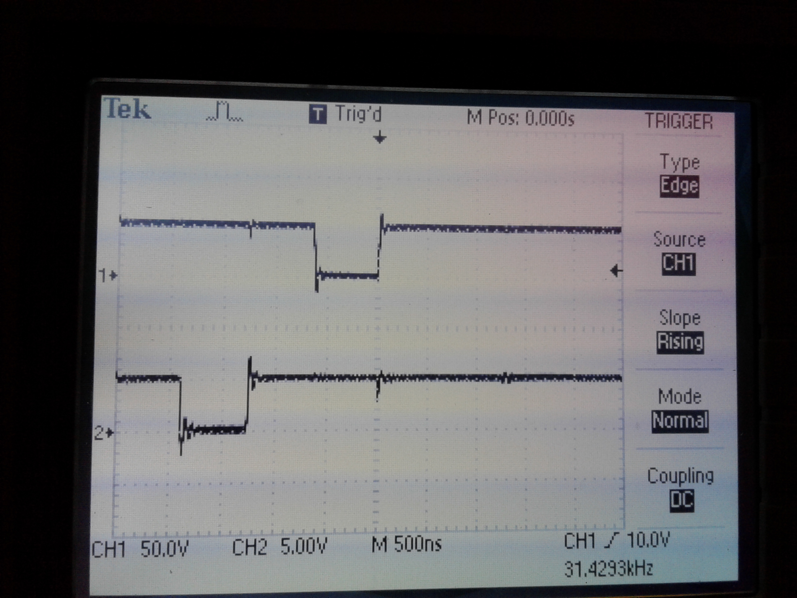

So I did an inventory of what I had, found a ton of 74HC00 chips, so I decided to try a real Ben Eater style sync generator.
Attached is a schematic that I did this afternoon. I then put that on a board. It barely fits. Wires are a mess, it's like doing surgery.

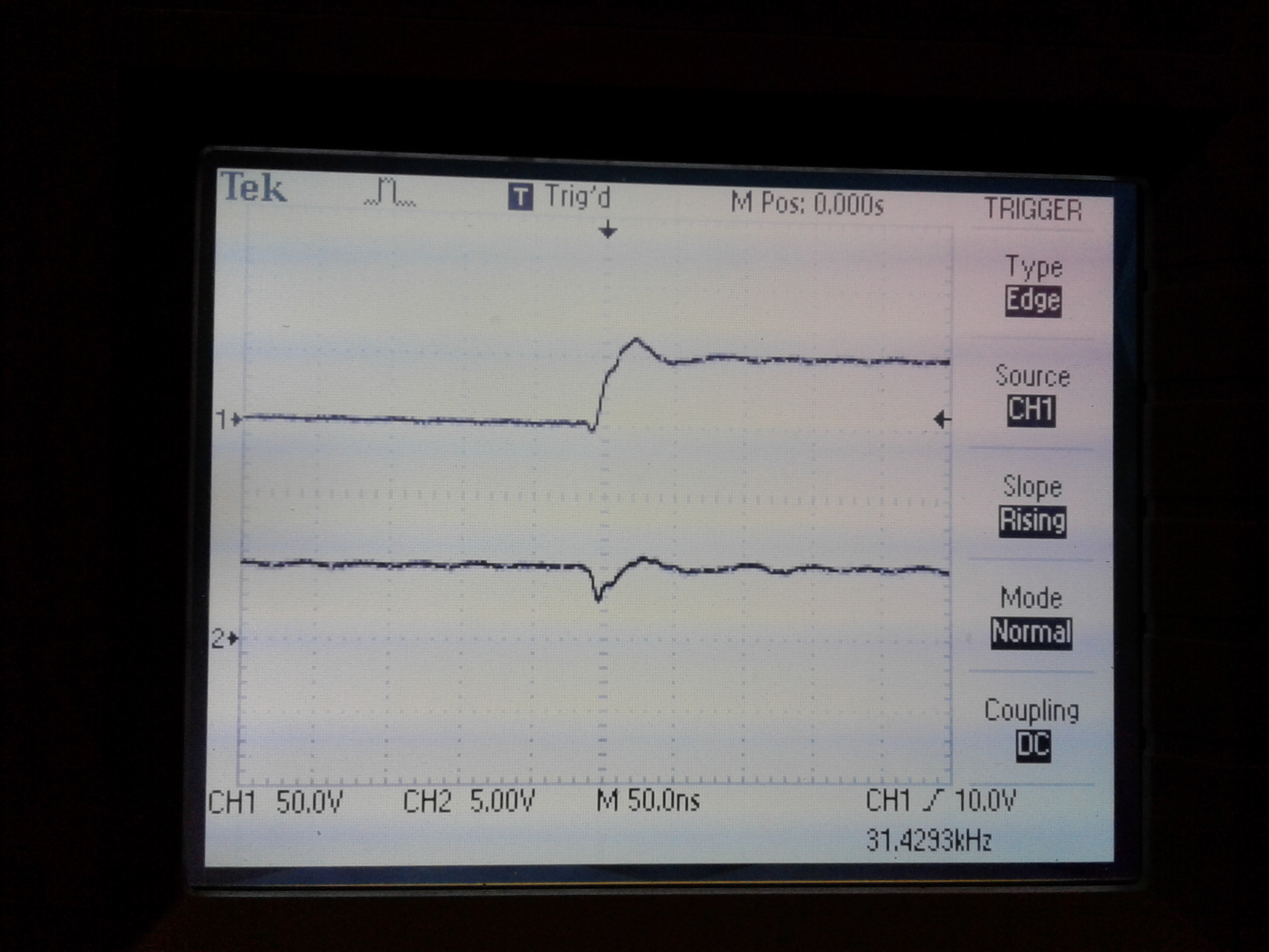

The reset signals are great, timing looks great, everything is great. EXCEPT the SR-Latches!
Also attached are the two timed signals going into the SR-Latch for the horizontal sync. I don't have a third probe, so I can't show the results, but the results are a flat line. One side is always high, the other side is always low.
Clearly the signals look fine, and because they are alternating, it should trigger the latch to change in one way or another! I did notice a little blip on the other channel when it should trigger, I zoomed in to show. Could that little blip stop it from triggering?? I added capacitors nearby, same results.
I can't do this any more today, but tomorrow I have an idea to use a 74HC193 counter as a 'latch' by setting one line to enable load a zero, and the other to the clock up, having my h-sync line on the Q0 or whatever. Silly as heck, but if this SR Latch ain't working, what other options do I have? I figured this SR Latch thing was super easy...
Anyways! There's the update. Thanks everyone.
Chad
EDIT: I now realize my "VISIBLE" tag is off on the logic. But those SR Latches are just frustrating me! Grrr. I'll do some more testing tomorrow.

PostPosted: Wed Dec 29, 2021 2:17 am
Posts: 741
The glitches in one signal when another signal changes state quickly are the kinds of thing decoupling capacitors can help with. One signal changing causes extra current draw through the IC that outputs it, and without a local decoupling capacitor this leads to drops in VCC (or rises in the ground level) going to other ICs that then cause echo-like effects on other signals. Adding a 0.1u ceramic capacitor to the IC that is switching state may help, as well as considering where your probe ground connections are located, as not all grounds are the same level.
For the kind of circuit you have there though, these glitches can also be due to race conditions between different counter output bits going through chains of logic gates, arriving with sightly different delays. It is tricky to get these kinds of things right and again sampling at a specific time after the logic has had a chance to settle has worked best for me.
However, if signal 1 is high and signal 2 is low, then the NAND pair's output should definitely be different to when signal 2 is low and signal 1 is high - regardless of what happens at the transition points. It's odd if you don't observe that. Your scope traces show low periods of around 1us I think which should be plenty long enough to observe the output changing, even if it didn't latch properly due to the glitches in the transitions.
I'm going to address all three really:
1) I added some capacitors nearby, and it did "help" a bit. The blip got a little smaller in magnitude, though not by much. This was with those capacitors added.
2) Indeed, there are multiple things going on at different times. I figured most of the inputs to the signals are fairly slow, being in the hundreds generally. I do see solid signals, for goodly amounts of times, and at the right times as far as I can tell (except anything past an SR latch).
3) I looked at my configuration about a hundred times this evening. I just keep thinking, "Surely I just put a wire in the wrong place." or "Surely I just didn't power the chip or something." I have looked and looked, and see nothing wrong.
I can simplify some of these signals with AND gates that I have, so I will probably replace any NAND -> NOT with AND tomorrow. That might give me some room to use a '193 as a "latch", and see if that works. Who knows. It's very frustrating being so close here, and yet a very simple SR latch is holding me back.
Btw, I'm doing it this way because my EEPROM programmer is busted, so if the ROM has incorrect signals on it I can't change it at this point. I was going to solder a new one but decided to try this again. And maybe even tomorrow.
Thanks George.
Chad

Very correct Garth. I remember reading that post a bit ago. And I should have listened to you, breadboards are not the way to do this sort of thing.
Oh and I figured out why the SR latch wasn't working. Super easy solution: The chip wasn't seated at all! It had popped off the breadboard!
Update:
Since about 3:00am I've been re-writing the logic side of things on the breadboard. I used some AND gates and it significantly reduced chip count, good! I tested as I went, checking everything.
My horizontal sync signal was coming in just a bit shy of what the specs say. So I altered a bit of logic to reset/clock one pixel earlier. The scope said a dead-on 31.468kHz. I couldn't get any more exact than that.
I then went to my vertical sync, and it was double the frequency needed, 120 Hz almost exactly. Why? One of the '163 counters on the vertical side was counting like each clock was two clock ticks. I don't know why, capacitors didn't help. Whatever, I shifted all of the output lines over one, and I got a dead-on 60 Hz. Wish I would have taken a picture.
At this point the monitor is doing nothing at all, not even black. It's just it's "self test" whatever. The menu doesn't work at all. I figured it was missing pixel data. So I told it to display 1 pixel somewhere in the middle of the screen. While doing so some chips pop off the board. And then some wires. I redo stuff, I put things back. Nothing is displaying. I go back to check and the vertical sync is now saying 30 Hz. ARG. I *just* shifted everything over to accommodate for that weird timer, now it's working properly???
It's the breadboard's fault.
So I took off the VGA connection wires, I took off the probe wires, I took off the power wires, and then I threw the breadboard over my shoulder. It is literally trash to me at this point. I'll recover the chips later.
If I ever get the smart idea to use a breadboard again in my life, slap me.
Onwards: How do you guys normally prototype (without breadboards)? I can solder onto perfboard, but I switch so many wires (probably again because breadboard's fault) that it doesn't seem practical to solder right up front. Any ideas are welcome. A "better" breadboard sounds fine at face value, but I'm put off from these things for now.
Thanks everyone, so close, yet I was never close to begin with.
Chad
