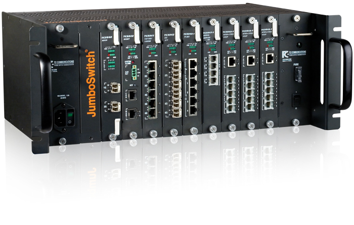

Here are various card cages. I realize you're interested in something much smaller; but there no reason you can't implement the idea with much smaller dimensions. Imagine a card cage so small that the cards are SD-card size! :lol:
PC/104 aluminum-railed card cage (90x96m cards, no backplane):
Image Image
This is the automated test equipment I built at my last place of work, about 1991 and using STC bus, shown in my project pages on this site, first with the top and front panel off, showing the cards in position and plugged into the backplane, and then all buttoned up and being used to test a board:
Image Image Image

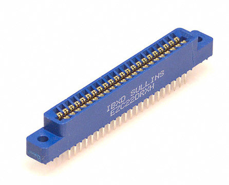

I have a short discussion of expansion buses and interfaces at http://wilsonminesco.com/6502primer/ExpBusIntrfc.html, part of which addresses exactly what you're saying. There's no reason you couldn't make a tiny one though! :D The small size would get rid of the long connections and make it more suitable for high speeds. VME bus is not small, and it's fast (VME320 will do 320 MB/s), but the engineering behind the bus transmission lines is well beyond most hobbyists. For a small backplane, you could use something like this Sullens board-edge connector with 44 pins on .100" centers which shows up quite a bit larger than actual size on my monitor and was used for the C64 expansion port,
or pin headers on the same .100" centers, with as many as three rows, giving 45 contacts in 1.5", 60 contacts in 2", etc.. The Samtec SSW catalog pages are attached (just two pages).
I love those connectors! I actually have a few in case I need them for my Commodore's. I thought about using the same edge connector used in the Apple IIe. That would be a great throw-back to that era.
