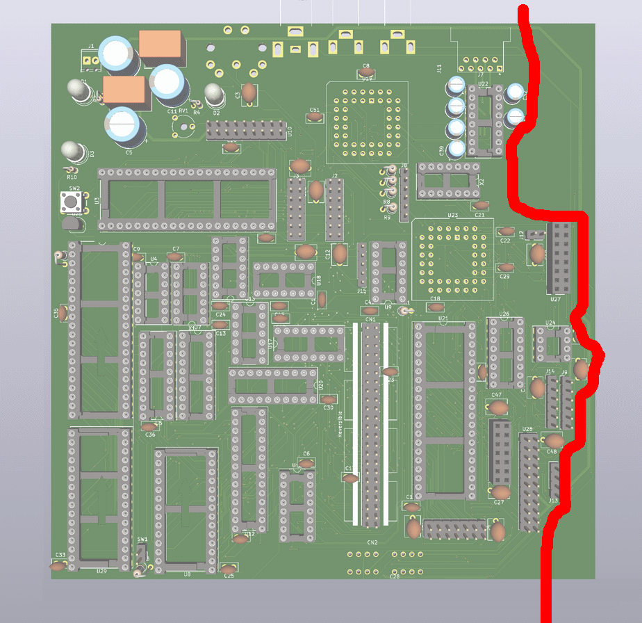

One option to make it smaller is to move to SOIC packages. A lot of work, though, to redesign entire board.

I've tried very hard to stay away from surface mount. I have two aversions to it, the first being that I can't socket smd packages, and the second being that although I've soldered them before, I hate doing it, and if I don't have to get a stencil and paste (and figure out a reflow oven) that's always a plus.
The video card and audio card I have planned use VLSI chips that are surface mount, and I've actually considered having those boards assembled as well as fabbed, just to avoid having to solder them myself.

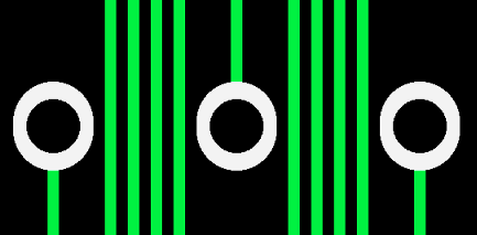

Ya, that's actually another thing, I can only fit two traces through the DIP pins if I'm lucky (on one side of the board that is). I tink it's because my settings are 6mil/6mil, and I think the pads that I've selected for the chips are kind of fat. I assume with SMT style I'd still be able to fit one, so nbd, but I'm not sure if I'd put vias on the pads, since if I had a lot of SMT stuff I might go ahead and build a solder paste dispenser, which works kind of like the big machines do, and it might make a mess.

Happy to help. :) Maybe your next goal should be reducing the x axis. Look for stuff that protrudes, and see if it can be moved vertically or squished inward. :)

I actually looked at that last night, and I think I can push the 65SPI in, and some of the chips beside it, and get some x length off.
With .007" trace & space, you can get three traces between pads of a DIP. Use .030" holes and .050" pads.
With .006" trace & space and .045x.055" pads, you can fit four in:
Ya, my pads are probably bigger, I'm using the footprint defaults that come with kicad for sockets with long pads (easier to solder)
Since I'm rewiring, I may try and make the pads smaller and do this, my only reservation is soldering with such small pads
The pins stick out the back of the board the same distance; and since the holes are thru-plated, soldering the pin will get the heat into the pad and solder that too. No problem at all.
