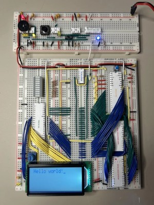

After long time of using 6502 emulators (since the many years since I was coding real apple ][ and atari things) I've been enjoying working thru the ben eater videos and digesting Garth's primer etc. Things were fine with the initial ROM-only test programs but as i've started working with more complex things like LCD driver using RAM for storage and stack I've been seeing similar intermittent crash loops where the code works for an indeterminate amount of time (only 1000s of cycles) and then hits BRK in zero'd memory and starts bouncing back and forth on the reset vector (which is also zero'd). I can see happening "live" if I hook up my lcd stack to the high address byte.
occasionally I am lucky and can see the LCD initialize and write startup text (typically only first run after first powerup), but usually (90%) it crashes earlier, often before completing LCD init sequence. the code is very simple and solid in an emulator. was stuck trying to imagine what could be corrupting the stack and causing the crash and eventually discovered this thread. I am using WDC65c02 also and went back to check my parts shopping basket (sourced my own in Canada rather than standard kit), and lo and behold my SRAM chip is ... AS6C62256-55PCN.
I also had little understanding of the 74hc v 74ls distinction when I was starting out; the quad nand gate on the main breadboard is 74HC, but the mux in the clock circuit is SN74LS157 (ignore the specific part number on the labels which were a great discovery for recalling pinouts). That probably explains why my clock output high is close to 2.5V actually?...
I have a bench power supply so will try first just dialling it downwards from 5.0V and see if that helps. Also will add 10K pullups on data-bus. But sounds very much like the same problem that was much discussed here. You can see my layout is super simple and this is still driven by the v slow 555 clock.
It seems like the ultimate solution here was to replace the SRAM with one from a different manufacturer?
Re: Strange memory write problems
Lots of possibilities, but my first question would be about bypass caps - you don't seem to have any on the main board. At least one per chip is a good idea.
Also, more ground wires would probably be a good idea - approximating a grid is a good way to look at it.
But, as your problem is unreliability, and you're on a breadboard, the reliability of connections is another weakness - you need to be sure that every wire and every chip leg is making good contact. If the chips are of an age, then cleaning all four sides of each leg might be worthwhile.

they're hard to see on the top view but there's one at top right and bottom left on the power rails. I can sprinkle more around for sure. all the components were new from supplier within 60d. it definitely seems correlated with this thread since I saw no problems with rom-only code; only when I started using RAM for r/w storage (code still all in rom)
can you elaborate on "more ground wires"? when I have each chip grounded to shared rails which are cross-connected, where can/should I add more? I guess I could also cross-connect rails on the bottom edge. i have done a bunch of continuity testing and haven't found anything. these are the "good" breadboards as recommended also :)
Good quality breadboard always a good start!
I'd suggest you cross-connect your north-south ground wires two or three times in an east-west direction.
I'd probably also connect at least one more ground between your two main boards: you want a clean clock, and the clock, like everything else, is referenced to ground. So you want a solid ground, in particular the chip driving the clock needs a good (redundant) connection between its ground and the ground of each of the chips receiving the clock.

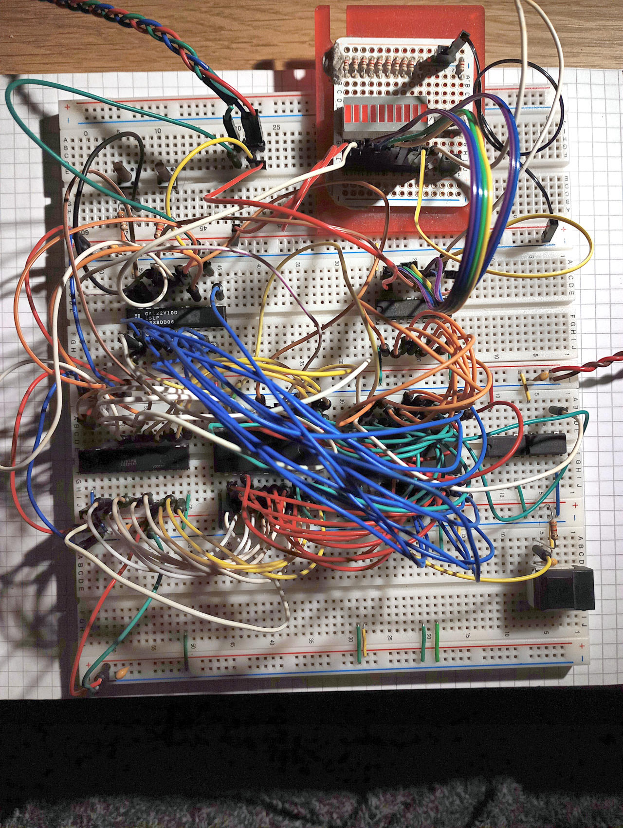

The layout is very neat. I'd be surprised if there was a problem with the layout - assuming the contacts on the breadboards are good enough.
Compare with this:
That's a 6507, 8KB RAM chip (only using 4KB), 32KB EEPROM (only using 4KB), a GAL for glue and a latch for output. Also runs at 2Mhz. Those breadboards are the cheapest I could get from a UK retailer.
So if I can get that big mess of wires to run at 2Mhz then your kHz 555 clock should not be the issue. I think i'd be looking at marginal timings on the RAM side of things. Hard to tell though - have you a 'scope?
Other things to try - try cooling the whole thing down if you're in the northern hemisphere just go outside (at least here is Scotland it's 0°C right now!) Often things that might have marginal timings will work when cooler - every hardware engineer I used to work with back in the 90s had a can of freezer spray handy just for that sort of testing... Also the power supply. Do you trust it? do you have a 2nd meter to check? Try taking it up to 5.2v ... My Ruby 816 board really doesn't like anything < 4.9v for some reason (I think the timing for sending commands to the VIA is marginal, but I don't have good enough test equipment to find out - it works at 5V so that's OK for me).
And try resting your hand on it then gently shaking it - see if it crashes - that's as good indication of a loose wire, or bad breadboard track as any.
