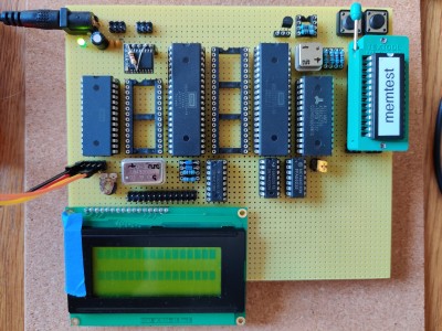

Wow everybody. I have been so engrossed trying to work out what the BEEP is going on that I didn't come back here to see if anyone else had replied - and you have. I am much obliged.
Some reples to your questions and suggestions:
I have been using the serial output to show errors. I'll come back to what I have found below.
NoICE is a Windows program that interfaces with a, I'll call it a monitor program on the 65C02 (and many other chips). The results are displayed on the screen and you can (amongst MANY other things) type into memory and get a response back keystroke by keystroke.
NoICE link: https://www.noicedebugger.com/ and https://www.noicedebugger.com/targets.html
Link direct to the 6502 NoICE page: https://www.noicedebugger.com/help/targets.htm#65C02
I have spent a considerable length of time checking every connection - not just simple continuity, but checking the resistance is negligable - from pin to pin on the chips - also checking every connection ONLY goes to where it is meant to go as well. Thats a lot of checks! I thought I had it when I found a tiny curl of wirewrap wire loose under a load of connections ... but no.
Photos are attached.

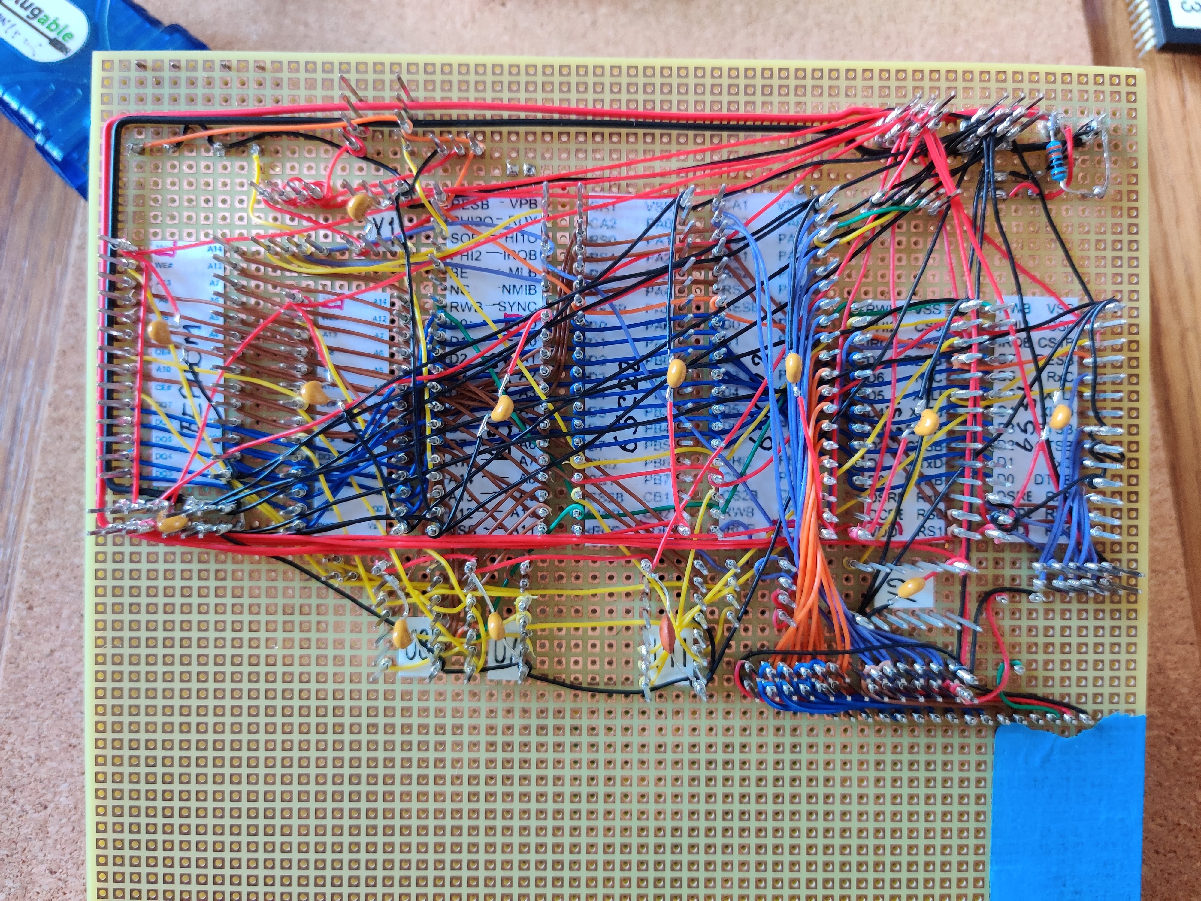

Okay, so now to construction. This machine is built on a piece of, I think its called perfboard(?). It has a pad round each hole on one side (that I have simply ignored). It therefore has no ground plane. Because of this I decided to connect each power and ground pin to TWO power distribution places one in the north east and one in the south west of the board and also connect every power and ground to its neigbor chip - so that gives a total of three connections for power and ground to each chip. I took Garth's suggestion of making like a spider's web to heart.
Garth, this is actually my second iteration of this board. The first had "swoopy" connections and was so ugly - and wouldn't run anyway - that I started again and did everything "shortest path" and straight.
CountChocula
Hello! I do have a test harness socket that allows me to monitor what's going on at a deep level - uses a good old Arduino to monitor a single stepped machine - but since the problem (or at least the manifestation of it with the memory test program) seems to have changed somewhat - I don't think it would really be possible to step through trillions of instructions. I did think of doing it but I don't think it would be practical.
"Removing every chip I don't need". From photos, you will see I have done this. In fact I had all but a single 6551 support chip out at one stage. No luck I am afraid.
So, where does that leave me? Well, I have ordered - from the USA - a new Twin Industries 8100 series (single ground plane) board as recommended by Garth and when it arrives I will- very probably - start again. In the meantime I will keep troubleshooting but with a) my equipment and b) my lack of knowledge/experience I suspect I am close to the limit of what I can do to find the problem.
GaBuZoMeu, you said about using Phi2(out) (p39) for timing and driving the I/O parts. I will have to get my head round that one. I havn't seen it done in any designs I have come across.
Some notes on the pictures. The odd thing near top left with a resistor soldered across it is an r2c attached real time clock. Connected to one of the VIAs. its not shown on the schematic. The display is not shown either also connected to VIA1
The sets of posts extreme top right and bottom left (back view) are for power distribution. As mentioned above all (well, most) chips' +V and GND are connected to both of these. The distribution posts are connected via the black and red wires along the top and down the left hand side (on the back view).
Oh and I have only connected to pin headers on 1 each of the 6551 and 6522 chips - If I ever get it working I will complete the I/O connections

When you say you get roughly 5 - 20 errors per hour, do the errors always occur at the same RAM addresses or is the address completely random? Do they occur with particular data values? Is there any pattern to the corruption which occurs (e.g. always the same bit flipped?). Is it the write or the read which fails? You can tell by modifying your test program so if an error is noticed you repeat the read and see if you get the same value again or if the second read gives the correct value.
Regarding the board photos, the leads on the bypass capacitors seem quite long, but it's not obvious how you could make them much shorter without completely rebuilding everything and somehow getting a ground plane in there.
PostPosted: Mon Oct 31, 2022 5:30 am
The part that jumps out at me here is, "and also connect every power and ground to its neighbor chip." I'm glad to hear about the "neighbor" connections, but I suspect you may not have taken the idea far enough. In regard to power and ground, it's the connections to neighboring chips that are crucial (and not so much the connections to the power distribution places). More on that in the first few paragraphs of this post (which Garth cites in the fourth paragraph of his article).
Try to establish a grid, which ensures that each chip has connections to its neighbors to the East, West, North and South. Of course, chips on the perimeter or in the corner have only three or two neighbors, not four. But as much as possible you wanna connect to all points of the compass. Each ground pin should ideally connect to the ground pin of the chips to the N, S, E and W.... and likewise each power pin should ideally connect to the ground pin of the chips to the N, S, E and W.
From the photo I can't tell how near or far this is from being true. But it wouldn't take much work to add any wires that are missing, and it's possible (though hardly guaranteed) that this might correct your problem.
Worth a try, I'd say! It's surely a lot easier than building a new board. (And you've already done a very nice job, BTW! -- congrats on your project!)
It seems to be random. It also seems that it is the write that didn't work since, when I find a mismatch, I output the address, what I expect to find at that address and what I actually find at the address. Since I am storing an increasing set of values to all memory e.g. all $00, and check, all $01 and check all $02 and check, I "usually" (I haven't double checked it is "always", but it might be) get the preceeding value, I get, say, $54 when I should get a $55. By the way, the program occaisionally crashes, I guess through the stack itself becoming corrupted.
On the cap leads, yes, but they are as short as I can make them.

I realised on looking at the spider's web power and gnd interconnects that I had missed off direct interconnects between the 65C02 and RAM and ROM chips. There wasn't enough heighton the wrap pins to do 65C02 to RAM AND 65C02 to ROM to I added:
+5V 65C02--->RAM--->ROM
GND 65C02--->RAM--->ROM
i.e. 4 extra wires.
And damn me, it makes it WORSE. The memory test program starts, issues a CR and LF to the 6551 and then it is supposed to go on to print a banner before starting its work. It does the CRLF and then never gets any further before crashing.
I took the extra wires off and its back working again. How can that BE???
I am beginning to be seriously demoralised with this thing. :-(
