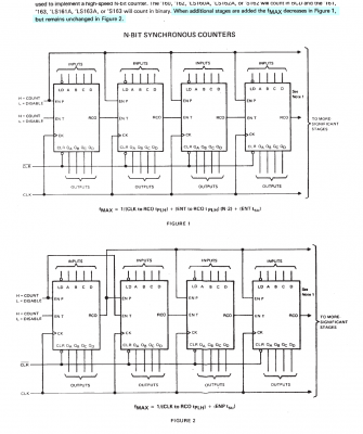

sburrow wrote:
If I had chip #1 TC connected to chip #2 CP [...]
This isn't the best approach because it means CP (clock pulse) doesn't happen at the same instant for all chips in the chain. As a result, the changes on the ABCD parallel outputs of one chip will be skewed, timing-wise, compared to the parallel outputs of the other chips -- and such a skew may be problematic.
So, to avoid the timing skew you'll want all the clock inputs connected together. But even with a common clock there's still a simple way and a preferred way to manage the other connections.
For some reason the newer '163 datasheets I've seen don't discuss the proper way to cascade chips. But here's an old (LS series) '163 datasheet that does address the subject. See the section, "Typical Application Data" on page 21.
74ls163a.pdf [1.33 MiB]
Downloaded 79 times
Here's the pertinent diagram. The method shown in Fig 2 is preferred, because the Fig 1 version increasingly limits the maximum frequency as more chips are added.
EDIT: please also see expanded diagram (four Figures rather than two) which I later posted here.
Hm! Yep that's perfect. Thanks Jeff. I'll make the adjustments now.

The way I visualize these different configurations, to understand the differences between them, is to think of the operation as a hexadecimal count operation rather than a binary count, with each '163 responsible for a separate hex digit of the count value. The different configurations are different ways to send tick or enable inputs to each counter in order to get them to increment at the right time, especially concerning how carrying works from one counter to the next.
So your first configuration was more or less a ripple carry situation again, just between hex digits rather than between binary digits. You'd send a clock pulse to the low-order counter, to increment the "units" hex digit, and if it was F, then you'd also (but slightly later) send a clock pulse to the "sixteens" hex digit. And if that one was an F as well, then it in turn would send a clock pulse to the next digit in line, and so on, with the carry rippling down the chain. It suffers the same kind of propagation delay issues as the 4040, but in a less extreme way.
The top example in the LS datasheet is also a ripple configuration, but it has a degree of look-ahead - between clock pulses, each "F" in the hex number is already sending an enable input to the next counter in line, so that when the next clock pulse arrives they will all update together. So far so good -and the actual count operation is synchronous, happening on all the digits simultaneously in parallel - but now it takes some time after the count output is updated for the new carry look-aheads to propagate, and it's this propagation time that limits the maximum frequency you should use.
In more detail, the first IC in the chain will update its RCO (as labelled in the diagram - I think it's called TC in newer datasheets) based on whether its new value is an "F". This passes to the "ENT" pin of the next counter in line, permitting it to tick next time, and also permitting it to output its own RCO state. So if that next one is also "F", it passes that along, and you have the same kind of ripple carry effect, but almost behind the scenes - as the output count was already updated synchronously. The constraint here is that you must not send the next clock pulse into the counter array until this RCO/ENT ripple has passed through the whole chain, otherwise later counters will tick or not tick incorrectly; and this is where the maximum frequency comes from.
The only change in the bottom (preferred) example is to make a special case for the lowest-order hex digit. The higher-order digits still perform the count and ripple carry look-ahead in the same way, with the same timings, but their ENP is only enabled if the lowest-order digit is currently "F". This means that you no longer need to wait for the ripple to propagate before sending the next clock pulse - it's safe because ENP will have gone inactive and they won't respond to it anyway. You could theoretically send 14 more clock pulses before needing to wait for the ripple to have completed, which I guess is plenty in practice. So the frequency constraint shown in the datasheet just accounts for enough delay for the first counter's RCO to be fully received by all the later counters simultaneously.
Additionally, the first counter's ENP is connected to the second counter's ENT. I'm not sure why they do this, as trying to enable/disable counting for the whole chain by changing the state of this input would lead to another ripple effect. It feels like you should just connect this high all the time, and use the first counter's ENT instead to enable/disable the whole array, which will again have a constant response time regardless of how many counters are chained.
That was a incredibly detailed response. Thank you for that. I will actually be reading that at least 2 more times before I'm satisfied.

I exactly agree with you by the way! I'm looking back and forth on Figure 1 and Figure 2, and I'm not seeing a big difference in the end. I was planning on always setting Chip #1 ENP and ENT high, thus Chip #2 ENT also high. Chip #2+ ENP is set to Chip #1 RCO. And then I daisy-chain the Chip #n RCO to Chip #n+1 ENT. This is the configuration on Figure 2.
Funny side note, Ben Eater uses Figure 1 on his schematics:
Haha, sorry for the length - it didn't seem so long when I wrote it!
In the meantime, I don't have these chips on me at the moment, and oscilloscopes are not my strong suit. I have the datasheet, and I have your feelings on this. You told me you were using some of these '163 chips, but did you not cascade them for any reason?
I didn't cascade them in my "simplest VGA" project, because I was trying to minimize the chip count. The schematic for one revision of it is here for reference: https://github.com/gfoot/simplevga6502 In this circuit the '163 is in the top left next to the oscillator, and its outputs are used to drive three chained '590s. The 590s provide 8 output bits per IC, though it looks like the last one there is barely used.
I've used them cascaded at 25.175MHz in my VGA sprites circuit though, which worked very well. I don't recall which technique I used, but it also wouldn't matter much for that as I only chained three of them in a row.
Lastly, going from Horizontal Counters to Vertical Counters. Ben Eater uses the 'horizontal reset' logic as the actual clock pulse for the vertical counters. That has always been in my mind as the way to do it, even now with these 4-bit counters. There will be ripple at some point I guess. Perhaps I'm just trying to minimize it.
Debug Innovations' notes discuss this sort of thing - and they actually use 4040s for the vertical counting, and note that this is OK because at the start of the scanline the display is blanked. So long as you're aware of the potential issues and have guarded against them, I think it's fine - you just need to be confident it's not going to cause spurious vsysc/hsync/blanking issues. Sending bogus addresses to a RAM IC during periods when its output is not even going to the screen isn't such an issue (unless, like me, you're using it to drive the sync signals!)
I re-read it all over again. Its making more sense the second time around, though I'm still a tiny bit puzzled why Figure 2 is somehow better than Figure 1. I will read it one more time (at least), but it makes much more sense now. Thank you again.
It is a little complex to think through but to summarize the basic reason is that the ripple down the carry look-ahead chain is not on the critical path. The low order counter is the only one that actually counts at the full frequency - the later ones are only enabled (by the first one's RCO output) once every 16 ticks anyway - when the overall hex value of the counters ends in "F". So they have up to 16 ticks' worth of time to get the carry look-ahead signals stabilised, and unless you're chaining about 16 counters in a row, that's going to be enough.

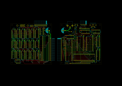

Just an update here.
Attached are some pictures of my PCB design. The PDF is white background, the PNG is black background. Two 4-layer 10cm x 10cm boards shoved together with some pin headers/sockets.

I don't have an updated schematic, but this is essentially my previous 6502 printed board but re-arranged for this particular configuration.
The one thing I don't love about it is that I'm using ribbon cables to connect the "EXP" pin headers between the two boards. I wanted to leave all PB lines free so that I can create a "user port", but I couldn't run the traces from the front to the back because it was just too clogged already. Oh well, minor stuff I guess.
Thanks everyone. I'll be checking this over about a hundred times before I decide to have it printed. I'll keep you updated as I go along!
