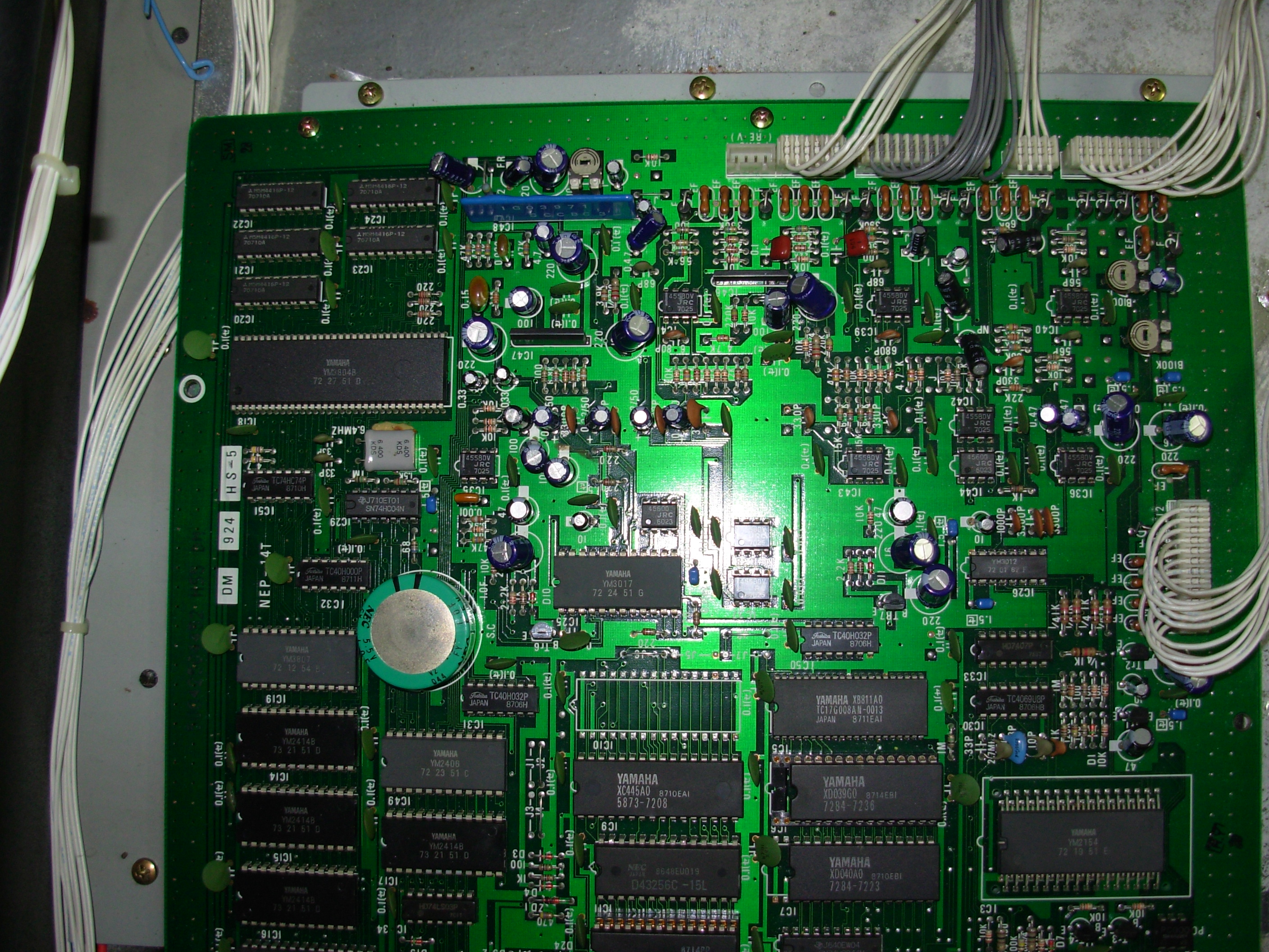

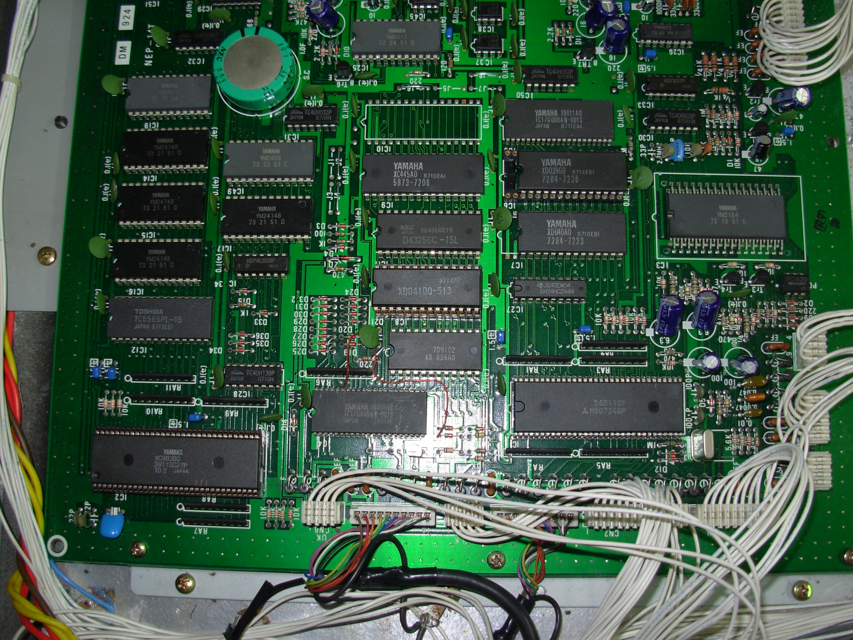

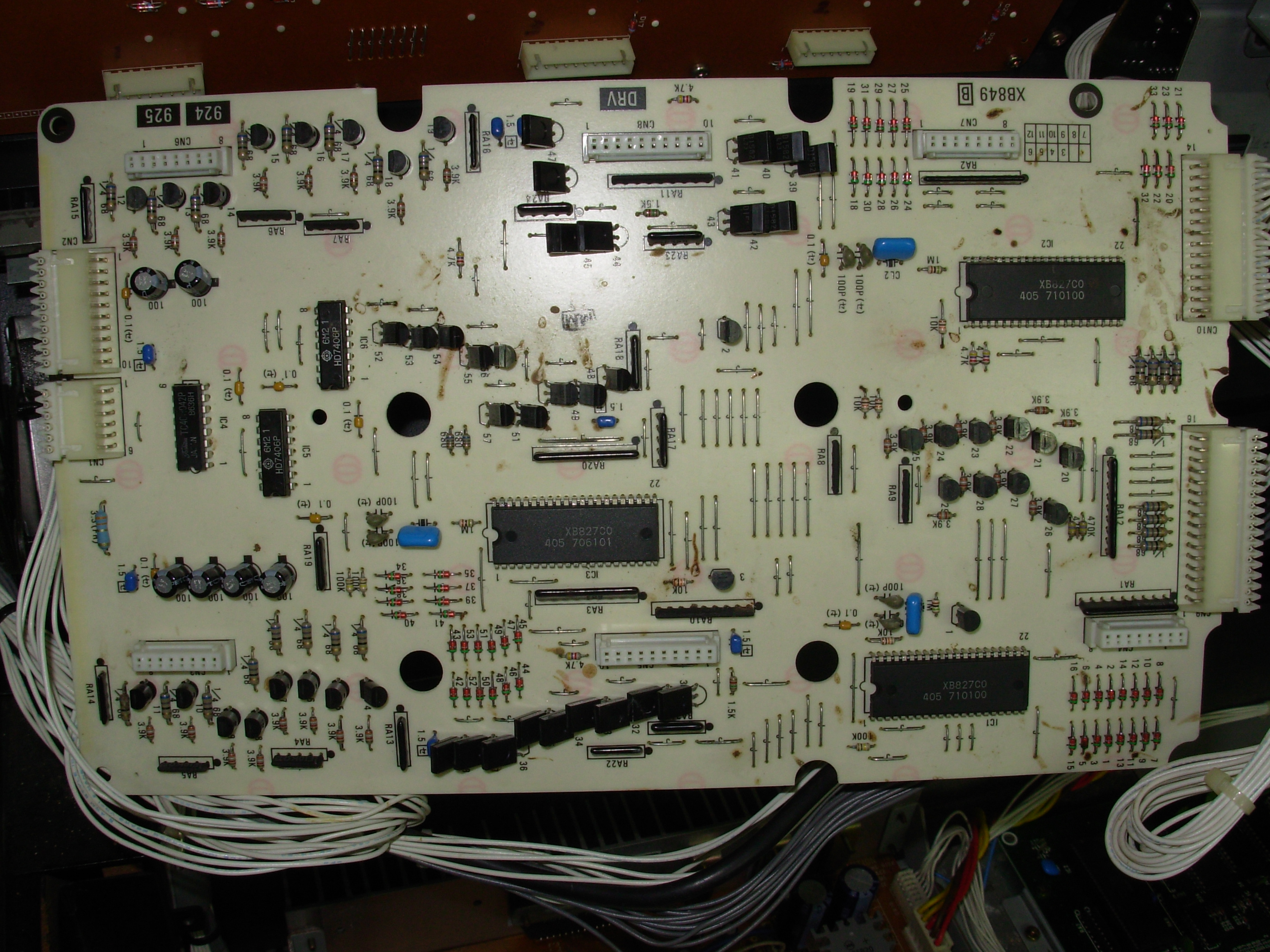

PostPosted: Tue Oct 22, 2019 7:52 pm
Joined: Wed Oct 16, 2019 8:23 am
Posts: 30
Here are pictures of the DM board in two parts, and the DRV board. Having some problems yesterday with the laptop I use for the LA but using alternate today should bring more success. There are a lot of instructions in the loop. Almost like it doesn't know there is a problem. I am unable to access the SYNC signal. The ic is one of those higher density dip packages and I can't get clips on to it.
File comment: DRV board
File comment: pt1 DM board
File comment: pt2 DM board

RR, thanks for posting the pictures.
The DM PCB is high quality PCB material indeed, so we could assume to have no hairline cracks on this PCB.
Not the cheapest connectors were used, so I think the problem can't be a connector that went bad, either.
IC2 (slave CPU) and IC8 (ROM3 Bank) sockets don't look 'high quality' like the socket for IC6 (ROM Main),
but IMHO that's nothing to be worried about now.
Sorry to say this, but I see nothing obvious in the pictures that could be the source of a problem.
Considering the width of the signal traces and the diameter of the vias on the DM PCB,
thou shalt not try to solder any components out of the DM board until you have adequate tools and until you know what you are doing. :lol:
//Only replace electrolytic capacitors in the power supply on a DM board that's fully functional, that is.
Hmm... would be good if we would be able to plug the DM board into another HS-5, just to be 100% sure that the problem is located on the DM board indeed.
