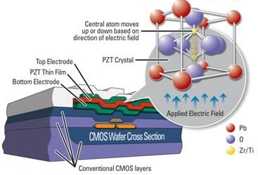

You might also look into FRAM. I know very little about it myself, but I believe it keeps the memory in magnetized spots on the die, not requiring any power to maintain memory indefinitely.
Indeed, it's nonvolatile, and just as quick to read and write but it turns out it's ferroelectric not ferromagnetic: atoms in cages have two stable locations and are shifted between them.
See the F-RAM tab on this page.
(Also interesting, like the core memories they remind us of, reading is destructive, so they have to do a writeback after each read. Arguably DRAMs do the same.)
