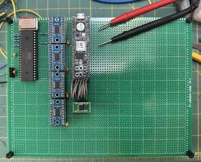

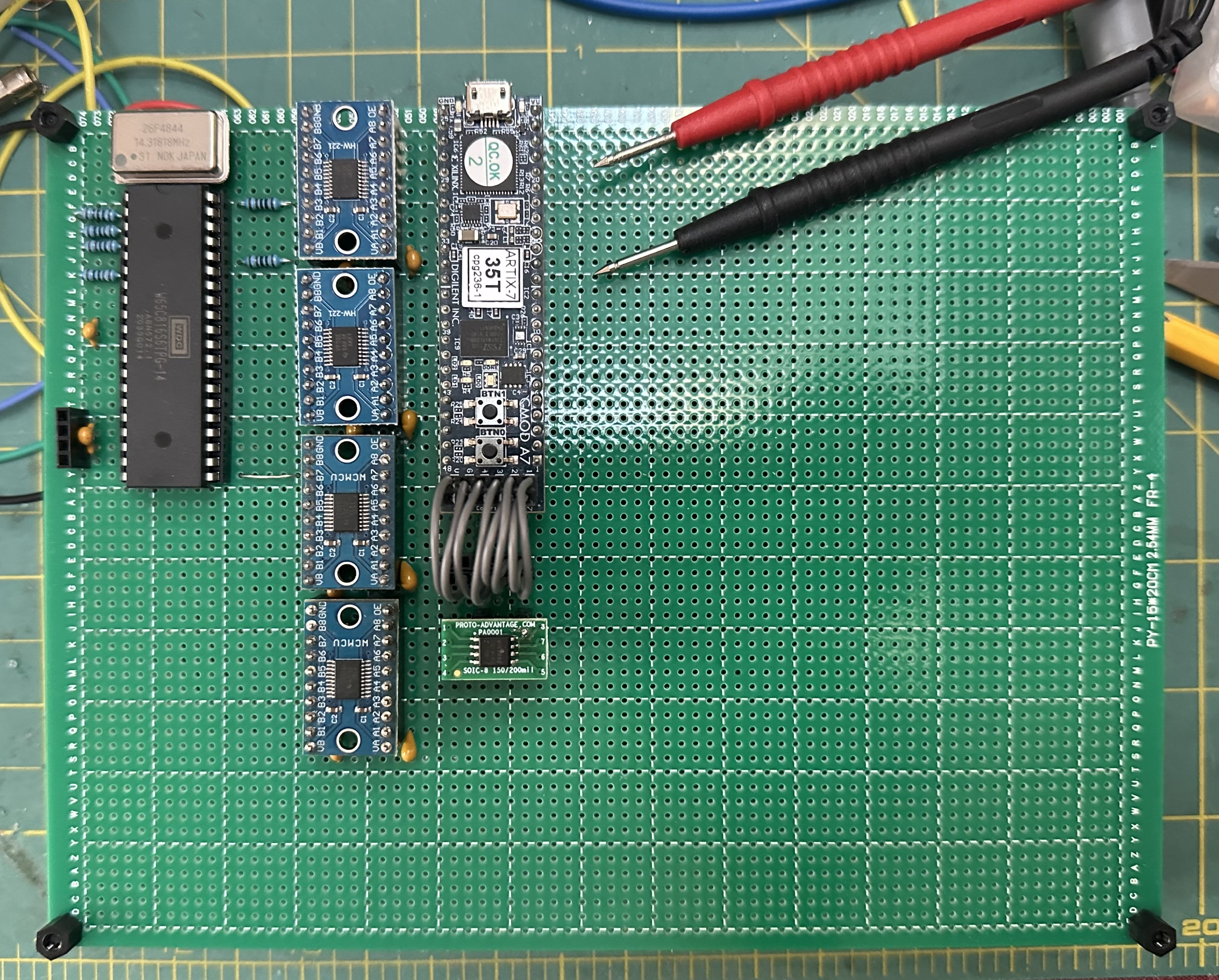

Can you take a photo of your setup?
PostPosted: Thu Jan 11, 2024 3:59 pm
Joined: Sun May 30, 2021 2:16 am
Posts: 375
Here is a pic of the setup. I have a flash chip under the CMOD, but that's not active now - that's for later. Every component has a filtering cap (0.1uF).
What I meant by 'no problem' was that when I upload the .coe binary and burn it to an ordinary EEPROM (55ns), and run it on a regular system I have with a 65C816 and physical components, including a W65C51 ACIA, it works. I.e., the little monitor program works. So, it's not a programming issue.
Edit: I meticulously tested every component, pin by pin. Everything is connected correctly, as set forth in the XDC file.
PostPosted: Thu Jan 11, 2024 7:07 pm
Posts: 255
So testing on your other system has verified that your software should be doing the right thing and that you probably have your pinouts correct.
What we don't know is if the software is actually running.
I see multimeter leads in your photo, so I know you have that. Do you have an oscilloscope? That would be the best tool for looking at the signals and making sure they "look correct".
If your working machine has the same memory map, then you can look at each address, data, and control line on that board and compare to this system, just in terms of what the signals generally look like (eg. high most of the time, alternating rapidly, etc) and will also show if you have signal integrity issues (eg signals not going fully high/low).
You need to break the problem down into little pieces and then devise a simple test that will eliminate possibilities. Here is my understanding of your current position:
1. You have software that should work on this sytem.
2. Your ACIA is constantly spitting out garbage and you suspect the issue might be here.
3. We do not know that your FPGA board is working properly.
4. We do not know that the 65816 is working properly.
5. We do not know if your emulated ROM is working properly.
6. We do not know if your emulated RAM is working properly.
7. We do not know that your emulated ACIA is working properly.
8. It's likely that the connections are correct.
9. We do not know if there are power or signal integrity issues.
It would be good to test a subset of these with the goal of narrowing things down to just #2. We need to assume at least some of this stuff works, but should be open to the possibility that it does not.
If this was my project, because I have had signal integrity issues before, I would likely start by reducing the clock speed. That might make #9 better, but really shouldn't affect anything else. Theoretically, you could go so slow that you could follow along with your multimeter, or even single step. Your FPGA is a very powerful tool as you can add and subtract things from the bus with ease. You can even add a snippet of code that stops the clock at an exact address or bus cycle.
Without an oscilloscope, I would likely write myself an 8-bit latch in the FPGA that just latches when a particular address is written to (can even be an in-use address as this will be a write-only device on the bus). I would then write a small assembly program that does not use any ram (so no JSR - just a single routine) that writes a value to the latch and then you can check it with your multimeter or LEDs+resistors. Put a label at the end and have it jump to itself at that label in order to stop the program while continuing to "run". In that state, only your lowest address bits should be changing and you can check the upper address bits, even with a multimeter, as they shouldn't be changing.
If that works, then you have much more confidence in your FPGA, 65816, emulated ROM, and your connections, and you now have a debugging port that you can write to at various places in your code to see where your program actually runs. This is the hardware equivalent of printf debugging, only you have much more power because you can bring any signals you want to a pin - and even latch them if you want so you can slowly look to see if something happened or not. If this simple test does not work, then you need to focus on the parts that it uses (FPGA, 65816, emulated ROM, connections (even though you think they are all good) and signal integrity (which includes your level shifters).
I am encouraged to see that you're not trying to do this on a breadboard and that your connections are likely short (although I can't see them). To that end, we'd be interested in seeing the back of your board as well. I'm interested to see how your signals and grounds are routed. We'd also love a schematic of where you are right now. It may take some effort to make, if you are working without one, but it will help both you and us determine what you think should be connected to what.

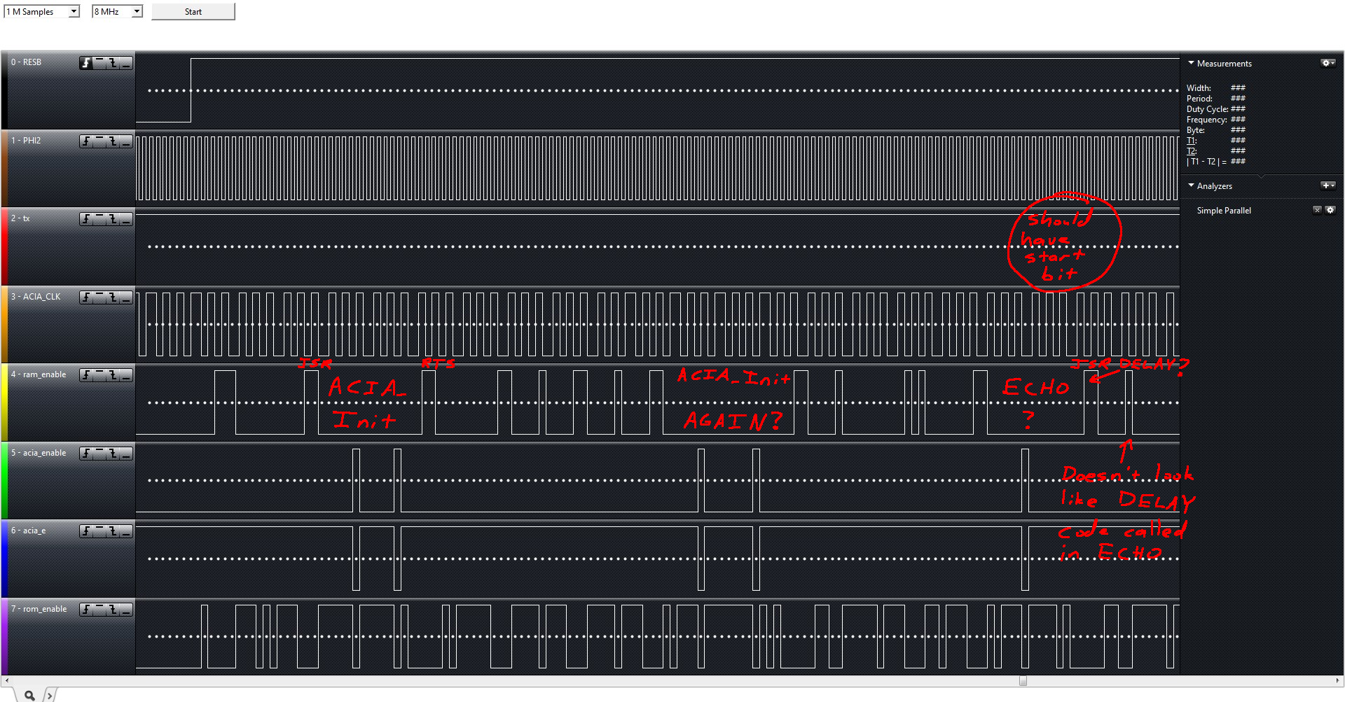

PostPosted: Fri Jan 12, 2024 5:30 pm
Posts: 375
hoglet wrote:
Of course, you do need a way to observe these signals, for example a logic analyzer or an oscilloscope. You really do need one or other of these, othewise you are just fumbling around in the dark.

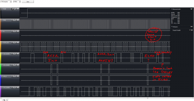

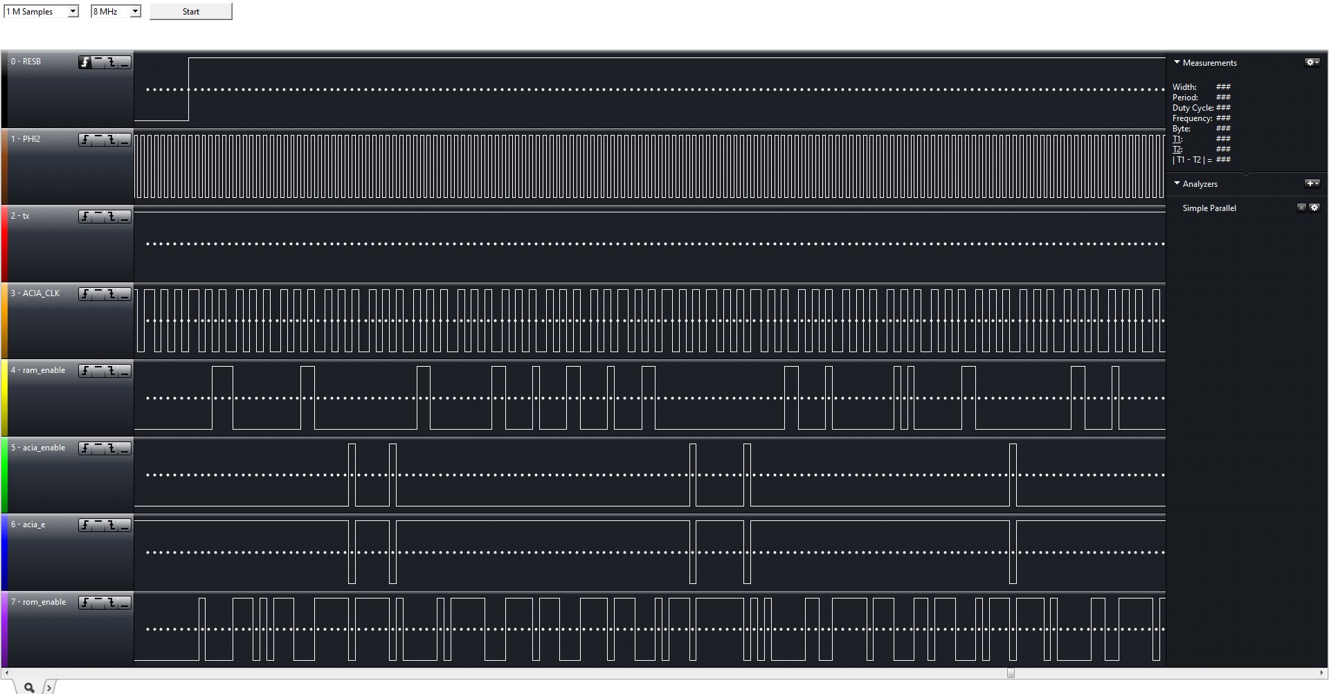

Okay, I ran those signals through my logic analyzer. BTW - now I have nothing from tx? :?
Curious to know what your thoughts are.
Jonathan
PS As you can see, I have a nice, clean 4mhz signal into PHI2. I slowed it down for the purposes of the analysis.
PostPosted: Fri Jan 12, 2024 8:36 pm
Posts: 255
I see what looks like ACIA_Init being called, although it seems too early to me. Is this the xboot_beta_HW16.asm or xboot_beta_HW16_2.asm file in your repository being used? There are fewer clock cycles than I would expect for either one as they share the same RESET code.
The ACIA_Init signature is the ram_enable spike for two cycles (JSR is pushing return address on the stack) followed by the two acia_enable spikes (ACIA_Control and ACIA_Command being loaded with values) and then another two cycles of ram_enable (RTS is pulling return address off of stack)
The odd part is that I see this same signature later on in your capture when I would be expecting a single acia_enable spike from ECHO who is sending the data followed by a very long Delay. My first through is that perhaps your RAM is not working and you don't come back to the correct place from your first JSR to ACIA_Init, or perhaps your 65816 is getting reset again (although I don't see the reset signature again), but it still could be some other issue.
Later I see an acia_enable access that could be ECHO, but ECHO calls Delay right after sending the byte to the ACIA, and Delay pushes three registers right at the beginning, so I would expect to see ram_enable pulses 3-5 cycles apart and there is only a single pulse near the end of the trace and too many clocks with no ram_enable for it to line up with that code.
File comment: Attempt (failed) to follow trace through instructions
If the above asm files (I'm not sure if there is a difference between the two) are not what you are using, please provide the software you are using (otherwise, I'm wasting time fumbling around in the dark). You may even want to create a "minimal example" that doesn't have all of the SWEET16 junk in it - just init the ACIA and send a character over and over (or even just once). The fewer instructions/clocks to get to the problem, the better.
There should be a "signature" of actions at various clock cycles for each assembly instruction, and I'm not seeing things line up nicely between the code and your hardware. It could still be a signal integrity problem, such as an issue with your level shifters, and the scope will help see those kinds of issues.
I see enough to have a little more faith in your emulated ROM and your 65816 (eg. your processor is trying to run code), but I'm not convinced your RAM is working properly and it could be an issue with your level shifting. I also don't see your code setting up the stack pointer, but I'm not sure if that's important or not.
I'd love to see you cut your assembly down so small that the running will entirely fit in your trace.
