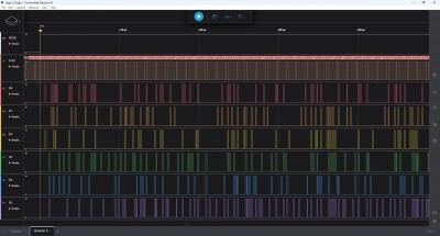

Okay, I ran those signals through my logic analyzer. BTW - now I have nothing from tx? :?
Curious to know what your thoughts are.
Jonathan
PS As you can see, I have a nice, clean 4mhz signal into PHI2. I slowed it down for the purposes of the analysis.

I see what looks like ACIA_Init being called, although it seems too early to me. Is this the xboot_beta_HW16.asm or xboot_beta_HW16_2.asm file in your repository being used? There are fewer clock cycles than I would expect for either one as they share the same RESET code.
The ACIA_Init signature is the ram_enable spike for two cycles (JSR is pushing return address on the stack) followed by the two acia_enable spikes (ACIA_Control and ACIA_Command being loaded with values) and then another two cycles of ram_enable (RTS is pulling return address off of stack)
The odd part is that I see this same signature later on in your capture when I would be expecting a single acia_enable spike from ECHO who is sending the data followed by a very long Delay. My first through is that perhaps your RAM is not working and you don't come back to the correct place from your first JSR to ACIA_Init, or perhaps your 65816 is getting reset again (although I don't see the reset signature again), but it still could be some other issue.
Later I see an acia_enable access that could be ECHO, but ECHO calls Delay right after sending the byte to the ACIA, and Delay pushes three registers right at the beginning, so I would expect to see ram_enable pulses 3-5 cycles apart and there is only a single pulse near the end of the trace and too many clocks with no ram_enable for it to line up with that code.
If the above asm files (I'm not sure if there is a difference between the two) are not what you are using, please provide the software you are using (otherwise, I'm wasting time fumbling around in the dark). You may even want to create a "minimal example" that doesn't have all of the SWEET16 junk in it - just init the ACIA and send a character over and over (or even just once). The fewer instructions/clocks to get to the problem, the better.
There should be a "signature" of actions at various clock cycles for each assembly instruction, and I'm not seeing things line up nicely between the code and your hardware. It could still be a signal integrity problem, such as an issue with your level shifters, and the scope will help see those kinds of issues.
I see enough to have a little more faith in your emulated ROM and your 65816 (eg. your processor is trying to run code), but I'm not convinced your RAM is working properly and it could be an issue with your level shifting. I also don't see your code setting up the stack pointer, but I'm not sure if that's important or not.
I'd love to see you cut your assembly down so small that the running will entirely fit in your trace.
