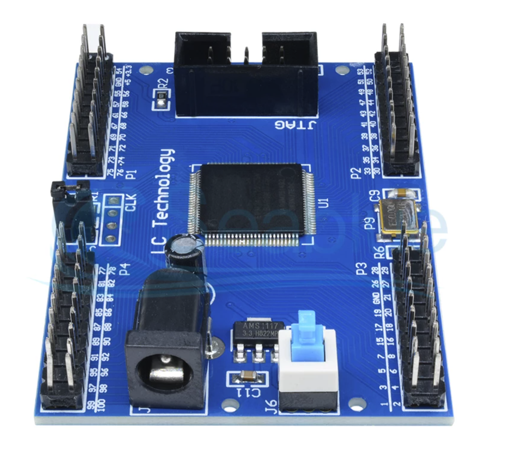

I was intrigued by Bill's recent posts on CPLDs, and a few weeks ago I came across this developer board based on Altera's Max II. It was so inexpensive—I think I ended up paying $10 CAD shipped for mine—that I figured it wouldn't hurt to try and see what could be done with it, and so I ordered one. It arrived after a few weeks, but I was busy with work, and didn't really get around to trying it until last weekend.

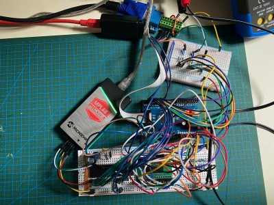

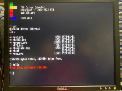

I had no idea to expect (and really no expectations that I would be able to do anything useful with a $2 chip), but I was surprised to find out how much capability can be squeezed out of these devices. In particular, I was surprised by how much more quickly one can prototype a circuit, especially using Verilog. Once you get past the fact that it looks like C but doesn't quite behave like it, it's remarkably easy to build what circuits that would be pretty complex (at least for me) implemented using only discrete logic.
In any case, I started with blinking a LED, and somehow ended up implementing the VGA controller that I've always wanted for my SBC :-). Here's a final list of features:
  • Completely asynchronous operation; you should be able to just bitbang data into the registers at the typical speeds supported by most hobbyist projects.

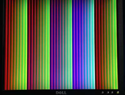

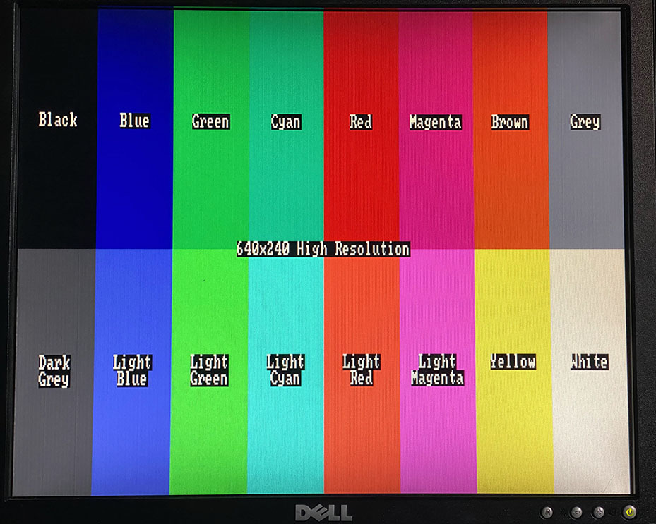

  • 320x240 resolution at 8BPP (RRRGGGBB), rendered as a 640x480 @ 60Hz standard VGA signal.
  • 640x240 resolution at 4BPP “high res” mode using a CGA-like palette, capable of 80x30 text (though you will have to implement the text rendering in software).
  • Hardware accelerated vertical scrolling (handy for text displays).
  • Toggable self-incrementing X coordinate for faster data transfers.
  • Active-low interrupt when entering the non-visible area at the bottom of the screen.
I uploaded a demo of it running to YouTube (this is currently powered by a PIC18 running at 64MHz, because I didn't have a working 6502-based SBC handy), and have attached a copy of the schematic below (though, to be honest, it's not that interesting… all you really need is the Max II, 128kiB of RAM, and a handful of passives). Here are some photos from the output, which is rock-solid and flicker-free—and looks much better in person:

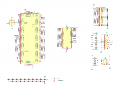

I put the entire source up on Github in case this comes in handy to anyone. The Max II is technically obsolete, but easily obtainable from AliExpress, even with all the FPGA/CPLD shortage going on, and it costs a pittance. The design leaves enough resources unused (about 15%, and roughly 20 pins) that it should be possible to use the extra room for glue logic or other applications to reduce the chip count in an SBC design.
To wit, I have ordered some PCBs from JLCPCB; the design ends up being small enough that I was able to splurge on a 4-layer board, so I'm looking forward to seeing how well that works when it gets here. In the meantime, I have built an even-worse-than-usual rats' nest using the development board:
I would love feedback on the design—I'm sure there are plenty of ways to improve it (and probably a few bugs). In particular, I couldn't get the MPU interface to work bidirectionally… if I add functionality to expose data through the bus, the CPLD always ends up picking up a bunch of garbage when a write occurs, even though I wait a full clock cycle for the signals to stabilize. This doesn't matter too much—I don't really need the read functionality at this point, but it nags me that I can't understand what I'm doing wrong, and I suspect that I may one day want to add the ability to send data back to the MPU anyway.
The interface really does all I wanted for my SBC; in particular, I was keen on supporting 80x30 text with good scrolling performance, which I was able to achieve by using a hardware offset, so I think I'm going to stop here and focus on interfacing with my computer instead. In the future, I am keen to add some more fun functionality, like sprites and proper text-mode support, but for that I will most definitely need a more powerful CPLD (possibly with built-in memory, because interfacing with an external chip was not easy). I welcome ideas for more features!

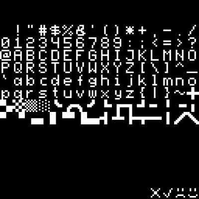

PS: If anyone knows of a good looking 8x8 font that I can use, I would be very grateful for a pointer to it. Though I am happy that I was able to find a free one to use, it doesn't look great in either 40- or 80-column mode!

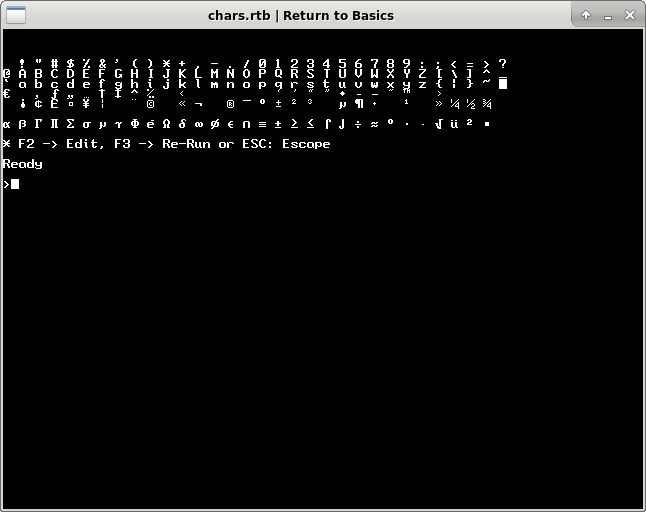

This is the 8x8 font I use:
https://unicorn.drogon.net/systemFont.h.txt
I'm sure it would be easy to mash that into anything you like - the important bit is that the vertical bars are double width where possible which makes it very visible on TVs (not that that's an issue for you, here though - read this for some details: https://retrocomputingforum.com/t/8-bit ... esign/1097)

Thanks, Gordon! Your font looks tons better. Cheers!

very interesting! 192 Macrocells and it directly supports Verilog without the need for POF2JED like the ATF15xx series does.
though it doesn't appear to be sold anymore (atleast on mouser) and other sites like UTsource it costs between 4 and 6 EUR/USD per IC.
another downside is that it only runs at 3.3V maximum, so you would need to build your whole system around that or use Level Shifters.

for an ASCII compatible character set i have just been using this:

either way i hope to see more experimenting you do with this board, maybe you could try a sound chip, since i've never seen a CPLD based custom sound chip for 65xx systems before

You can find it on Aliexpress for ~2-3 USD per—of course, with the usual caveat of buying things from Aliexpress (though I will say I haven't had much trouble with them at all).
The 3.3V supply does present a bit of a problem, but I suspect that would apply to most CPLDs/FPGAs of decent capabilities; I'm going to try interfacing to my SBC through a TX0608e, but I'm also noodling with switching over my design to 3.3V just to see what the tradeoffs are in practice.

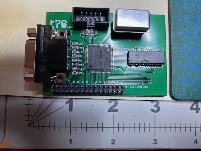

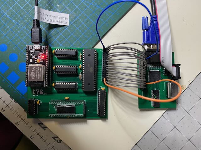

Time for a quick update: I finally got the PCB for my reference design, and it looks pretty spiffy:
Soldering the CPLD to the board was quite the adventure… the first attempt ended up releasing a bunch of magic smoke, but the second time around I took care to avoid shorts and it worked right away. I was silly enough to place the decoupling caps on the other side of the board—a mistake that I'm not going to make again, because they're a pain. Also, I think that I should make a version of the board that acts as a shield that connects to the MAX II development board, which should eliminate the need to solder SMDs altogether.
I was pretty surprised to find out that the circuit worked right away… it only needed a bodge wire because I had forgotten to force the RAM's chip select line low. It took a little doing to interface it with a version of my 6502 SBC running at 3.3V, but only because I had forgotten to qualify the chip select line with PHI2, much like you have to do when interfacing to RAM.
Once I figured that out, it worked like a charm with the 6502 running all the way up to 13MHz (at which point my SBC ceases to work for reasons that I have not yet investigated—I suspect that the video interface can handle faster clock speeds). Here it is connected with some temporary wires while I await angled pin headers from China:

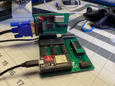

I also managed to make the interface's registers readable (previously, you could only write to them), although I have yet to bother enabling read access to the onboard video RAM.

A final update on this project: I have added support for reading the video RAM and for blanking interval detection/interrupt. This makes the interface with the host computer bidirectional and allows for smooth animation.
I still plan to create an advanced version with a customizable palette and support for sprites, but I'm going to call this version of the project complete for now—if for no other reason that I have used all but one of the available macrocells in the CPLD :-)
The interface works really well, incidentally. I was able to test it with my SBC running all the way to 20MHz and it's nice, responsive, and completely glitch-free (though, in all fairness, my code isn't yet fully optimized).
Just for fun, here are a couple shots of the card plugged into the SBC, and some 80-column text output from the SBC to my VGA monitor, using Gordon's most excellent font (thanks again, Gordon!).
67485268540__9B2FAE27-9573-49CC-BD70-4969934E67CC.jpeg [ 88.26 KiB | Viewed 40442 times ]
