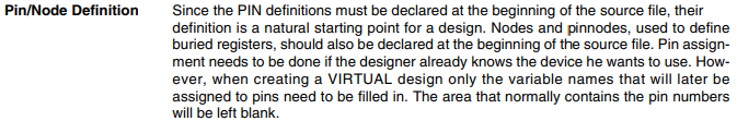

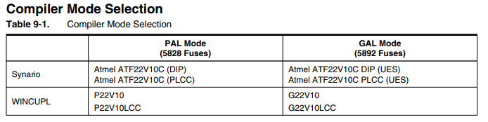

Thanks! I'm new to CPLD's. I'm curious; How can you tell if a device can contain a particular logic function? I mean, it's easy to determine whether the number of pins is sufficient or not for outside operation. But how can you tell that the particular implementation will "fit" in a certain device? Reading the datasheet tells me I have 10 macrocells - whatever fits in a macrocell comes with experience I guess?
EDIT:
Hmm yes, the compiler mode is present in the datasheet as you say like this:
But WinCupl also needs "pinnodes", which according to the manual should be defined as well:
Any guess where I can find the correct number of pinnodes for this device?
EDIT 2: I'm an idiot. Of course it doesn't "need" pinnodes - it's up to me to use them if I want to *facepalm*. Nothing to see here, move along ;)
Pin nodes are logic nodes that are "buried" and are not attached to physical pin. Pin nodes may be used in a variety of ways, such as to declare a register that maintains state. For example:
pinnode   = [blatch0..3];                         /* bank address registers               */
The above defines is a 4-bit register used to latch the 65C816's bank bits. Later on, the register is used thusly:
[blatch0..3].LE = bavalid & !wsext;               /* open latches, unless in wait-state */
[blatch0..3].L  = [D0..3] & bavalid & !wsext;     /* capture bank, unless in wait-state */
SPLDs (GALs) generally do not have buried logic capabilities, which means you have to use actual pins in place of pin nodes, which has both performance and logic effects. If a logic path requires the use of a physical pin as a node then total propagation time will be greater than the device's advertised capabilities—vendors specify prop time as pin-to-pin. Also, such a pin is no longer available as an output, unless the intermediate steps of the logic being implemented can be externally used.
If your logic is going to be of any complexity and maintaining state is part of it you are better off using a CPLD. If you attempt to declare a pin node with a device that has no support for it you will get a compile-time error.

Hi Risc,
atf22v10c.pdf
You tell WinCUPL which device you are using in the header of your design file. It's all explained in the help files that are part of WinCUPL. The correct device is g22v10.
is a useful starting point but I've found that the Atmel datasheet kinda assumes you know what a 22V10 does. I've found the Lattice datasheet to be a little more helpful http://web.mit.edu/6.115/www/document/gal22v10.pdf.
The macro cell itself is really just a D type flip flop plus a couple of multiplexers. The multiplexers allow the output to be either a combinational or sequential function. Lattice datasheet pg. 3 makes this clear and pg. 4 takes you through all the possible configurations. Note that these are selected during programming and cannot be changed once the chip is in use. The Atmel chip functions the same, just not as well documented.
