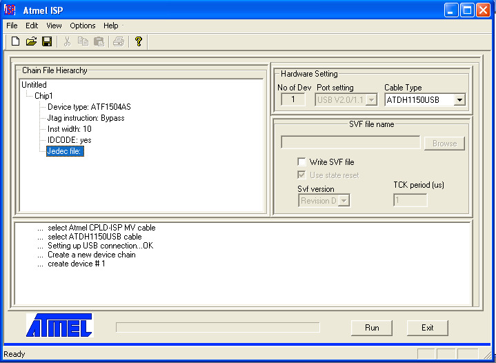

after many suggestions by BDD I finally took the step and decided to go with those fancy ATMEL CPLDs available for 5V and as expected I start having some questions. But first let's talk about my environment. So far I have some of these PL-44 http://www.futurlec.com/PLCC_Adapters.shtml the ATMEL USB progamming cable from here http://www.kanda.com/CPLD-Programmers.175.html. As always deliveries from UK to CH are a pain ... they are expensive and take a long time, not only because of parcel service but mostly because of swiss customs, but I wanted to get a genuine one and not a fake from china. At the end it cost me the double as listed on the vendors page. But that's not his problem, thats mainly because Switzerland is not EU :roll: . And last but not least a few ATF1504AS10JC44 to play with. I have installed ATMEL ISP and it recognizes the cable.
File comment: ATMEL ISP successfully detects programming cable

And I now I find my A3 and the other signals :D. I successfully programed and verified the chip and now I'm debugging my design. So far I found that the way I generate clock for internal flip-flops is somewhat not correct, I wanted to qualify it with PHI2 but it seems I screwed up the equation (I don't show it now, because I'm sure the mistake I have here is so basic that I would be ashamed to ask, I need to fix that myself). As you see the design uses all but one pin with the JTAG pins unused. So I can always go back using ISP.
So far what I can say, everything is straight forward and I spent much less time than anticipated to get this far. Now I just have to order the TQFP-44 versions and solder them on my DIP-48 adapters to make efficient use of bread-board space.
I have one question, once you use the TDI, TDO, TCK and TMS pins for your design you can't program the chip using ISP anymore? Is that correct? What do you do then? Is there a way to at least clear/reset the chips without a professional (aka rather expensive) programmer?
cheers
Peter

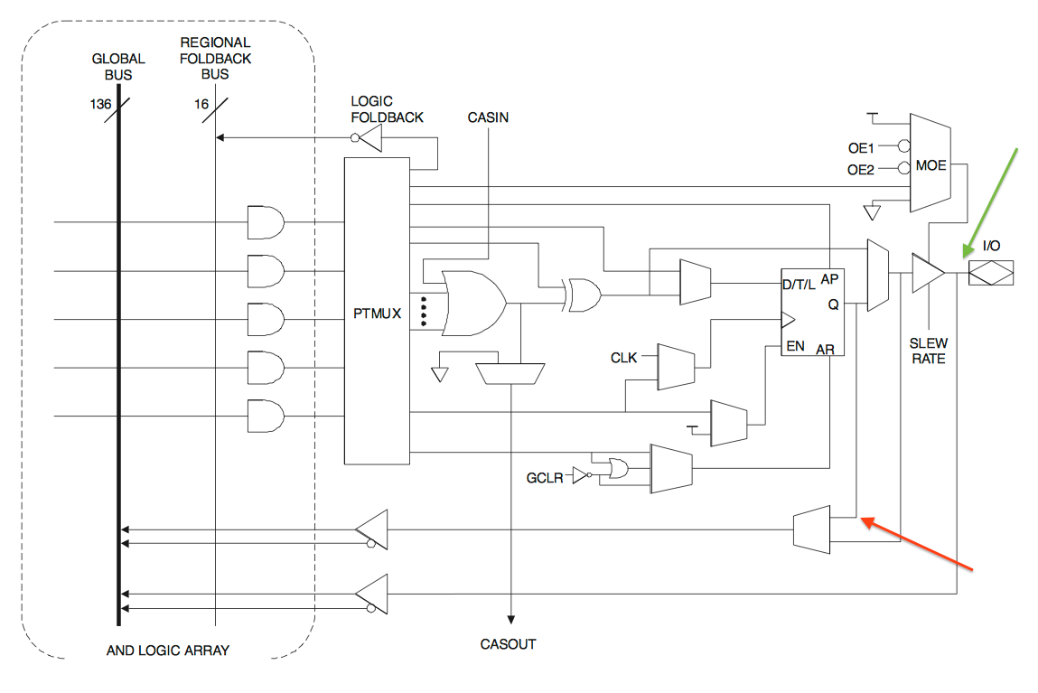

I have some questions and "google" was no help at all. It seems that information about how to design a ATF1504/8 CPLDs in WinCUPL is rather scarce. Anybody knows of some more elaborate documentation or books? I really would appreciate more information. So back to my question.
I want to create an addressable latch that can be set and reset by addressing two memory locations. At the same time I want to be able to use the state of this latch internally but I also want to be able to read the status of the latch externally via a tri-state output. So far only this design is successfull
PIN   1  = !RES                    ; /*                                 */

Hi Garth,
the first I get with your search terms is the download page for WinCUPL from ATMEL. I searched a lot in various search machines and any combination of cpld, atf150xx and wincupl shows more or less the same information.
File comment: Macro Cell
Perhaps a picture of what I want shows what I want to achieve. I have a registered cell and I want to feedback the output Q (red arrow) to be used internally but still I want to be able to read the state of the register via the tri-state buffer (green arrow), which of course requires that the MUX between the tri-state buffer selects the path from Q.
Generally speaking, I'm looking for a manual that explains which extension must be used to select a given path or set a specific MUX. According to the help this is the default. But it's not working. And the extension to force the default (.dfb) generates a warning.
Peter

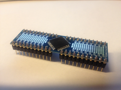

to save real-estate on my breadboards and to have my favorite IC form factor (DIP) I have create a few of these for my projects that use a ATF1504AS CPLD.
after various tests and small projects (some sort of "Hallo World" and "Blinkenligths" for CPLDs) I will now start with a new SBC using one of the DIP-48 format CPLDs. Surprisingly these are quite powerfull and a full decoder with memory mapping and ROM overlay logic can be easily put into one single ATF1504AS.
cheers
Peter
