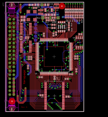

As an FYI, Jason Flynn over at Stardot has designed a small board with an LX9 FPGA and up to two 16-bit wide RAMs, and has taken enough orders to run up a batch of assembled boards.
The board is designed for use as a second processor to a BBC micro, but that means it has a byte wide memory mapped interface (at 5V) which should be suitable for any 8 bit host. Indeed, with different code the 40-pin connector could be rejigged to provide, for example, a serial connection instead.
Might be of interest to anyone to sign up for a second production run, or good as inspiration.
Of course, the 32-bit wide memory interface with 2 Mbyte of memory looks interesting from a 65Org24 or 65Org32 perspective. Or even a good old 65Org16!

Presently three types of CPU core are supported and tested (implemented in the FPGA):
"Matchbox sized 6502 / Z80 / 6809 Co Pro"
and there's interest in a PDP-11 core too.
It's only recently come to life, so no reports of very fast clock speeds yet.
