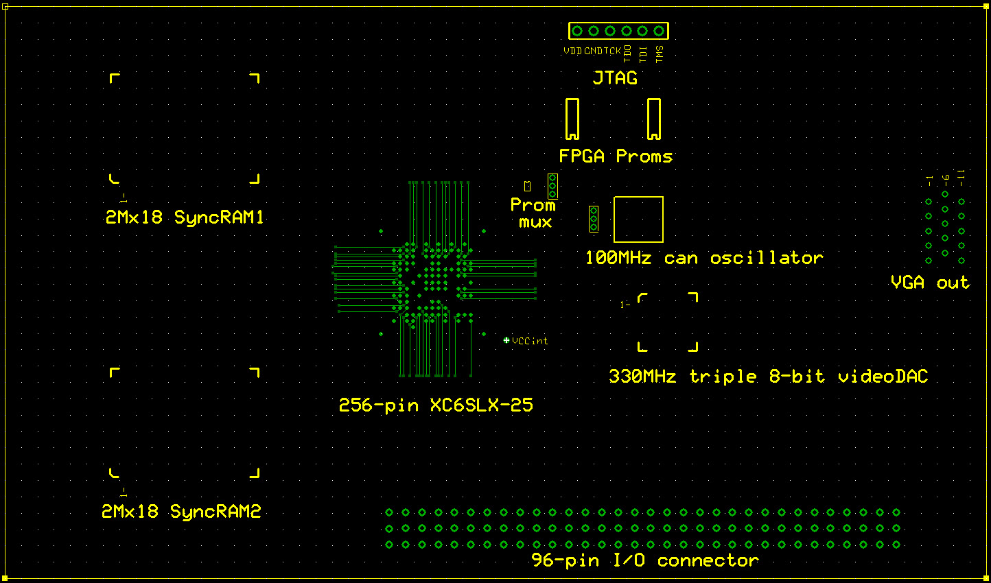

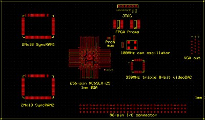

With a 256-pin 1mm BGA Spartan 6, I can still successfully route 149-pins out of the device that's available for user I/O in initial IC placement. 100 pins on top (red) and 49 on the bottom (green).
Each 2Mx18 SyncRAM needs:
21 address
18 data
8 control
Multiply the total by 2 for the 2 SyncRAMs, and the result is 94 pins are needed to interface the SyncRAMs to the FPGA.
Add 17 pins for the videoDAC and we're @ 111 pins total. Still 30+ pins of the FPGA to utilize some board space.

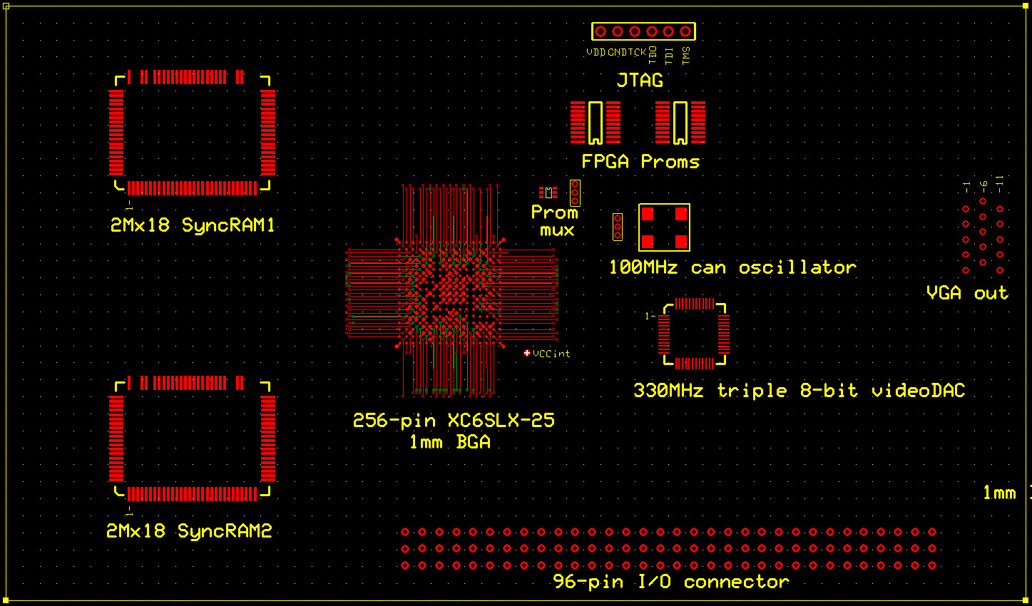

This is more like what the layout will look like.
The design is from an earlier chapter of the K1 Controller Board development where the XC6SLX25-3FT256 was to be the FPGA controller of choice. I started re-developing the layout for 3.8"x2.5" these last few days. Looks to be feasible:

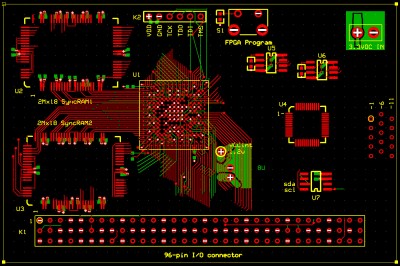

Small update: 4-layer MiniBoard service isn't going to work. The design in the pic above already has 331 holes, only 19 left...
Not too bad of a situation though: The board will still remain the PVB original size of 3.8"x2.5",but using the 4-layer ProtoPro service I'll have an additional 300 holes which should be plenty to finish this PVBV2 design. The price will double to $200, but I'll get 4 boards instead of 3.
With memory parts I can salvage from 4 original PVBs, I should be able to have 2 PVBV2's up and running pretty quick, without spending too much.
Without going to the labor to show the progress of the board design, I'll just post the final version right before placing the order which will hopefully be in less than 2 weeks. There will be no feature creep on this design! Also, I'll post a block diagram of 1 PVBV2.

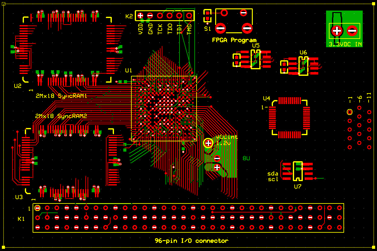

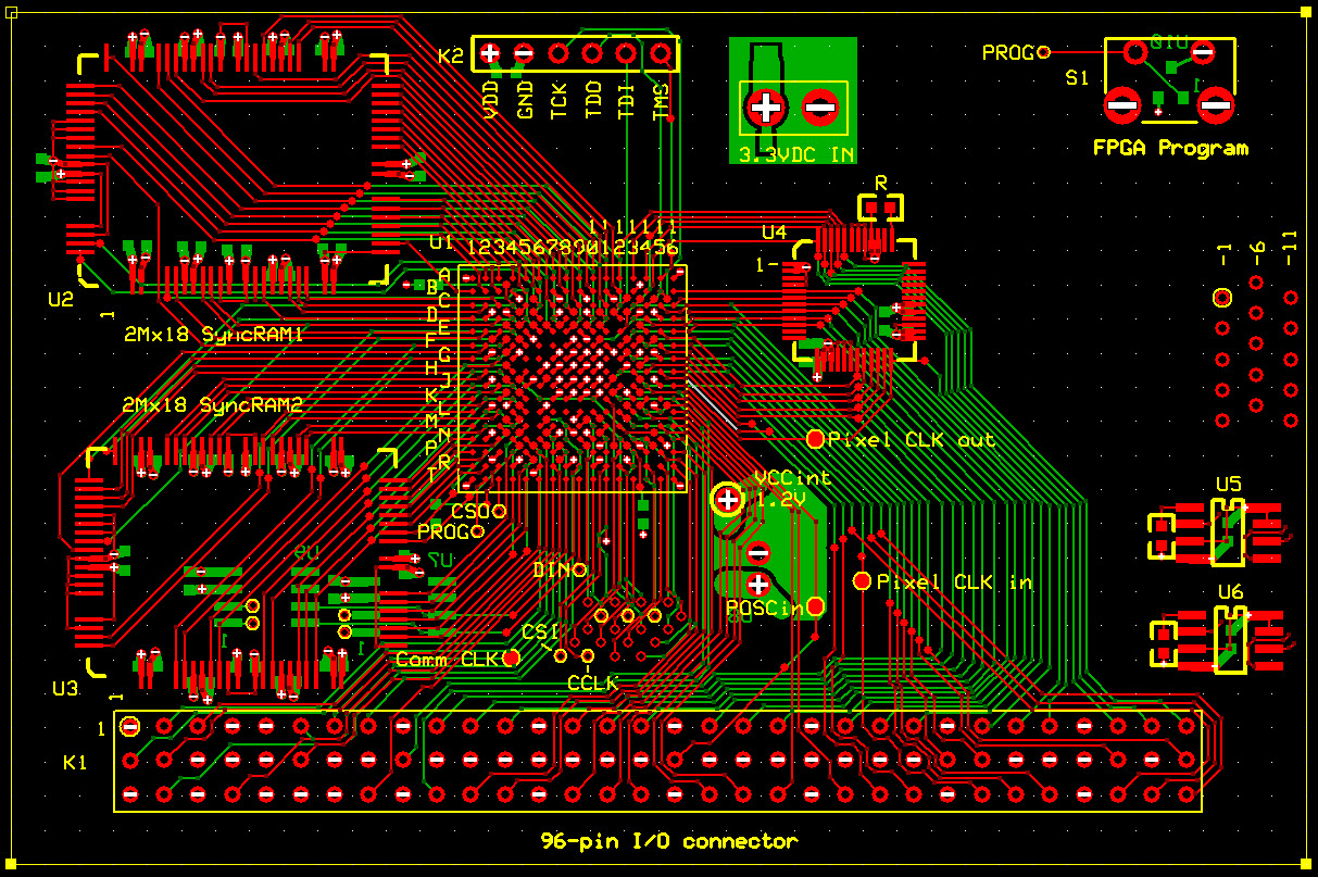

Progress has been made on the board layout since Dec 13th. Nice and tight on 3.8"x2.5" 4 layers.
A few signals will have to be routed by manually soldering in 30AWG (common wirewrap) from point A to point B. These are for some low speed signals, like the Program button (S1) to FPGA (U1), but also some of the higher speed signals from the FPGA SPI FLASH PROMs (U5,U6).
Also, just above the 96-pin I/O connector are 20 signals present in an array of .031" vias. This array consists of 5 rows of 4 pins each spaced .1" apart horizontally, .05" vertically. They can be connected manually, i.e. by soldering wires to anything off-board or maybe to any of the 4 2 DS1085L (U7, U9 underneath) Programmable Oscillator outputs. The 3 vias in the array which are not labelled, but circled in yellow, are global clock pins. I couldn't let these FPGA pads go to waste just because the were unroutable!

It looks pretty nice EE, but the little engineer in my head tells me that your average trace length could likely benefit from rotating the FPGA and SRAM assemblage 90 degrees clockwise like so (rotating the actual chips 90 degrees as well):
... where OS stands for "other stuff".
I know, I'm a stinker for even bringing it up at this stage of the game, but that little engineer in my head wouldn't leave me alone!
