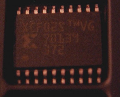

I am beginning to suspect that a batch of XCF02s and XCF01s I bought on AliExpress are fake. They are slightly different from the XCF01s I have that work (they are flat, the good ones have a dimple on top). I now have 4 CHOCHIs that just don't work.
The MINEO board would not scan via JTAG until I replaced the XCF02 with a good XCF01. I put another XCF02, and it's not scanning again...
I will try sticking and XCF01 again and see if I can actually configure the XC3S400. The '01 is not big enough to keep the bitstream, but is required for the JTAG chain to operate.
EDIT
Argh, the board is too fried now. I'll have to reflow another one.

enso
Posts: 904
Joined: 29 Sep 2012
Re: MINEO A - a 16-bit XC3S400 board
Post by enso »
Instead of the slight round indentation, they have a silksreened dot! Bastards.
I am getting more and more convinced that the XCF02s are problematic. I built another board. It does not scan with the 'XCF02'. It works without the XCF02 (at least IMPACT recognizes the XC3S400) after I short a couple of pins to complete the JTAG circuit. It also works with my tried and true XCF01s (Both XCF01 and XC3S400 are recognized).
Aw, heck. That's the last thing I need to deal with.
EDIT: At least I have a MINEO board that may work! I'll have to scramble to make a bitstream to flash the LED...

Here is a pic of the fake chip. Note that there is no dimple, just a painted dot. Sorry about the quality of the image...
Here is a picture of what's likely to be a good chip:
