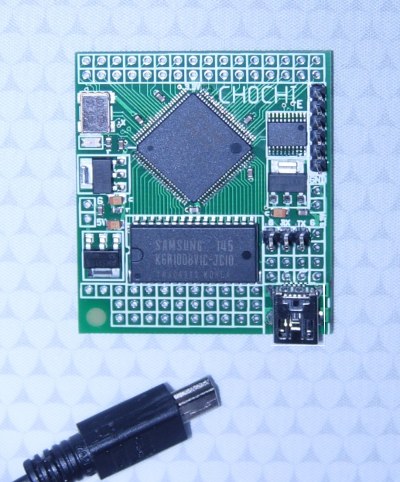

Ladies and Gentlemen, I have a dozen or so updated CHOCHE (rev E) boards with a USB connector for power:
The USB connector makes it much easier to use. There are 3 ways to power the board: USB, an unregulated 5V-6V connector, and a regulated 3.3V connector.

Lookin' good, man!
I can't tell for sure ... did you keep the blinkin' light for basic diagnostic purposes, or get rid of it out of lack-of-need?

The LED is still there, upper left corner just below the crystal. It is extremely useful - I can verify that the unit is programmed correctly.

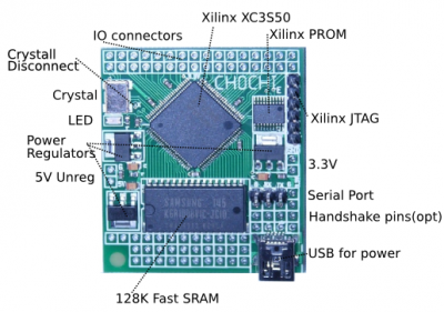

Here is a labelled diagram:
A couple of new additions:
-a crystal disconnect solder jumper (drop a ball of solder to disable the on-board crystal)
-2 normally unused pins (for 512K SRAM) are routed to 2 pads for optional serial handshaking
