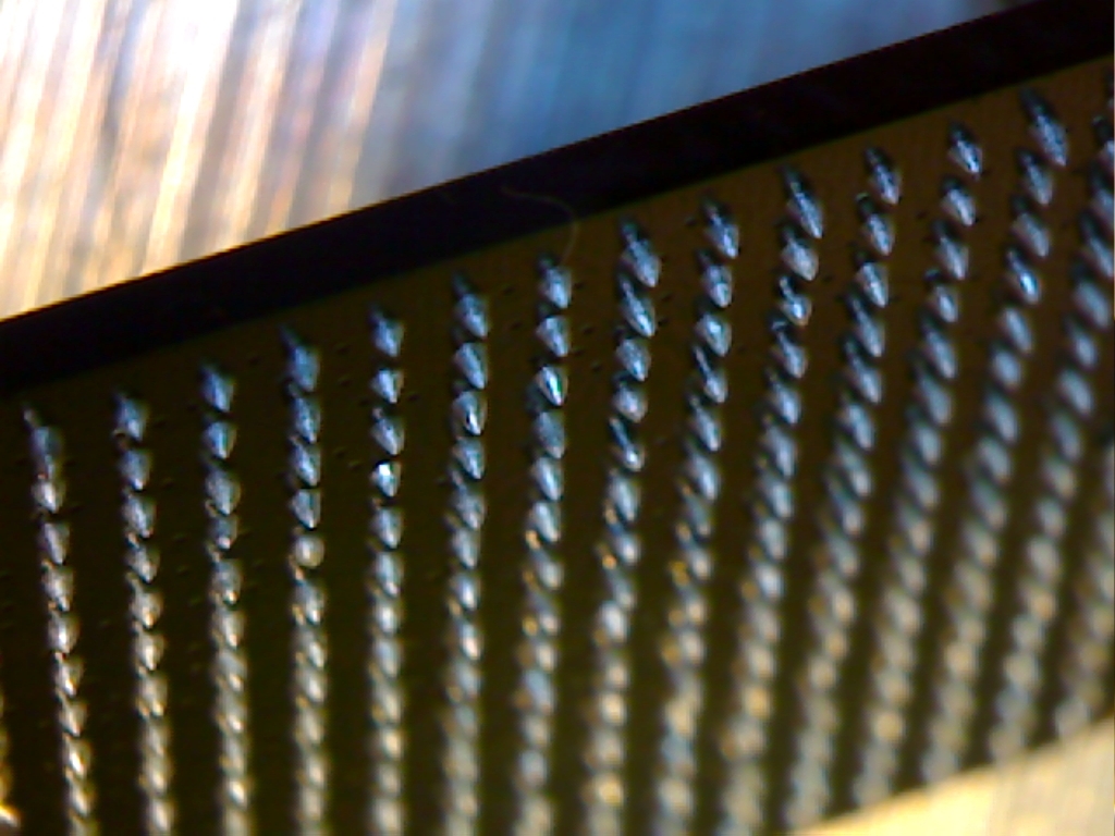

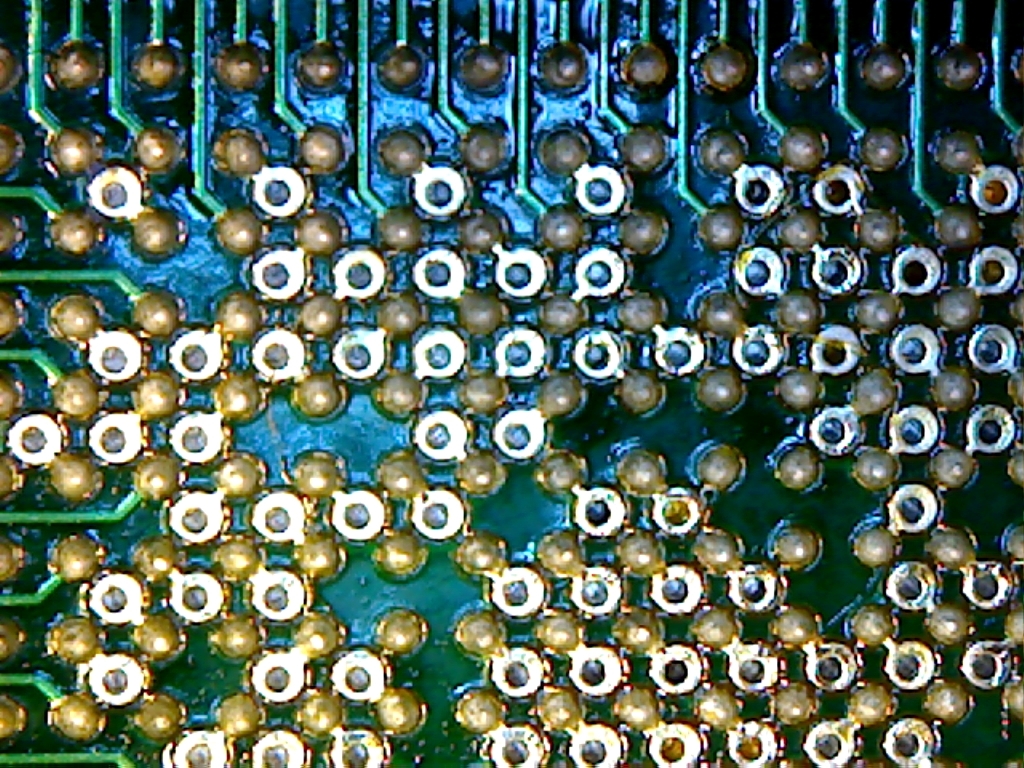

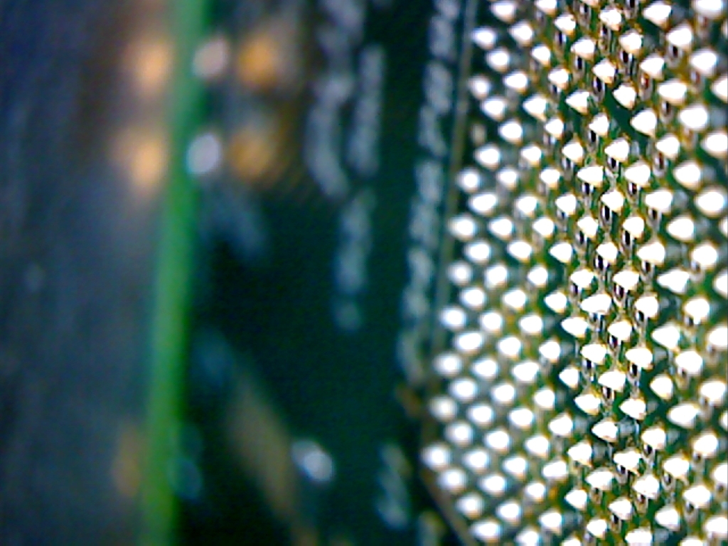

I decided the next best step would be to fire up the hotplate again and dismount the FPGA and see what it looks like underneath in order to try to see if all of the BGA pads 'took' the solder balls and to see if there was any intrusion by the solder balls into the via rings.
PostPosted: Thu Jan 15, 2015 11:10 pm
Gentlemen, I believe I have a victory here!!!
This USB 220x 5MP scope is indispensable!
My fears have been allayed. :D

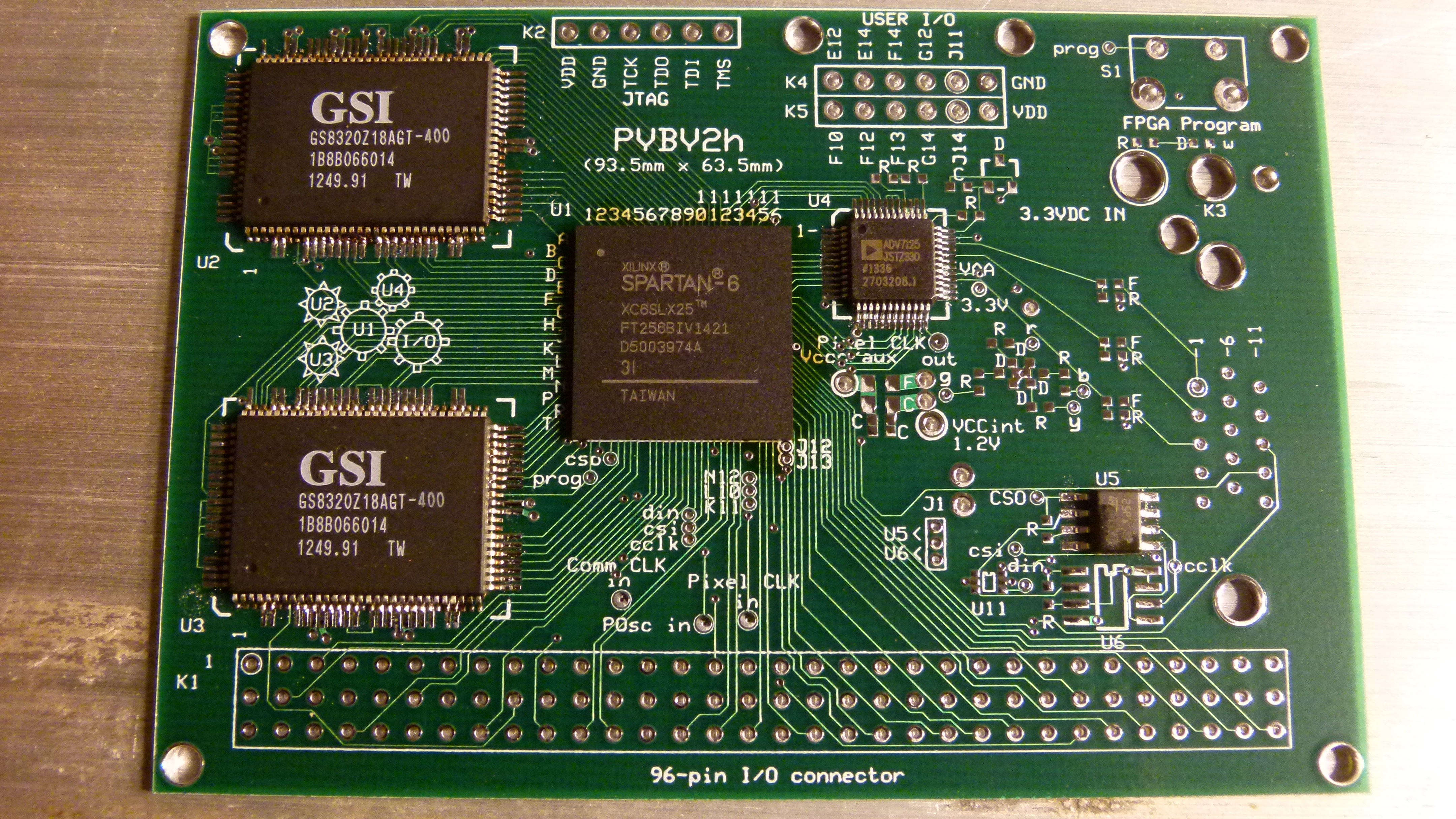

PostPosted: Fri Jan 16, 2015 12:36 am
Pre-hotplate pic with the smallest amount of solder paste for the QFP and SOIC packages. Still just flux for the LX25 Spartan 6, except this one is not Pb free. I dialed the hotplate back down to 235degC.

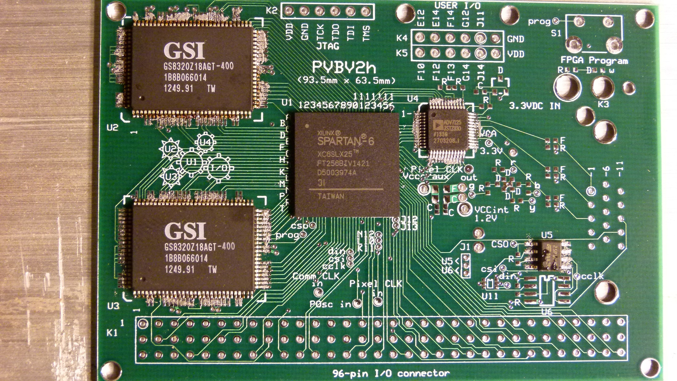

PostPosted: Fri Jan 16, 2015 1:13 am
Post hotplate pic.... Time for a short check.
PostPosted: Fri Jan 16, 2015 8:48 am
The solder didn't flow away from the pads - great news!

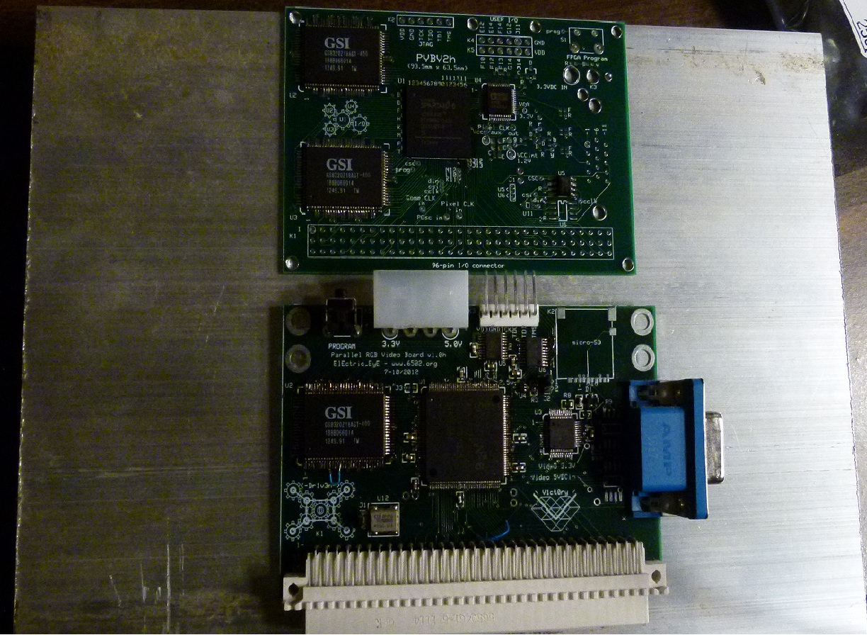

PostPosted: Sat Jan 17, 2015 1:58 am
For comparison's sake: The bottom board (PVB v1.0h) is fully operational, but it looks nasty with that old school (modified) IDE power connector and the 6-pin male SIP for JTAG is ugly.
PVBV2h is headed in a much better direction.
