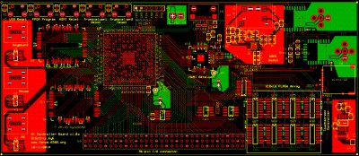

Gnarly it is, the SPI FLASH Array wiring. Added a pulldown resistor on the SCLK per PG.16 of the Micron datasheet. Still need to add pullup resistors on all the /CS lines coming out of the 74154. Gonna get more gnarly...
Also been doing some research into white noise generator circuits based on Zener diodes. Maxim seems to be the company that can supply the amplifiers. They even have an App Note regarding this from 2005, which I had posted a link to in the appropriate RNG topic earlier today. It uses a MAX2650 that needs a 4.5-5.5VDC supply. Unacceptable in my case.
I'll have to investigate improved IC's they have to offer since then, one's that can operate in the same frequency range but lower operating voltage... I hope to have a voltage doubler or quadrupler circuit based on a diode-based charge pump circuit I saw on Garth primer site. The Zener diode only needs 10mA, but the voltage has to be rather high. The Maxim AN uses 14v for the Zener supply.

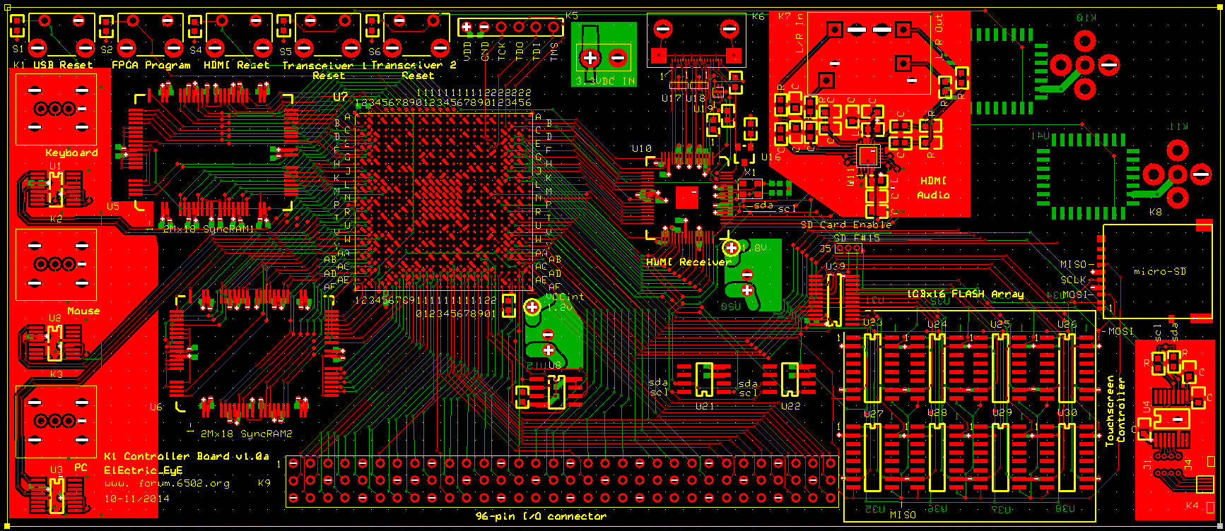

Also, the project has reached a certain number of holes again :!:
Damn they get you with the holes, while offering real estate. For EPCB 4-layer ProtoPro max holes is 650. The project currently has 726.
So now I have to go with their Production 4-layer service which will cost $318US for 2 boards. For comparison, 4 boards would cost $350US.
This project has the potential to be a $500 ball of wax that will melt in my hands and be a total waste if nothing works.
I don't like this, I will try to eliminate 76 holes for 4 boards @ $195

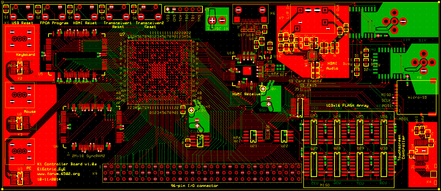

ElEctric_EyE wrote:
...I don't like this, I will try to eliminate 76 holes for 4 boards @ $195
Bah, I'm confident in this design and I will not waste time again conserving vias. I remember now that this was what took so much time for the final version of the PVB's. I imposed the strict via limit on myself only because I needed 6 PVB's and I could get 3x 3.8" x 2.5" boards for $98 using their Miniboard service. 350 holes is the limitation.
I will have to accept the fact that I will be using EPCB's 4-layer Production Service for this controller board. It is sort of a motherboard after all.
Not bragging here by any means, but I must begin to put everything into perspective in this final stage of the K1 Controller design. I must look @ Cost vs. functionality: Cost is No Object in my design because it is my hobby, but the functionality must be maximized for the $$$ spent.
Wiring for the 2 RF modules is almost complete, this is the last stage of wiring & parts placement. After this, checking, checking and rechecking + some trace optimizations. I expect 2 weeks for this.
Done:
Finalized the RF section.
Moved the HDMI audio section closer to the HDMI video connector and away from the RF section.
Added 2 more reset switches for each of the 2 900MHz RF transceivers.
Added 2 right angle thru-hole connectors for the antenna's mounted @ 45 degrees. An articulating base allows the antenna to swivel 90 degrees and rotate 360 degrees. Screw RP. :twisted:

I see a number of unused pins on the 96 pin I/O connector. Can you switch to a smaller connector and thus reduce the hole count?

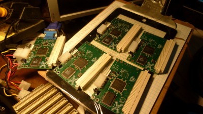

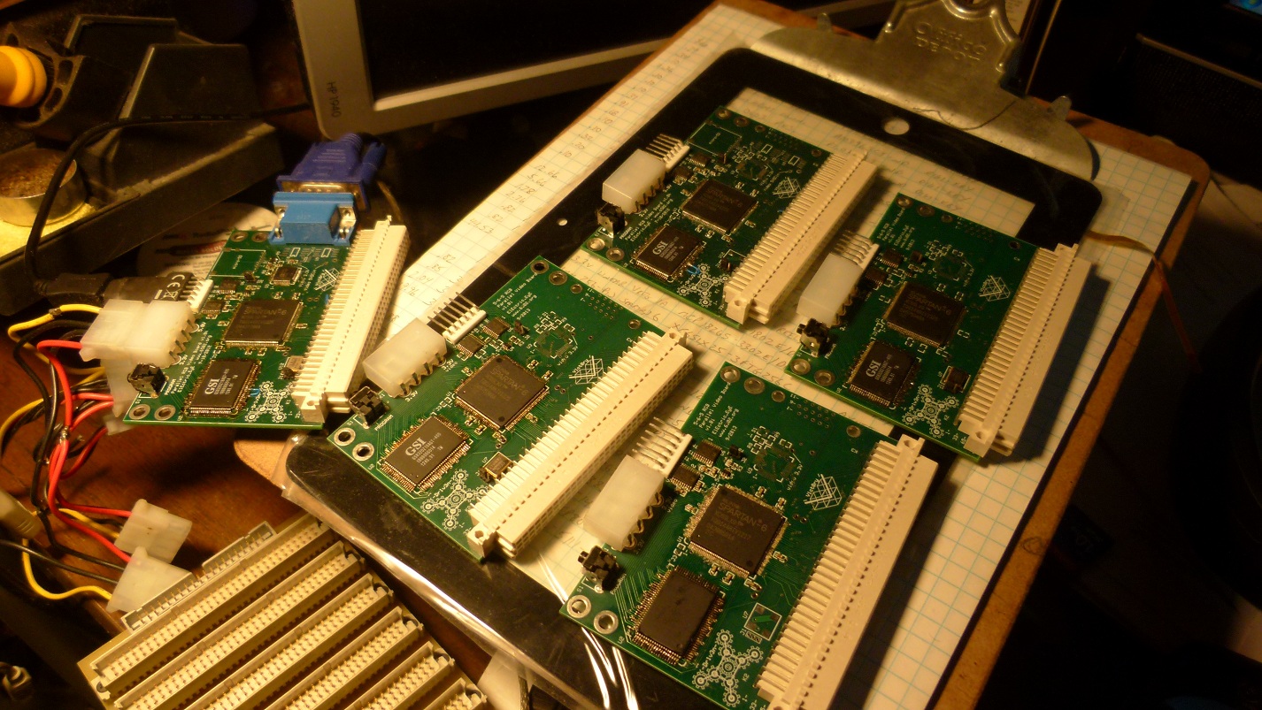

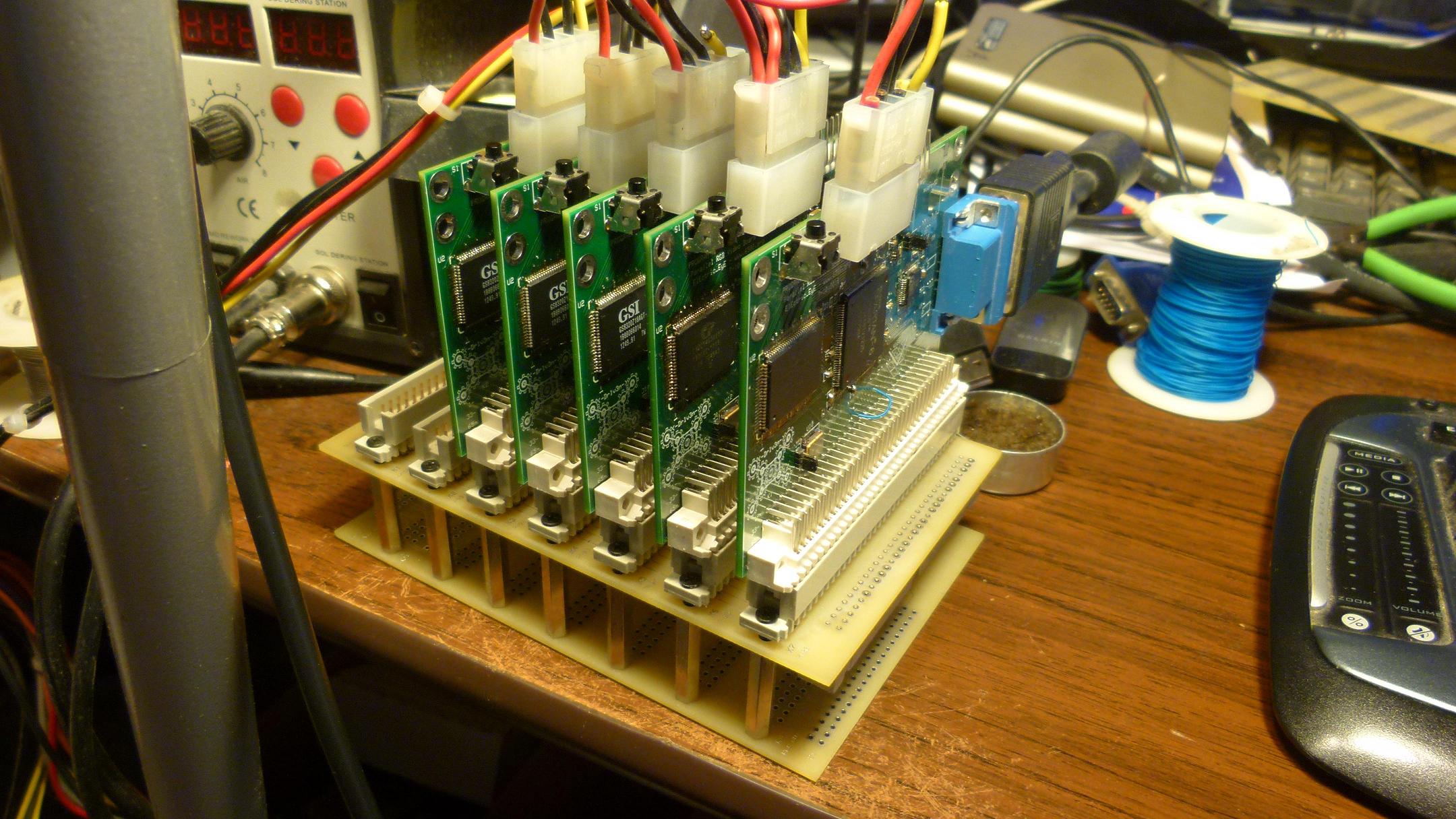

PostPosted: Mon Nov 24, 2014 10:38 am

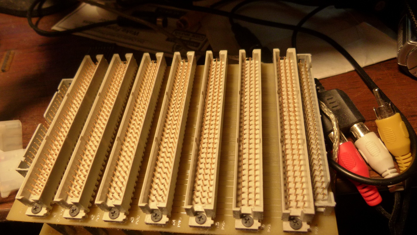

I was actually trying to find another 96-pin connector with < 1mm spacing. No luck. To answer your question though, it would be a waste at this point.
So far I have 5 PVB's. The bottom pic is the mainboard with the 96-pin backplane receptacles soldered in and 2 expansion connectors not soldered yet. Switching the 96-pin connector is not trivial task... I actually started the design around this connector as it fits nice on a 3.5" x 2.8" board.
The bottom pic shows (from the left):
An expansion board, not used.
K1
PVB1
PVB6
Expansion board. Output signals from PVB6.
The new PVBs will have 2 SyncRAMs each. Doubtful I'll be able to use the $98 service, but this is far in the future.

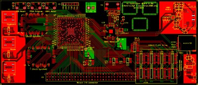

PostPosted: Mon Nov 24, 2014 10:55 am

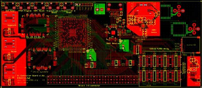

Burning the midnight oil. It is just about complete.

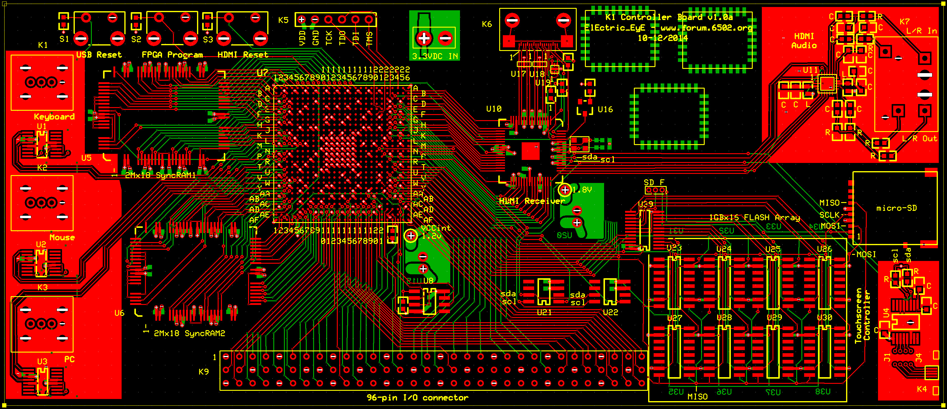

Hi EEye, you can get 96-way connectors with only 64 positions loaded. Perhaps other possibilities too. I don't know how that will fit with your pin assignments.
Impressive-looking system with all those boards in parallel though - a scalable collection of FPGAs with local memory should be able to do all sorts of things.
It's worth some experience points, though: you find yourself with a limit on holes, so your general approach of maximising functionality until the board is full needs a refinement: don't keep adding things until the board is full, but also keep an eye on hole count and stop when you've used up your hole budget.
Similarly, if you have a limited hole budget it means you need to take care when choosing connectors and architecting your interconnect. Serial connections and shared busses will use a lot fewer holes than point to point busses.
Engineering is all about budgets and tradeoffs!

...It's worth some experience points, though: you find yourself with a limit on holes, so your general approach of maximising functionality until the board is full needs a refinement: don't keep adding things until the board is full, but also keep an eye on hole count and stop when you've used up your hole budget...
You have a point there BigEd. I was aiming for filling in the 21sqin afforded by the 4-layer ProtoPro service. I had actually forgotten that I had a limitation of 650 holes with that service. When I used the portion of the PCB program that checks for errors and lets one proceed to order boards, I discovered I was over the limit.
Well now that this design is 99% complete, the hole count is at 798. Even if I got rid of the HDMI Audio section and the 1Gx16 SPI FLASH Array, I'd still have ~80 more holes to eliminate.
...Similarly, if you have a limited hole budget it means you need to take care when choosing connectors and architecting your interconnect. Serial connections and shared busses will use a lot fewer holes than point to point busses...
Each of the SyncRAMs have their own separate address and data busses because I'm trying to implement a strategy that does away with the snow effect by using 2 frame buffers for the video. I also have an idea for 2 65Org16's to read/write to the SyncRAMs depending on which SyncRAM is outputting data (to the videoDAC/actually the 1st PVB), while sharing data in zero page by the use of dual port zero page blockRAM. With the XC6SLX45, I may actually be able to implement the full 64Kx16 zero page dual port BRAM. Credit to you BigEd for the original idea!
...Impressive-looking system with all those boards in parallel though - a scalable collection of FPGAs with local memory should be able to do all sorts of things...
I'm very sure there's other possibilities, I can't think of any yet. Too busy, but feel free to express your ideas!
...Engineering is all about budgets and tradeoffs!
Always, but I try to never sacrifice performance!
I burnt on the board layout, gonna start with block diagram next.
PostPosted: Wed Nov 26, 2014 12:40 am
ElEctric_EyE wrote:
...I was aiming for filling in the 21sqin afforded by the 4-layer ProtoPro service. I had actually forgotten that I had a limitation of 650 holes with that service. When I used the portion of the PCB program that checks for errors and lets one proceed to order boards, I discovered I was over the limit.
Well now that this design is 99% complete, the hole count is at 798. Even if I got rid of the HDMI Audio section and the 1Gx16 SPI FLASH Array, I'd still have ~80 more holes to eliminate...
First, I apologize for quoting myself so often...
I'm still proceeding with ExpressPCB's 4-layer Production service.
This is going to be slight feature creep, but I've been looking at the SSM2604 Audio Codec IC. Since I'm in the 4-layer Production service now, the 21sqin board limitation is gone. The new limitations are 12"x14".
Keep in mind, I'm a fan of hi-performance audio. It seems today's hi performance audio is through a 24-bit ADC/DAC, although it is serial. This SSM2604 has 2 24-bit ADC's and 2 24-bit DAC's.
I'm blabbering. 1 final addition I would like to add is an expansion connector for digital audio out to another dedicated audio board. There appear to be enough pins on the northeast of the FPGA BGA that are presently unused. I would just have to expand the vertical length of the board in order to incorporate this connector.

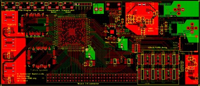

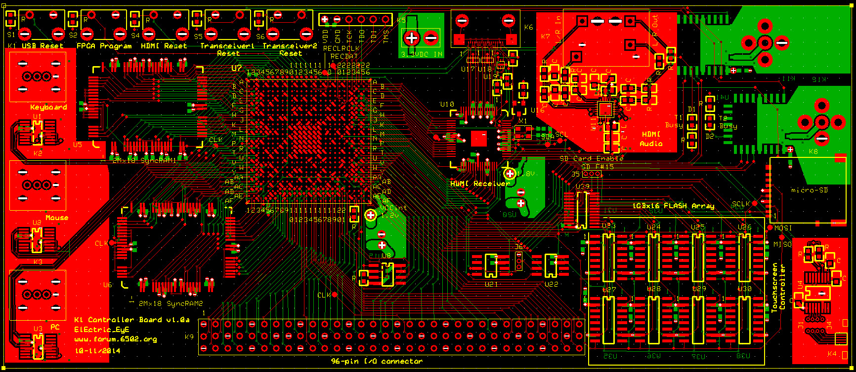

PostPosted: Wed Nov 26, 2014 1:17 am
Added some test points in the form of .050" BGA pads for critical clock signals, and just a couple of test pads for serial data.
Some other optimizations are in there as well.
Origin is at the upper left. In order to expand the board, first I'll have to change the bottom RH coordinate in order to expand the vertical length of the board. Then, I'll copy the entire design and paste it to the bottom RH. I don't need more than 1/2". When I do this, the connectors/switches on the top will have to be re-spaced in order to line up with the audio expansion connector which will be present on the upper RH.
