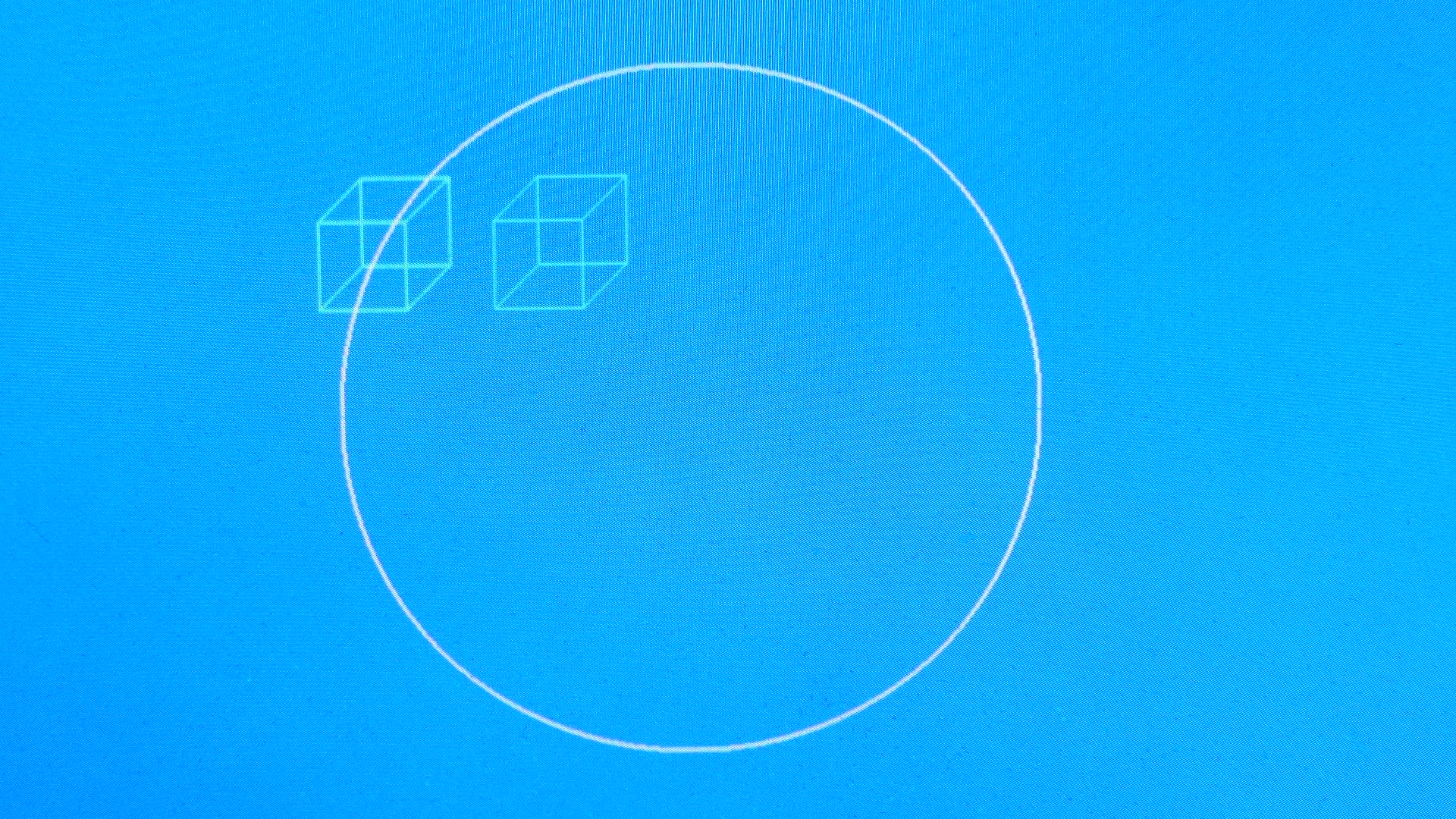

Success!
Maybe a register is needed to count the pixels so the cpu can tell me exactly how big of a blockRAM is needed. 2xpixR would just be an approximation.

Forgot the '2*' in
radiusError+=2*(y-x+1);
Now it is round, also I adjusted the HSize on the monitor to make up for the 1024x1024, non 4:3 ratio. Not sure why the cube on the right appears lighter on color, will have to investigate that.

Fixed now. Was a delay problem I fixed by shifting the SyncRAM clock and videDAC clock by 315deg.
Now the software sends line coordinates to plot the cube in hardware, sends 3 coordinates to draw the circle in hardware, and copy/pastes a section in software.
The points you see at the very top of the circle and the very left of the circle are the result of removing the multiplication in the algorithm. I put the multiply back.
Now to continue marching towards ellipses.

EDIT: Observations are: Changing slew rate from slow to fast had no effect. Changing drive strength from 4mA to 6mA had a large effect, as mentioned. Increasing drive strength from 6mA to either 8mA or 12mA had negligible effect. So, I continue forward with 6mA and more testing.
ElEctric_EyE
Posts: 3260
Joined: 02 Mar 2009
Location: OH, USA
Re: Concept & Design of 3.3V Parallel 16-bit VGA Boards
Post by ElEctric_EyE »
Another problem: I changed the FPGA output pins driving the videoDAC and monitor signals from 6mA to 12mA with no change. Maybe I need the impedance matching resistors now? The yellow is disappearing into the white. Should be green cubes on white background.
I'm done for today, thoroughly worn out!
