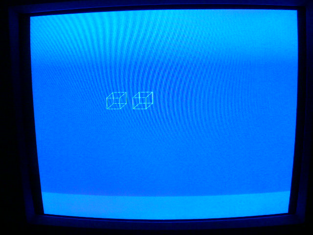

I am off for vacation for a couple days, but here is a pic of a plotted cube on the left, and a copy/pasted cube on the right.
Resolution is 1024x1024 pixel clock @84MHz. Not so square, but that's ok for now.
Also, I managed to program the FPGA PROM much quicker thanks to this tip I had missed before. Setting it to 22 works great. The highest setting of 26 works, but does not auto reset the FPGA.

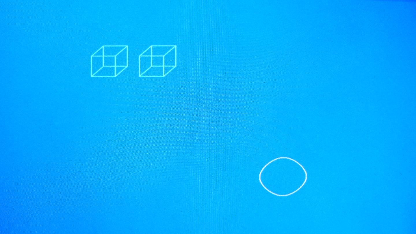

I'm thinking, after converting to Verilog, that this circle portion will add maybe 10 more states to the LineGen (which will be renamed to PlotGen). This module will act in a similar manner, in that 3 memory locations (blockRAM) will be written for XCenter and YCenter, and as soon as Radius register has been written to the plotting begins.
Ok, I'm off to write some code. :mrgreen:
Also this site deserves mention.
PostPosted: Wed Jul 10, 2013 1:55 pm
Success!
Maybe a register is needed to count the pixels so the cpu can tell me exactly how big of a blockRAM is needed. 2xpixR would just be an approximation.
