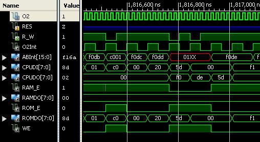

I'm noticing a problem I'm having using the JSR.
Looking at ISim when a JSR $F0DE occurs, I see $20 on the 6502 DI, indicating the JSR. Then I see the $FO then $DE on the 6502 DO during the next 2 cycles. During this time on the 6502 address bus I see $01XX, and the internal RAM is active getting this bad address. Not sure how to proceed...
 Post subject:
PostPosted: Tue Apr 19, 2011 4:51 pm
It looks like those 2 cycles are pushing the return address (F0, DE) on the stack, and that you forgot to initialize the stack pointer.
Try adding 'statename' to the waveform, and the 'S' register.

 Post subject:
PostPosted: Tue Apr 19, 2011 4:58 pm
Arlet wrote:
...you forgot to initialize the stack pointer....
How do I go about that?
 Post subject:
PostPosted: Tue Apr 19, 2011 4:59 pm
Like you do on a real 6502:
LDX #$FF
TXS
 Post subject:
PostPosted: Tue Apr 19, 2011 5:18 pm
I don't ever remember having to do this on the Commodore 64, but it used a 6510. Maybe there's a difference there? Maybe you just helped me fill in a long time knowledge gap... Either way, it works. Thanks again!
So, the $FF tells the 6502 that the stack will be $0100-$01FF?
 Post subject:
PostPosted: Tue Apr 19, 2011 5:27 pm
No, the stack is always $0100-$01FF, but if you don't set the stack pointer, it will be initialized as a random value. On a real 6502, it may be initialized as $75 for instance. If you then do JSR, it will push the return address on $0175 and $0174. As the stack pointer reaches $00, and you push, it will wrap around to $FF. None of this causes any problems (except for debugging perhaps).
If you were to run this on an FPGA, it would initialize the stack pointer as $00 (default for any uninitialized flip flops), and everything would work fine.
The only problem is that the simulator treats unitialized variables as 'XX', which don't work as a valid address. If you want to avoid the TXS, you could add the following to cpu.v:
initial
     AXYS[SEL_S] = 8'hff;
This will initialize the stack pointer at the start of the simulation (and on the FPGA as well).
