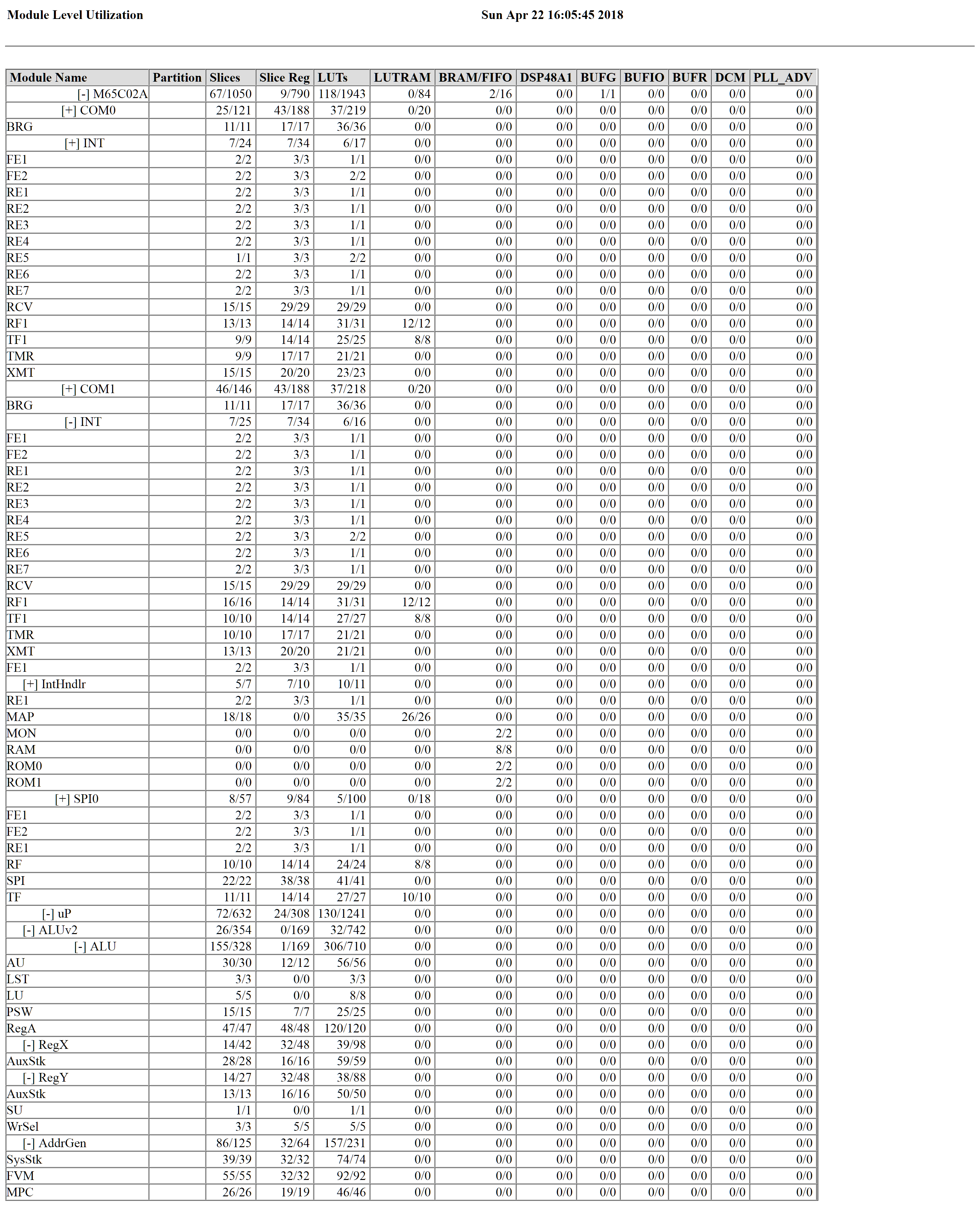

 Post subject: Re: M65C02A Core
PostPosted: Sun Apr 22, 2018 8:11 pm
Posts: 760
Location: Huntsville, AL
Thank you for your compliments.
Per your request, a screen capture of the Module Level Utilization Report is included below. That is followed by the PAR report for the M65C02A targeting a Spartan 6.
The core is undergoing some changes, and at the moment, I can't vouch for its correctness. The project synthesized includes: 28kB Block RAM memory, 4kB Block RAM microcode memory, Vectored Interrupt Controller, User/Kernel Paged Memory Management Unit, Buffered SPI Master, two Buffered 16C550+ UARTs, and a placeholder External Memory Interface. Thus, the core is complete, but not yet fully tested. Some questions remain regarding whether the approach taken to implement the base-relative and stack-relative addressing modes using the native indexed by X addressing modes will suffice. A prior implementation allocated a significant number of opcodes to these addressing modes at the expense of the Rockwell instructions and general compatibility with the W65C02S. As currently implemented, the M65C02A implements the instruction set of the 65C02, and leaves out the WAI and STP instructions from the W65C02S. Those two instructions are replaced by two instructions, OSZ (Override X with S, plus Set operation/operand size) and OIS (Override X with S, plus Set operation/operand size, plus Add indirection to addressing mode). The microcode for the WAI/STP is included in the microprogram, and all that is required to put the instruction set of the M65C02A into compatibility with the W65C02S is a simple update of the microprogram files.
I am currently creating a model of the core in Python 3 for use with Mike Naberenzy's Py65 toolset. Since Python is not my native language, it's taking a bit of effort on my part, and it's not going to be particularly Pythonic. Once thing is clear, though, and that is that a significant amount of effort will be required for testing.

Device Utilization Summary:
Slice Logic Utilization:
  Number of Slice Registers:                   790 out of  54,576    1%
    Number used as Flip Flops:                 790
    Number used as Latches:                      0
    Number used as Latch-thrus:                  0
    Number used as AND/OR logics:                0
  Number of Slice LUTs:                      1,946 out of  27,288    7%
    Number used as logic:                    1,853 out of  27,288    6%
      Number using O6 output only:           1,664
      Number using O5 output only:               3
      Number using O5 and O6:                  186
      Number used as ROM:                        0
    Number used as Memory:                      87 out of   6,408    1%
      Number used as Dual Port RAM:             84
        Number using O6 output only:            60
        Number using O5 output only:             0
        Number using O5 and O6:                 24
      Number used as Single Port RAM:            3
        Number using O6 output only:             3
        Number using O5 and O6:                  0
      Number used as Shift Register:             0
    Number used exclusively as route-thrus:      6
      Number with same-slice register load:      4
      Number with same-slice carry load:         2
      Number with other load:                    0
Slice Logic Distribution:
  Number of occupied Slices:                   510 out of   6,822    7%
  Number of MUXCYs used:                       140 out of  13,644    1%
  Number of LUT Flip Flop pairs used:        1,959
    Number with an unused Flip Flop:         1,219 out of   1,959   62%
    Number with an unused LUT:                  13 out of   1,959    1%
    Number of fully used LUT-FF pairs:         727 out of   1,959   37%
    Number of slice register sites lost
      to control set restrictions:               0 out of  54,576    0%
  A LUT Flip Flop pair for this architecture represents one LUT paired with
  one Flip Flop within a slice.  A control set is a unique combination of
  clock, reset, set, and enable signals for a registered element.
  The Slice Logic Distribution report is not meaningful if the design is
  over-mapped for a non-slice resource or if Placement fails.
IO Utilization:
  Number of bonded IOBs:                        59 out of     316   18%
Specific Feature Utilization:
  Number of RAMB16BWERs:                        16 out of     116   13%
  Number of RAMB8BWERs:                          0 out of     232    0%
