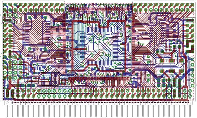

Back in 2008, I had toyed a little bit with Altera EP3C16:
Ignore that chip below the FPGA at the bottom of the PCB, it's only a PIC microcontroller.
A PCB with voltage regulators was plugged on top,
and another PCB with quite a few 74LVC245s (3.3V to 5V logic level converters)
was plugged at the bottom.
What kept me away from FPGAs where the somewhat impractical IC packages...
and the IDEs.
In fact, I haven't paid too much attention to the FPGA section of the forum, sorry.
Thanks for mentioning, that Arlet already did "small optimizations to the ALU flag handling". :)
