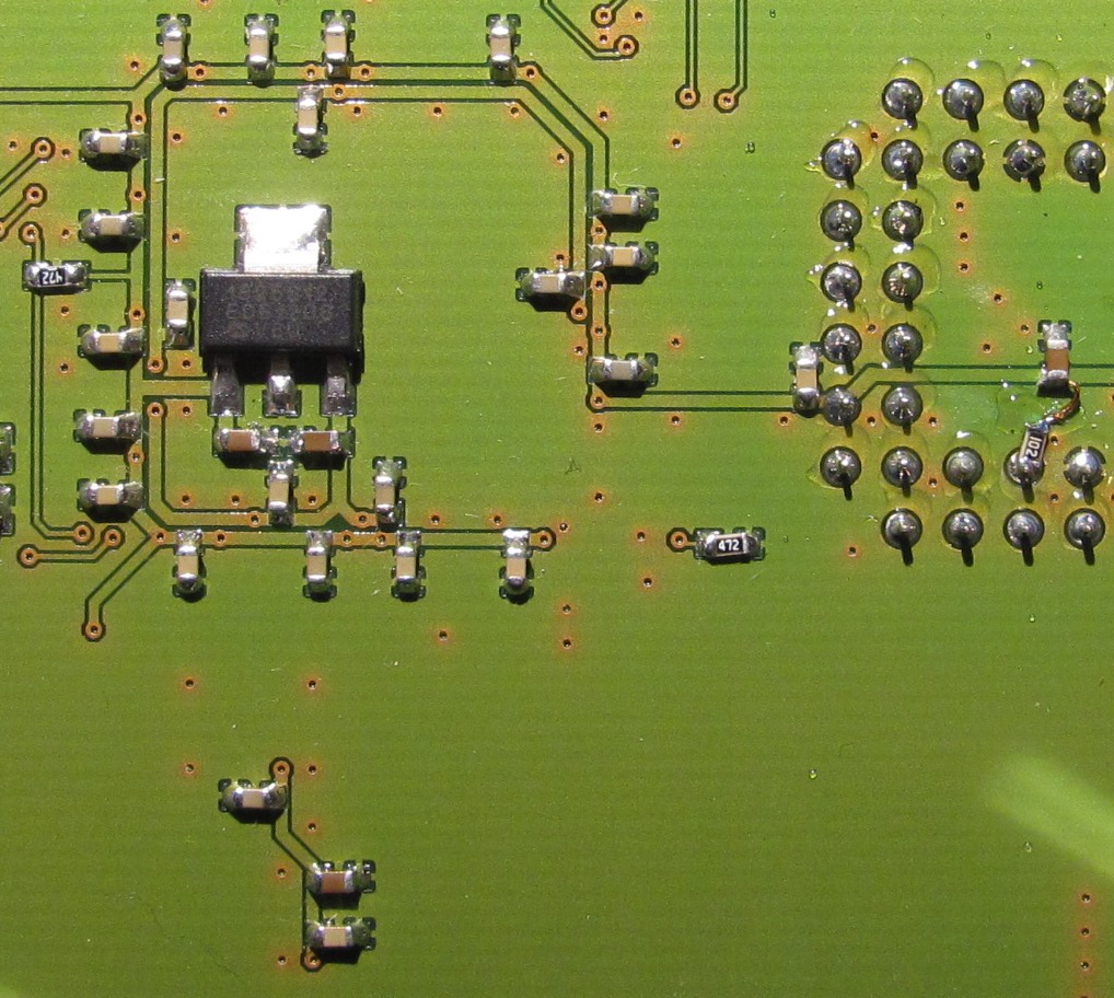

And here's a picture of the bottom of the board, with the 1.2V regulator, and the bypass caps. Light brown = 0.1 uF, dark brown = 10 uF. The 3 caps at the bottom are under the SRAM.

Interesting, only 3 bypass caps for your asynchronous SRAM.
There are 12 separate VDD-VSS pairs in the Synchronous RAM I'm using, which should tell any designer the stress the engineers put in the importance of bypassing this device. Which, knowing this, I still try to get away with as much as I can due to the confidence I have with my power distribution!
EDIT: In my design I put provisions for 2 bypass caps on each VDD-VSS pair "just in case", especially since there was room for this in the layout. I've noticed in designs by DigilenInc that they have some caps in parallel, so it can't be just a simple addition of capacitor values? or can it?

PostPosted: Wed Mar 06, 2013 10:19 pm
My RAM only has 2 VDD-VSS pairs, both in the middle of the device, on opposite sides, so I put a cap under each pair. I don't think there's a benefit to adding any more.
No, the idea is that you use 2 caps of different value, each offering a low impedance path to ground, but at different frequencies. Combined, the low impedance path has a wider frequency range.

I've always wondered about this, just to clarify...
So the multiple bypass caps of different values in parallel are like multiple notch filters bypassing at their different frequencies? and it is not a simple addition of capacitance?
PostPosted: Wed Mar 06, 2013 11:02 pm
Posts: 8544
That's more-or-less right, because each one is like a capacitor and inductor (and a little resistance) in series.

And of course, the inductance is also dependant on the board layout. For instance, I have my caps at the bottom, which adds a extra little inductance from the via. And TQFP packaging also adds more inductance than BGA (probably more than the vias).

ElEctric_EyE wrote:
Aiming in the dark here, but for the 2 bypass values that will be in parallel on each SyncRAM VDD-VSS pair of power pins, I think .1uF in parallel with .001uF should be most effective for close to 100MHz operation?
Doing a little more looking in Dr. Howard Johnson's articles, I find in https://web.archive.org/web/20120302190 ... s/1_17.htm: "I discourage engineers from combining together different-valued capacitors if they share the same package format (for example, 0.1 uF and 0.001 uF, both in 1206-SMT packages). Since the lead inductances are the same, you aren't really buying anything at the high-frequency end that you wouldn't have gotten with just two of the larger-valued components in parallel."
https://web.archive.org/web/20120302190 ... s/6_09.htm is a good one showing the best ways to connect the bypass capacitors in board lay-out. He made 100x size models to be able to measure inductance more easily, and shows the results. The best results came from the capacitors in the smallest packages, and putting the vias against the sides of the land pattern (not at the ends), and with no trace length between them. If you're soldering by hand, you can usually put vias in the capacitor's pads on the board further reducing inductance; but don't do that for automated assembly because the solderpaste will squirt through the hole and make a mess. I haven't tried it but that's more or less what I've read. Also, it's best to have the power and ground planes close to the surface you're putting the components on.
https://web.archive.org/web/20120302190 ... ws/1_6.htm addresses getting the bypass capacitors as close to the IC's power and ground leads as possible.
https://web.archive.org/web/20120302190 ... ws/2_3.htm, he recommends using the smallest practical capacitor package size to hold the inductance down, then getting the largest capacitance you can in that size and with an adequate voltage rating.
https://web.archive.org/web/20120302190 ... s/9_07.htm has more on how to connect bypass capacitors.
So my earlier advice was not totally the best.
PostPosted: Fri Mar 08, 2013 7:28 am
If you put the vias in the pads, or really close, they'll wick the solder paste during automated assembly. It won't make a mess, but it'll make for a very dry joint, as most of the solder will end up in the hole. Also, 2 lead components, like small caps may get pulled towards the other pad to the point where they tombstone, or don't make any contact at all.
For practical purposes, I mostly use 0603, and then I pick 0.1 uF, 50V, X7R types for bypassing. These are quite cheap (about $15 for a reel of 4000). While 0402 may be better, their small size makes them a bit more impractical for hand assembly. It's easy to get bigger capacitance in 0603, but with the higher prices, it doesn't make it attractive to sprinkle a board with those. So, that's why I settle on 0.1 uF as a good compromise, and add a few 10uF/10V here and there.
