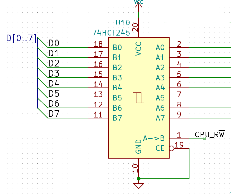

We got logic probes, we got oscilloscopes, we got coffee. What we (I) need is time and patience. I was really hoping for the CPU pinout to be the only problem.
Fortunately, we are already a little bit further as we discovered the /OE signal is somehow off. Which is the reason the CPU is reading garbage from the EEPROM.
/OE is generated by the CPLD, so at least this shoud be fixable without making a new board..
In what way is /OE “off?” Is this a timing issue?
We haven't quite pinpointed what exactly is wrong, and if /OE is the only problem (since that was my first attempt at anything in VHDL, anything could be wrong). For the time being, "timing problem" is what we are suspecting. Also, maybe a 7ns XC9572 is just too much faster than the 74HCTxxx and GAL stuff we used before.

To wrap this up - we found the culprit. As a first, we listened to advice and added 74HCT245 buffers between the CPU Board components and the rest of the system...
And that's where I screwed up. The experienced viewer will notice that I tied the /CE pin for the data bus buffer to ground, having it drive the bus when r/w is high.
That's what you get for skipping the breadboarding part.
