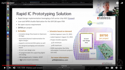

As noted previously, there's an initiative to make chips using a fully open source chip design flow, which is presently accepting submissions of open-source chip designs for free fabrication later this year.
As last year, as I understand it, they are accepting up to about 40 designs (to be selected by them if over-subscribed) and will return 50 packaged chips. I think the package is a 100 pin mini-BGA, and there are 37 I/Os available. The process is 130nm, and the I/Os are 5v tolerant. The allocation for the design is 10mm2, which is apparently up to a million gates - a great deal more than the FPGAs we deal with, although they come with onchip RAM too, so with that it might come out even. Who knows.
One interesting piece of news in this video update is that the same process is being offered commercially: 100 chips for $10k.
TBH, I think it's quite a stretch beyond an FPGA design: and having a design work on FPGA would be a pre-requisite, in practice, because for $10k you certainly want to have tested out your design. But, it's not entirely out of reach, and anyone who's got an FPGA design up and running is probably able to learn how to work their way through a chip flow.

I think the package is a 100 pin mini-BGA, and there are 37 I/Os available. The process is 130nm, and the I/Os are 5v tolerant. The allocation for the design is 10mm2...
One interesting piece of news ... the same process is being offered commercially: 100 chips for $10k.
Quick update (Edit: new location here) on the commercial offering:
  • $10k gets you either 100 QFN or 300 WCSP packaged parts
    $20k gets you 1000 WCSP parts
So that's $20 each, for a custom chip in a tiny package with nearly 40 I/Os (5V tolerant). A pretty good deal, except for the volume: not so many retrocomputing project can hope for quantity of 1000.
One interesting possibility is to design multi-purpose chips which share I/Os between macro functions, at the cost of a few I/Os to determine which role each chip should play.
