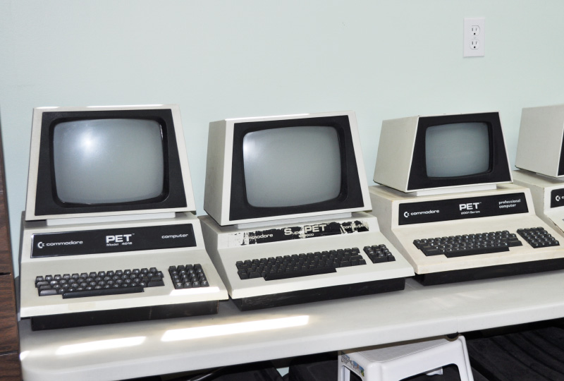

Greets 6502 Freaks, it's been a while!
I have been picking away on my Vulcan-74 project here and there, but the farm and my 2 day jobs has taken all of my time this summer so far. Winter is always the best time to hide in my lab and have fun, and I am looking forward to posting the progress on my project then.
So, I am out in the Northern Ontario wilderness installing a computerized time lapse system on a 250 foot tower, and after the job I start up a chat with someone there. Well, wadda know, they actually knew of my Vulcan-74 project from postings here and we talked for some time. At the end of the conversation, I was asked...
"Hey, I have a bunch of old Commodore computers in a basement at my camp down the road, you want 'em"?
Well, I followed the usual protocol when asked such a thing, which is...
Say yes, shut up, then open the car doors to load up!
I was amazed to see there were 5 PETs in the collection I was loading, and some of them looked different than the one I already had. Four of them were in nice shape and actually turned on, displaying the usual basic prompt! Here they are...
The 4016 is in amazing shape, all keys working, no monitor burn at all, even the main board is clean.

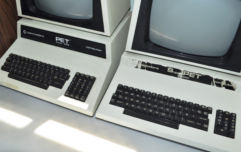

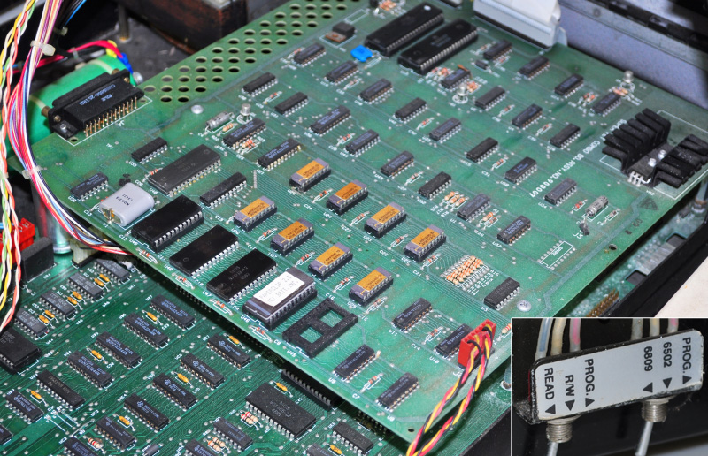

The interesting one is the one labelled SuperPET SP-9000. Have not seen one of those before!
Even the keyboard is different, more like a C64 or VIC than a PET.
Inside the SuperPET is an addon board that has extra RAM and some various built in Apps.
There is even a switch on the side to change the BOOT ROM and run different Apps...
Notice the differences in the keyboard from the standard 4016 and the SuperPET...
The other PETS seem mote common, 4016, 4032, and a pair of 2001 series.
So I am curious as to how rare the SuperPET may be?
I found a few photos of it online, but ir appears to have been a limited production system.
When I have more time, I will do a full restore with tons of photos on my Blog...

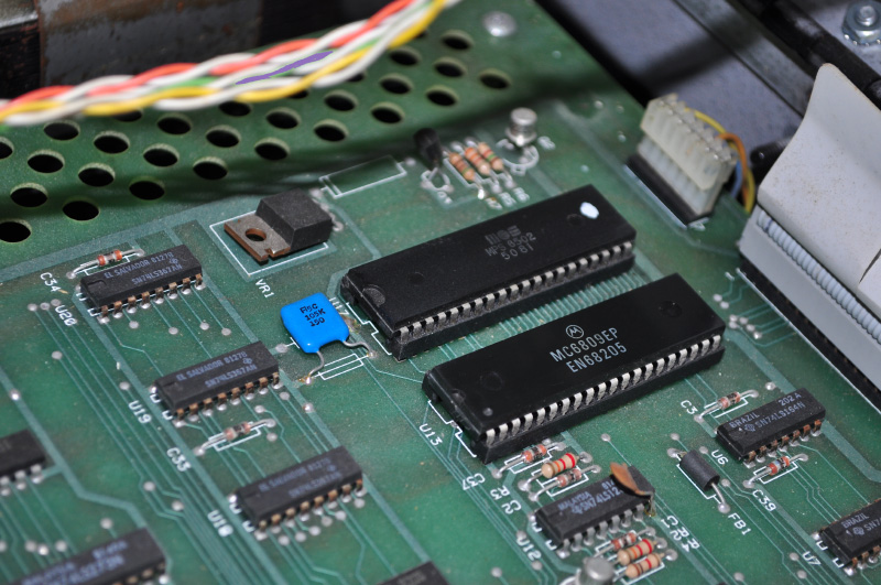

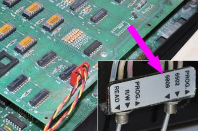

Congrats! -- what a lucky find! (Having said that, I don't really wish to encounter such luck myself. I have enough lucky finds in storage already! :roll: :oops: )
More than a little intriguing. I wonder what the add-on board could be... and, do they really mean 6809 ?!!

Congrats! -- what a lucky find! (Having said that, I hope I don't encounter such luck myself. I have enough lucky finds in storage already! :roll: :oops: )
Yes.

Interesting, I never even read the switch labels!
Back soon, going to lift the cover and have a look.
PostPosted: Sat Aug 01, 2020 1:11 am
Posts: 632
Thanks for all the info!
Indeed there is a 6809 in there...
Brad

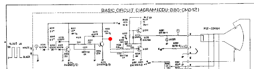

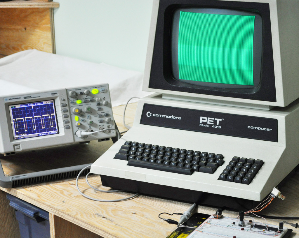

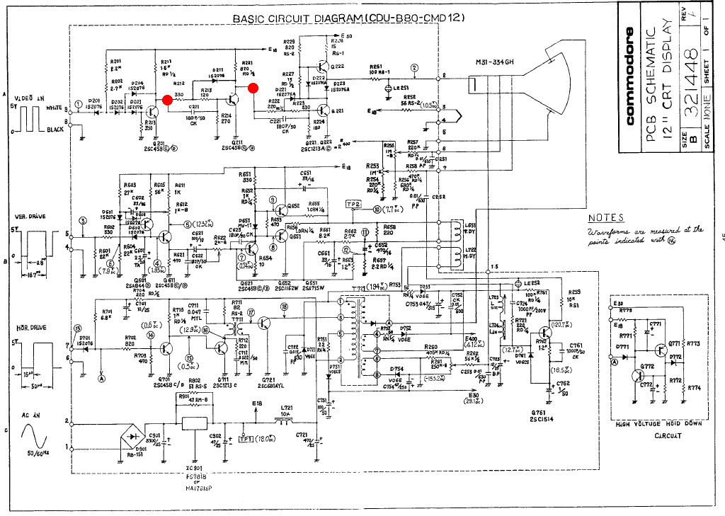

I had an hour tonight in the Commodore Cave, and managed to verify that the Video Input to the PET Monitor is indeed digital only.
I churned out some simple AVR assembly to generate a valid video frame for the PET Monitor, using the following timing...
// HORIZONTAL SYNC : 20 KHZ NEG
// VERTICAL SYNC : 60 HZ NEG
// PIXEL CLOCK = 20 MHZ
// TOTAL LINE = 1000 CLK
// ACTIVE LINE = 720 CLK
// HSYNC TIME = 290 CLK
// VSYNC TIME = 40 LINES
The monitor locked right on to the signal, so I guess the data in the Excel sheet was bang on!
I soon realized that the raster would only draw if the voltage was above 2.5 volts, so it is completely digital.
In the photo above, I am feeding a 5MHz signal to the Video Input, which is why it generates vertical bars.
Not all is lost though, I am now looking at the schematic and should be able to tap the Video Input past the integrator, allowing me to feed an analog voltage in there to generate shades of green.
No Commodore ever gets mods in my cave, so I will only solder a wire to the board and not remove anything. I think this will work.
The end goal is a fun add on card that just fits between the monitor connector on the main board and CRT to allow the PET to draw up some 720x400 8 bit graphics! That's 256 shades of green at a resolution of 720x400, so it will be quite impressive considering a stock PET.
The graphics will be delivered by a simplified version of my Vulcan-74 Video Engine, just made of some SRAM and basic logic parts. All of the original PET Video generated by the 6545 Video IC will also be displayed, so 100% compatibility will also be maintained. The new Video will just be a combination of the original and the enhanced.
As for the point of entry, I have targeted two possible places on the Monitor board as shown...
Not sure if my Monitor board is the same, but I assume the electronics will be similar. Another possibility is just to have the add-on board drive full green digital during the active frame, and have the "luma" delivered to the point on the board that controls brightness. This would also work.
Should be a fun and simple project for rainy summer days since I won't have any real hackin' time until winter again.
Why????
Cuz I can!
Radical Brad.
PostPosted: Sun Aug 02, 2020 2:22 pm
Posts: 632
Just did one more test before my morning day routine, and.... success!
Tapping this point here allowed my to feed the output of an 8 bit R2R DAC to the monitor and get 256 shades of grey (green)...
Now I can drive the video gun directly without the integrator converting it into a digital signal.
It's not really a "mod" as I consider it, so not against my rules of not modifying any Commodore equipment in my cave!
Just needed to solder a wire at that point, which is easily visible by looking at the Monitor ma inboard when the lid is open.
I will start a new thread later, now that I know my evil plan to give the PET 256 shades of 720x240 video shall work.
This is going to be the first example of a PET displaying analog video ever.
All of the GFX boards I researched only upped the resolution, but never put out shades, which is where the real ability to display GFX is at.
