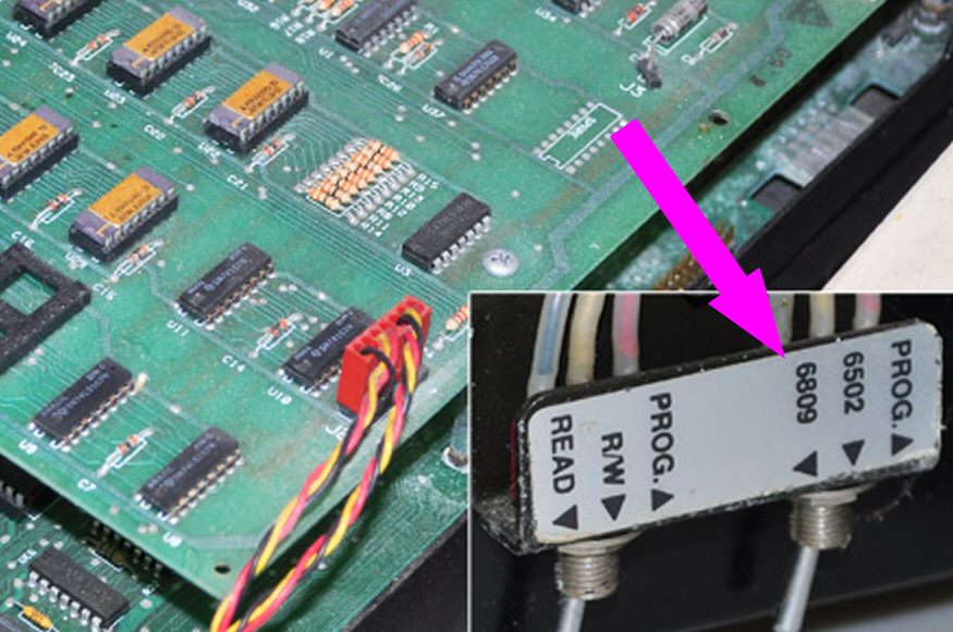

Congrats! -- what a lucky find! (Having said that, I don't really wish to encounter such luck myself. I have enough lucky finds in storage already! :roll: :oops: )
Oneironaut wrote:
Inside the SuperPET is an addon board that has extra RAM and some various built in Apps.
There is even a switch on the side to change the BOOT ROM and run different Apps...
More than a little intriguing. I wonder what the add-on board could be... and, do they really mean 6809 ?!!
Yes.
https://en.wikipedia.org/wiki/Commodore ... 000_series

Greets Doc!
Interesting, I never even read the switch labels!
Back soon, going to lift the cover and have a look.

Thanks for all the info!
Indeed there is a 6809 in there...
