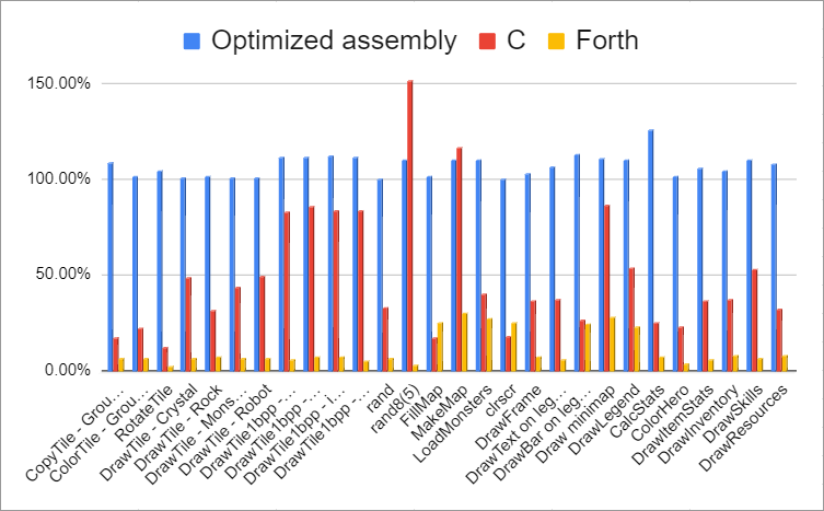

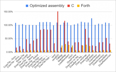

All four versions of the game are done. Here's a summary I did comparing the performance of each language with links to the games so you can play in your browser: Robot Game summary. C was 20-80% as fast as traditional assembly, Forth was 5-25% as fast, and the optimizer project I posted about here was up to 10% faster. Here's a graph of 28 different tasks the game does internally. Traditional/unoptimized assembly is normalized at 100%. Anything above that is faster and anything below is slower, ie a rating of 20% means five times slower than normal assembly.

It is interesting why is C the fastest with rand8? IMHO you can check C compiler generated assembly and improve it a bit.

In all cases, it will depend on how good the compiler and/or kernel is. The common Forths for the '02 are nowhere near optimized.

I looked at that in the last paragraph of the Results section on the page. The way I implemented modulo in assembly was lazy, which is why C was better for rand8.
How do you mean optimized? Tali Forth 2 does not optimize like a C compiler where it modifies the generated assembly to be more efficient, but I think it is pretty well optimized as a Forth from what I can tell.

I forgot you said it was Tali Forth (which I have not evaluated). The common Forths for the '02 (usually based on figForth) have a lot of things as secondaries that could be turned into primitives for much better performance.

For reference, all of TaliForth2's primitives are written in assembly. There are only a few that are done as JSRs to other words (Tali2 is an STC Forth).
I believe native compiling (where the opcodes for a simple word are compiled directly into another word) was disabled to conserve as much memory as possible (correct me if I'm wrong on that one, Druzyek), so all of the compiled code would end up as JSRs to the primitives or other defined words. I can see having JSR/RTS overhead for every word, along with stack juggling, slowing things like drawing stuff on the screen quite a bit vs. a C or ASM routine. Anything with loops is likely to be noticeably slower, and indeed almost all of the slowest routines have "Draw" in their name.
The native compiling would really have only helped with the JSR/RTS overhead, and it can't be used on words that have flow control (IF/ELSE/THEN/DO/LOOP/etc) as Tali2 doesn't know how to update the JMP addresses (or even which bytes might be addresses) as it just copies the bytes for one word into another.
I suspect the loop constructs Tali2 uses to be a lot of the slowness. The loop index is held on the return stack while the loop is running. Tali2 has to pop it into A/Y, add to it, and then push it back. LOOP is implemented as assembly that puts a 1 on the data stack and then falls right into +LOOP.

Did you see in the summary I posted a link to above that I thanked you for your help? Thanks again! I also mentioned that Tali Forth 2 is really great and the poor performance seems to be due to the nature of Forth.
I originally left "nc-limit" at the default of 20 then bumped it up to 26 once everything was working right. The results are from that version, so it should be doing a lot of native compiling.
That is a good point. I think a lot of the slowdown also comes from the stack-based nature of the language:
-You're constantly thrashing X, which doesn't happen in C and assembly, with stuff like "drop 5" where you have useless runs like DEX / DEX / INX / INX.
-Constraining everything to the top levels of the stack wastes a lot of cycles in stuff like "swap 1+ swap" which would be only one instruction in assembly since you can step over the topmost stack levels and work on any item.
-Automatically promoting 8-bit values to 16-bit to keep stack items the same size means you're always doing calculations the slowest way.
Another thing that slows everything down not specifically related to stacks is the lack of optimizations in most Forths. Something like "lshift" always generates the same machine code even in the case of "5 lshift" where the number of shifts is known at compile time and better assembly could be generated. C compilers can spot those situations and generate better assembly.
