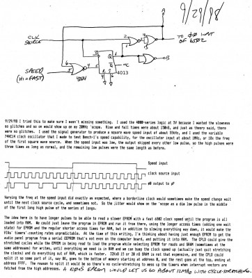

I would recommend against using the 555, as its output rise and fall time are much too slow (100ns!) to meet the 65C02's requirements (if you were using a current-production '02). I don't have a full do-everything circuit for you, but I would base it on at least 74HC, if not 74AC, Schmitt-trigger logic. My 6502 primer's clock-generation page shows a single-cycler clock-generation circuit about 3/4 of the way down the page, and there are links there to related forum topics. See especially viewtopic.php?p=10619#p10619 where I show a variable-frequency oscillator I use. In viewtopic.php?p=378#p378, I tell of a couple of programmable oscillators from Dallas Semiconductor. (That was 16 years ago, so I'm sure they have improved ones by now.)
For clock stretching without glitches, see this experiment I did 21 years ago. (Don't use 4000-series logic though. I only used it because it's really slow, and I wanted it slow enough that if there were any runt pulses, they would show up on my 20MHz analog 'scope.)

The single-pulse circuit I used is taken from your clock generation page (although I mentioned it was yours, I failed to include a link in the schematic :roll: ).
I also used your VFO circuit when building my own, so I can vouch for it. :)

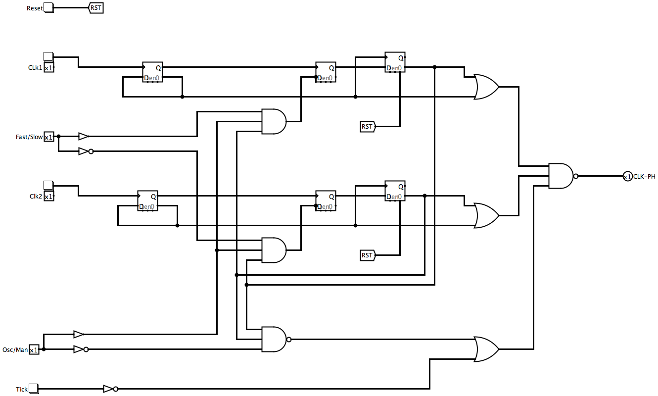

Yes, this helps. Ultimately I realised that what I really wanted is a clock switching circuit with two independent clock sources, so googling the right words I found this on the internet: https://www.eetimes.com/document.asp?doc_id=1202359.
I figured out that I could combine that with the ideas on your circuit, and I came up with this logisim simulation:
There are two clock input sources and a manual tick button:
- The fast clock source will be a crystal oscillator.
- I want the slow source to be variable along the few Hz range (maybe up to 10 Hz or so), so I think the 555 timer circuit described in the "digital computer electronics" book should do it.
The circuit seems to work fine on logisim although the clock exchange takes some time because it does not happen until both sources have completed its own cycle. That's not a major issue for me though. The circuit uses quite a number of ics but I assume it can't be simplified given the specs.
Joan

PostPosted: Mon Nov 25, 2019 3:03 pm
(Just possibly worth picking gates with Schmidt inputs, if the input is slow, and you really don't want glitches.)
PostPosted: Mon Nov 25, 2019 6:27 pm
Posts: 8546
joanlluch wrote:
Thanks for the tip. I only aim for very slow clock rates (in the range of just a few Hz) for the 555 based source. I think that if I connect the output of the 555 to a flip-flop I will get a perfect square wave with proper edges and half the frequency, no?. A Ben Eater video on youtube shows an even simpler approach that seems to work. He just directly connects the 555 output to a few logic gates he uses for switching purposes, and then uses the output of that gates to clock a 6502. Is there something inherently wrong with that?
As Ed says, a Schmitt-trigger input will go a long ways. I'm not sure it would totally eliminate the possibility of noise picked up from heavy ringing on another part of the circuit causing unwanted pulses between intended phase-2 edges though; and these pulses' speed may be too fast for the processor to handle, and cause a crash. We like Ben's enthusiasm; but he has a number of practices that could cause (and sometimes have caused) problems for others in their circuits. (There's one right now in the "6502 Homebrew Hardware and Programming" facebook group, where Ben's reset with only an RxC isn't working for the OP, even though it's on a PCB.) When this is the case, the "It works for me" argument may only prove that the failure rate is not 100%. That's not very useful information. Fortunately the actual performance of various ICs is better than the specs guarantee, but again, we can't depend on non-guaranteed behavior unless we do enough testing to get a good feel for how much margin we're leaving. In the case of a gate with a Schmitt-trigger input, the specs may guarantee a certain amount of hysteresis, but there will probably be a little more. How much? Are we operating so close to the edge that a change in temperature, or the moving of a couple of wires, will make it stop working?
So we have to find a balance between, on the one hand, overburdening the beginner with excessive and complicated implementation details, and on the other hand, ignoring those and letting him build something that takes months to debug and he finally gives up. The goal of course is to maximize the success rate.

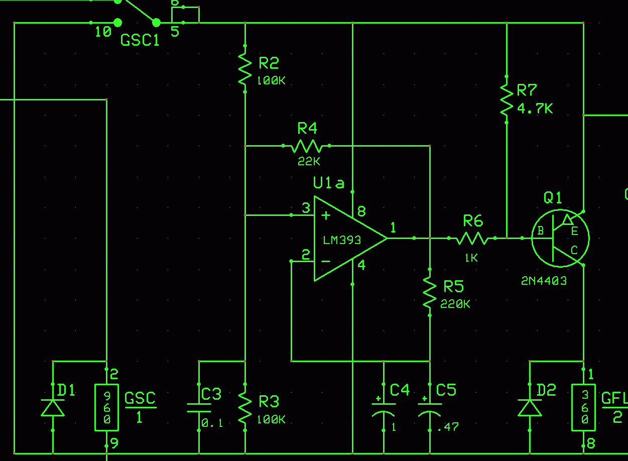

A problem with using a 555 timer, as previously mentioned, is the output transition time is much too slow for the 65C02. Also, you need to try for 50/50 symmetry, which is hard to attain from a relaxation oscillator.
Something I use in some of my designs that require a slow but stable symmetric "tick" is a comparator oscillator, such as the below illustration.
File comment: Comparator Oscillator Illustration
This particular application is a model railroad grade crossing signal flasher, with the comparator oscillator cycling the signal lights at the rate of 1 Hz. The circuit has near-perfect symmetry and is relatively insensitive to Vcc.
The circuit works because the input transition threshold of a comparator is extremely narrow, at most a few millivolts. Hence the oscillation frequency is a function of the R-C time constant of R5 and the C4/C5 combination. R5 is both charge and discharge path for the capacitors, which means symmetry is as good as that of the comparator "crossover" characteristics. The ratio between R4 and R5 is not critical, so you could use a pot in place of R5 to create a low-speed variable clock.
The comparator's output is an open collector, so it has to be pulled up to Vcc—anything from 1K to 4.7K is usually sufficient. Open collector outputs are somewhat on the slow side, relatively speaking, with a high-to-low transition typically around 1 µs. A Schmidt trigger, such as a 74AC14, should be used to condition the oscillator's output so as to satisfy the 65C02's Ø2 clock requirements.
