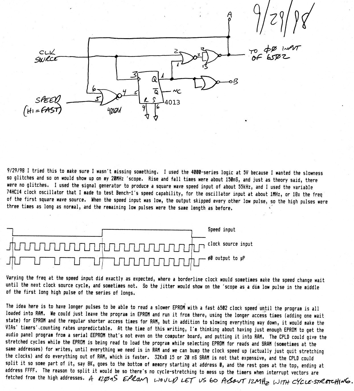

I see Drass posted while I was writing. I'll keep going anyway.
I would recommend against using the 555, as its output rise and fall time are much too slow (100ns!) to meet the 65C02's requirements (if you were using a current-production '02). I don't have a full do-everything circuit for you, but I would base it on at least 74HC, if not 74AC, Schmitt-trigger logic. My 6502 primer's clock-generation page shows a single-cycler clock-generation circuit about 3/4 of the way down the page, and there are links there to related forum topics. See especially viewtopic.php?p=10619#p10619 where I show a variable-frequency oscillator I use. In viewtopic.php?p=378#p378, I tell of a couple of programmable oscillators from Dallas Semiconductor. (That was 16 years ago, so I'm sure they have improved ones by now.)
For clock stretching without glitches, see this experiment I did 21 years ago. (Don't use 4000-series logic though. I only used it because it's really slow, and I wanted it slow enough that if there were any runt pulses, they would show up on my 20MHz analog 'scope.)
