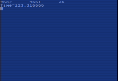

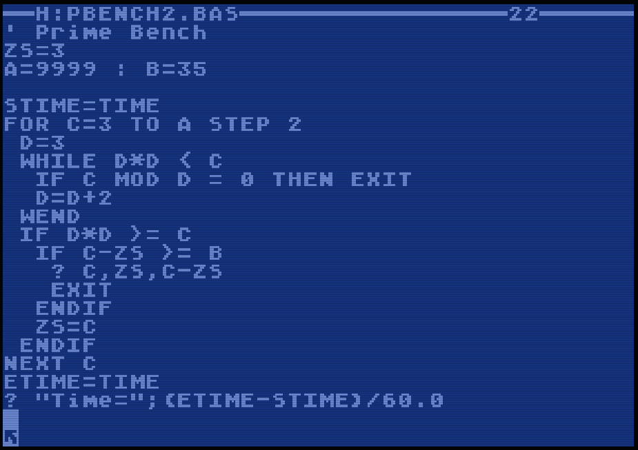

My results for FastBasic ( https://github.com/dmsc/fastbasic ) on NTSC Atari 800XL:
Atari 800XL (1.79MHz NTSC)   FastBasic_3.5      5.3     9.0      123.3    326.1    620.38
This is running the B=35 test:
File comment: Benchmark run with B=35

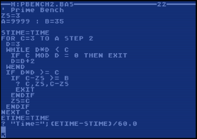

And this is the source code in the Atari IDE:
File comment: Benchmark source
