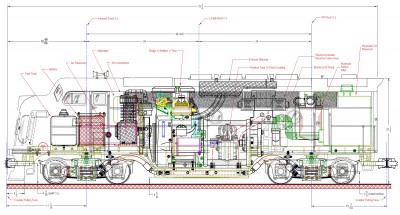

I have hundreds of photos that I took during the build process, but unlike the POC project, I haven't organized them into a website or anything. However, I'll upload a side view of the main drawing that I created as I was doing the design work so you can an idea as to what the finished unit will look like. The file is quite large, so please be patient as it downloads.

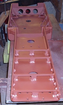

Here's a picture of the partially completed frame

Your welding looks like squirrel poop BDD...
But I am in awe at your overall proficiency.

Squirrel poop? The welds are fairly large because that whole frame is fabricated from quarter-inch hot-rolled steel. The picture doesn't help any. I'll see if I have other pictures that give a better view.

Well, considering.... If you are using flux core wire for your MIG welder this must be OK then. But I've had many years experience in exhaust work with MIG welders using Argon and Oxygen gas and the results are way superior.
EDIT: Let me correct that, been more than a few years since I did exhaust work, since all manufacturers switched to stainless steel and I had to leave that line of work. So my immediate memory was lacking in my previous comment... For welding, I believe we used Argon along with the MIG welders. For the cutting torches we used Oxygen and Acetylene. And this was work done on everyday vehicles on the road.
Re: TAKING A BREAK
How do you bend the steel to get that U shape chassis, it is 1-2cm thick after all. Or do you order it that way?
